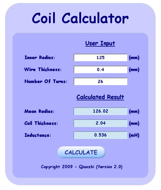

    Hello, I have a technical question: can I use a different wire diameter for coil construction? I think it's possible but I don't know if I must rewind a different number of turns or if it can work with same number of turns.
    I have bought enameled copper wire for another project (Mark Stuart EE treasure hunter) and it's a 0.71 mm one.
    If someone can give me such an information I will try out soon

      What must be matching? Inductance?
      Original:
      26 turns, 250 mm diameter, 0.4 mm wire: 1.215 mH
      I computed this:
      27 turns, 250 mm diameter, 0.71 mm wire: 1.178 mH
      28 turns, 250 mm diameter, 0.71 mm wire: 1.263 mH
      Is it correct?
        The wire diameter is not critical, use what you have and keep the same number of turns.
          Original:
          I computed this:
          Is it correct?
          Your calculations are incorrect. You have entered the diameter of the coil into the calculator instead of the radius.
            Thank you very much, I made a horrible mistake!
