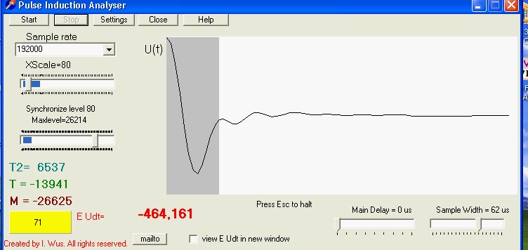

signal form at TP4
Using my own program for digital processing of pulse inductiom MD I get the following form of signal (seee as attachments) At this image is visible resonanz of coilAttached Files
