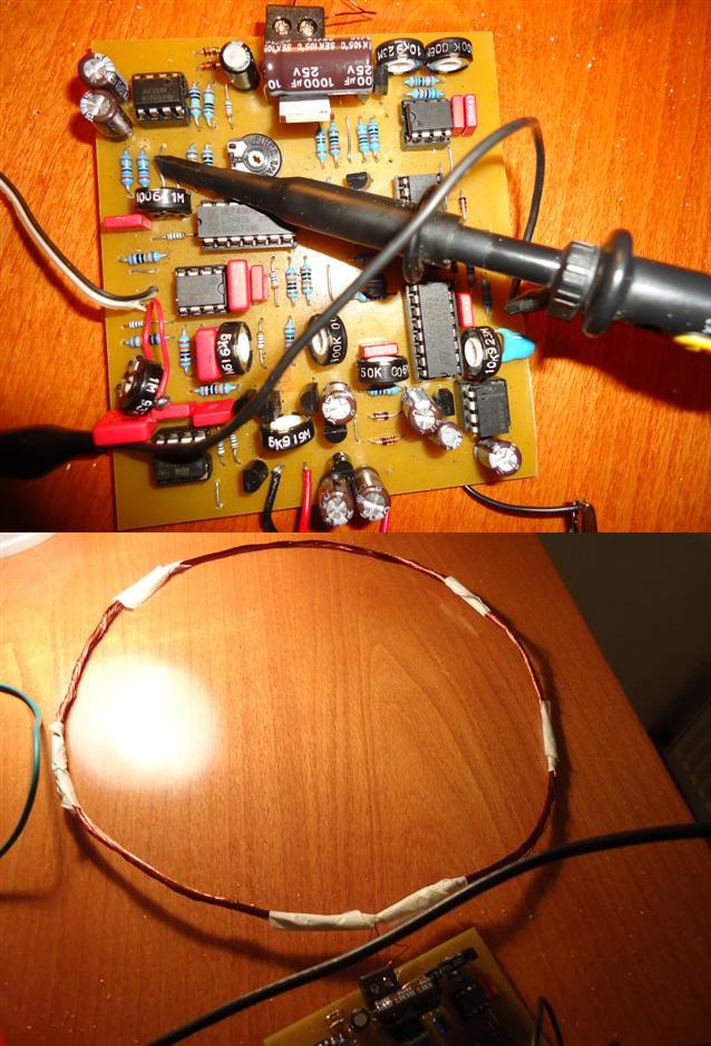

    Hello friends,
    My first HH1 is finished.

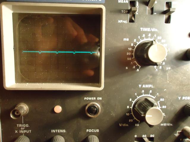

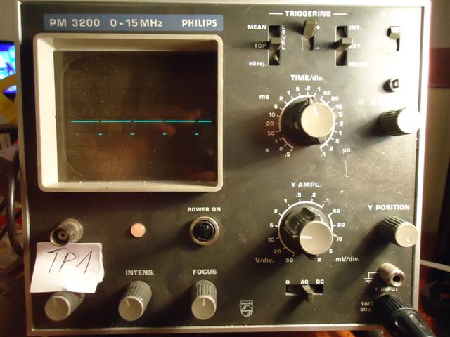

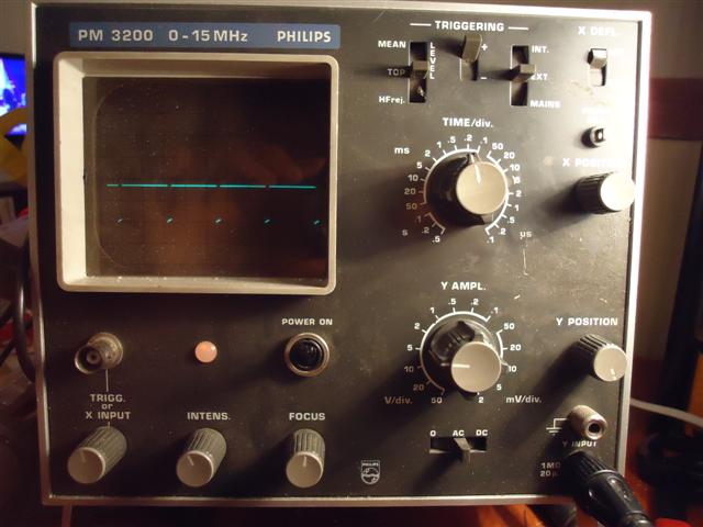

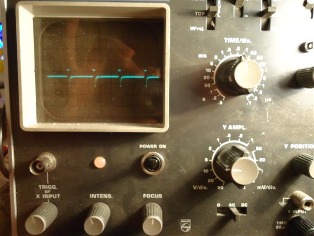

    I post some pictures.Also pictures from scope for TP1,TP2,TP3 and TP4
    Detector is detecting big things relative good, but coins are detected very poorly, ca 5-10 cm max.
    I think I have made a mistake somewhere, specially TP2 doesn't look like Carl's pic.
    If someone has any opinion about pics from the scope it would be very helpful for me.
    Thank you.
    Coil is 10 inch, 0.4 wire, 25 turns. Like in Carl's document. till now NOT shielded.

        What about picture of Fly back signal on TP2 . Is it with coil installed ? And without metal object near the coil ?

          R42 sets the main sampling delay. At mid position it is probably set to around 40us. This will mean that it can detect large targets ok, but will detect smaller or low conductivity targets poorly. Also, set R35 to mid position, as it says in the article.
