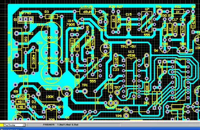

        Few issues with 4538 connection on mini PCB. Pins 8,1,15 are Vss, timing capacitor goes from pin 2 or 14 toVss, but on original PCB pins 1 and 15 are not explicitly connected to Vss (-5V in this case). Pins are internally connected inside chip itself (thru some very low resistance path), will work connected like this, but data sheet say pins 1,8,15 must be grounded externally, usually they are in most designs. Also timing capacitor marked C24 on PCB, from pin14 U12b is missing on schematic.
        Just another rainy day to finish this, I already retraced PCB in Protel from pictures, only for component placement, now checking connections.
          Progress so far, relatively similar to original, just small cosmetic changes.
            The MC14538BCP has pins 1, 8 and 15 connect to -5V.
            So this is correct.
            I also noticed this. The original PCB designer assumed pins 1, 8 and 15 are internally connected in the chip, which is true, but it is good practice to explicitly connect them to -5V.
            As above.
            Damn. It's on my hand-drawn schematic, but got missed off when I drew the schematic. Thanks for spotting that.
            If you find any other issues, please let me know.
            I've updated the schematic with the missing cap, and added the improvements mentioned in a previous post.
              Please see the final schematic for this design (with all errors corrected) in the sticky post at the top of this section ->
