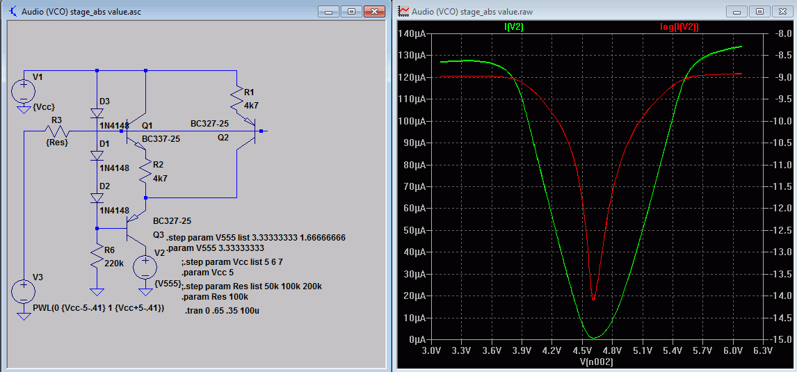

                  I feel awful, but here it goes...
                  It could perhaps undergo a tweak or two. Say, at this point the depth of a notch is tweaked by R6. What you get is shown in a result window ... current that is supplied to a timing capacitor of NE555 is shown in green, and fun part is that it is actually current value for both voltage extremes and it is the same
                  Trace in red is a logarithm of that same current and it spreads over ~5 decades.
                  It is nearly symmetric and should work fine for the intended use.
                  With reference to Mpp Rev B, V3 stands for output of U9, and except for the V- connection (ground in my schematic ... sorry) replaces R35, R36, and Q6.
