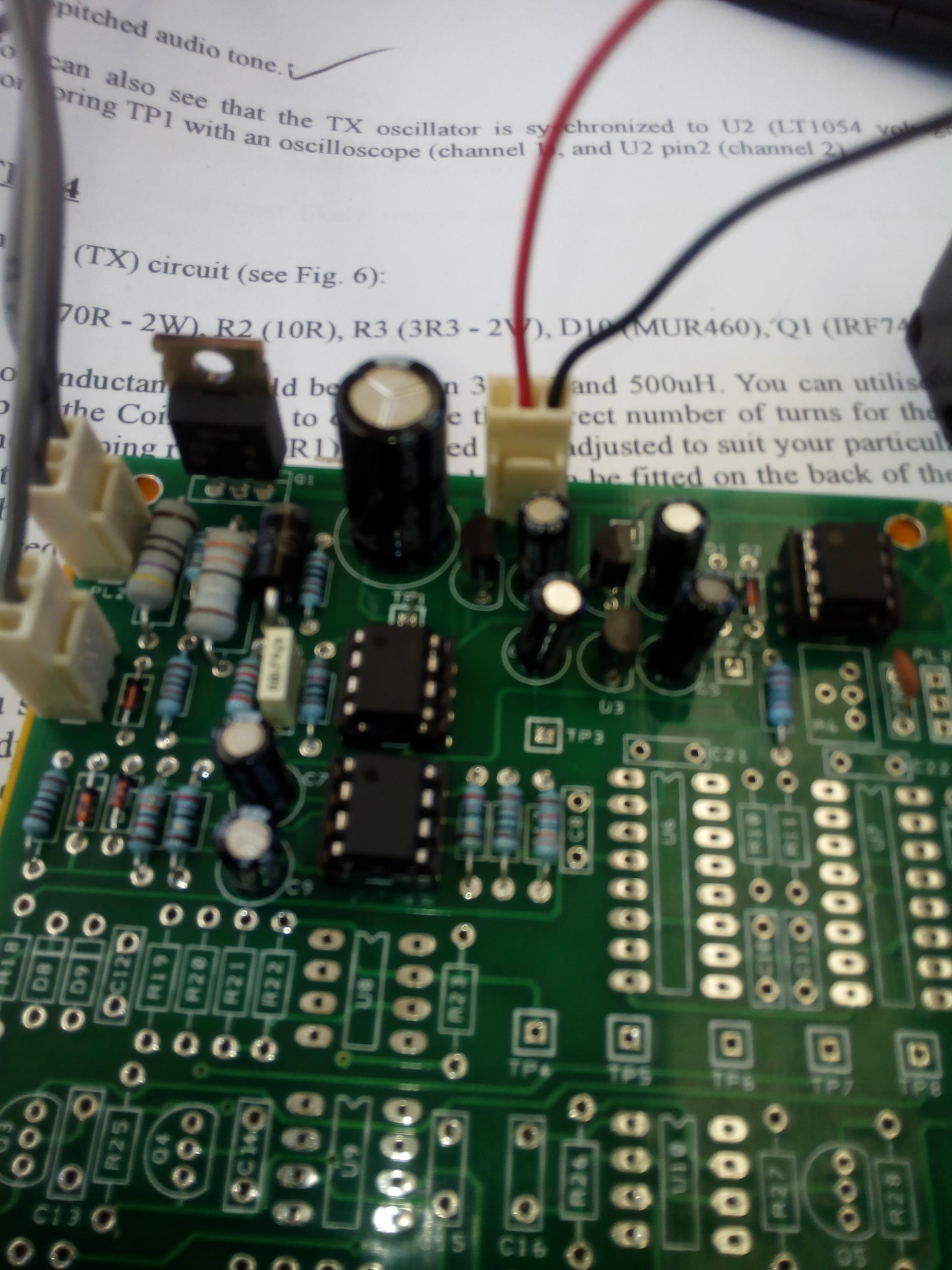

I have started building mini pulse. Every thing worked fine till I got to step 6. I measured the voltages again and minus is still at 5v but the positive is a lot lower. Any ideas please.

Have you checked all the pulses at the test points as per the instructions with an oscilloscope? Go back through each step doing the measurements and see where things arent as they are supposed to be.

I would suggest the following course of action:Originally posted by bigted View PostYes followed instructions as per document. I don't have a scope, using a multimeter. I'm up to the bit with the can and the coin testing tp3, but it seems my coil doesn't work now.
1. Recheck the _5V and -5V supplies are ok. If not, then fix as appropriate.
2. Connect a speaker between TP1 and TP10, and listen for a high-pitched tone (~1kHz). If there is no tone, then the TX oscillator is kaput.
