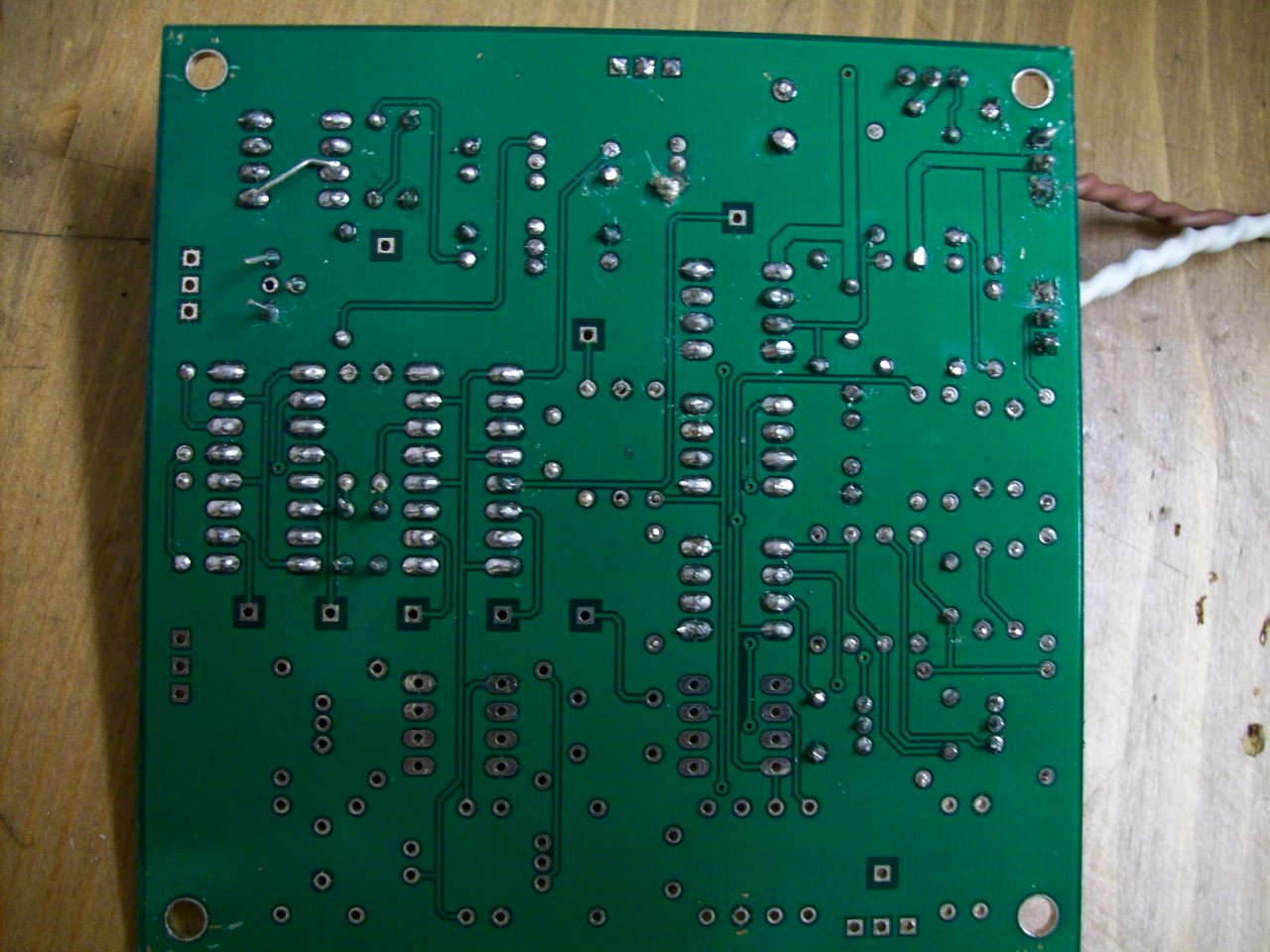

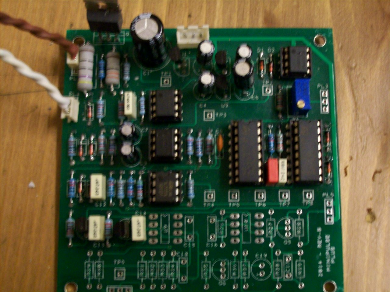

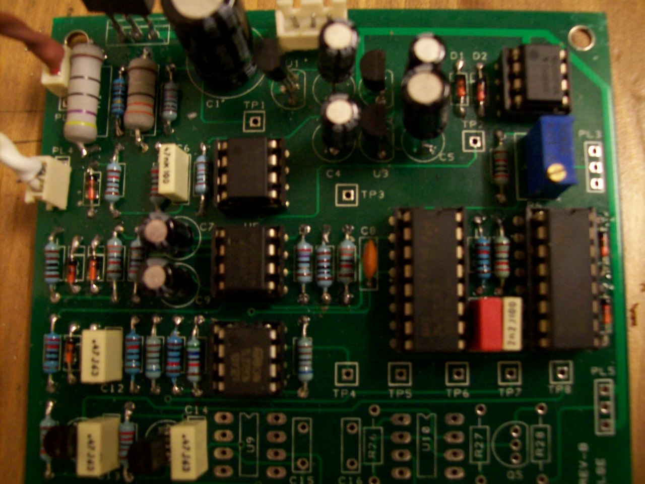

    i have followed the build plan block by block, the board has passed each stage up to and including step5, but after building 6 and 7, i see no change in voltage when a can is placed near the coil, it is static at 600mv.
    so i thought i would see if i cocked up something, here is my board maybe i missed something, Click image for larger version

    it maybe simple, i may have to go back to the start, i built this without my scope for two reasons, one to test the build plan and two my scope is at the caravan and unavailable till easter weekend.
    so while i have my test gear, i dont have a scope(for now).

    Did you short pin2 of PL3 to either pin 1 or pin 3? It appears to be open-circuit according to your photos.
    You need to temporarily do this when making the tests, since the Reject pot is not connected at this time.
      DOH!, thanks george i will try that.
