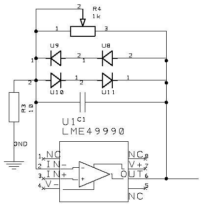

      This was just using an old NE5532, the first stage has a couple of 1n4148's added in parallel between pin's 1 and 2. The diodes speed up the decay time by about 1us with this circuit.
          Connected between output and inverting input? I had them in a couple of test preamps I was working on using a LME49990. Didnt seem to make a huge difference on the output of the preamp.

            Yeah between negative and the output pin. I have a feeling any improvement will only be seen in lower speed op-amps like the NE5532 or NE5534. The LME49990 is a high speed device, so the difference between diodes or no diodes wont be much.
            A LME49990 would be a waste of time in any PI that uses a 1k resistor and protection diodes in the frontend. The noise from a 1k resistor will be higher than the noise level of the LME49990.

              The mod, which you mentioned, comprises two diodes in total, or four, as the outline of "Cas" ..

                Hi Jose, I was just using two diodes. When looking at the output of the first opamp, the two diodes limit the output to +/- 1v max, whereas four diodes increases the limit to +/- 2v max. The decay is the same for either two or four diodes.
