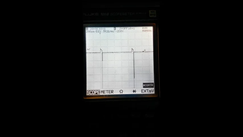

          A new question on step 4.
          I built step 4 without access to the scope but the earphone test went well so I went ahead and finished step 5. Voltage on TP3 drops from 0.116 to -0.7 when I put a Coke-can in the coil…
          Now I had access to the scope again so I measured the flyback across the coil to verify that everything was OK with the step 4, sadly I think it weren’t. I have huge fluctuations in the signal as shown in the attached video..
          What might be the cause for this?
          Bad scope/Probe (the only probe left is pretty well used)
          Totally wrong damping resistor? I´m using the supplied 470 ohm resistor.
          Bad component, I´ve checked all the components on the PCB and they seem to be the right ones
          Or am I just lacking the skills needed to use a scope in the right way..
          I’ve built a coil as described in the “Chance PI coil” thread, measured inductance of 296uH and 1.9 ohm
            That's most likely an artifact of your scope. It looks like it cannot sample fast enough to capture the fast flyback.
            What scope are you using?
              It´s a Fluke 105B Scopemeter 100MHz
              I dont know any specs on the X10 probe but I´ve bought a new 200MHz X10 probe that should arrive any day.
              I´ll paus the project until I can test with a new probe, or maby another scope if I can find one.
                You'll probably find that changing the timebase on the scope, to show only one flyback pulse, will stabilise the display. However, the flyback pulse is very fast, so it may not be able to sample the waveform peak, and the maximum voltage will appear to be lower than it actually is.
