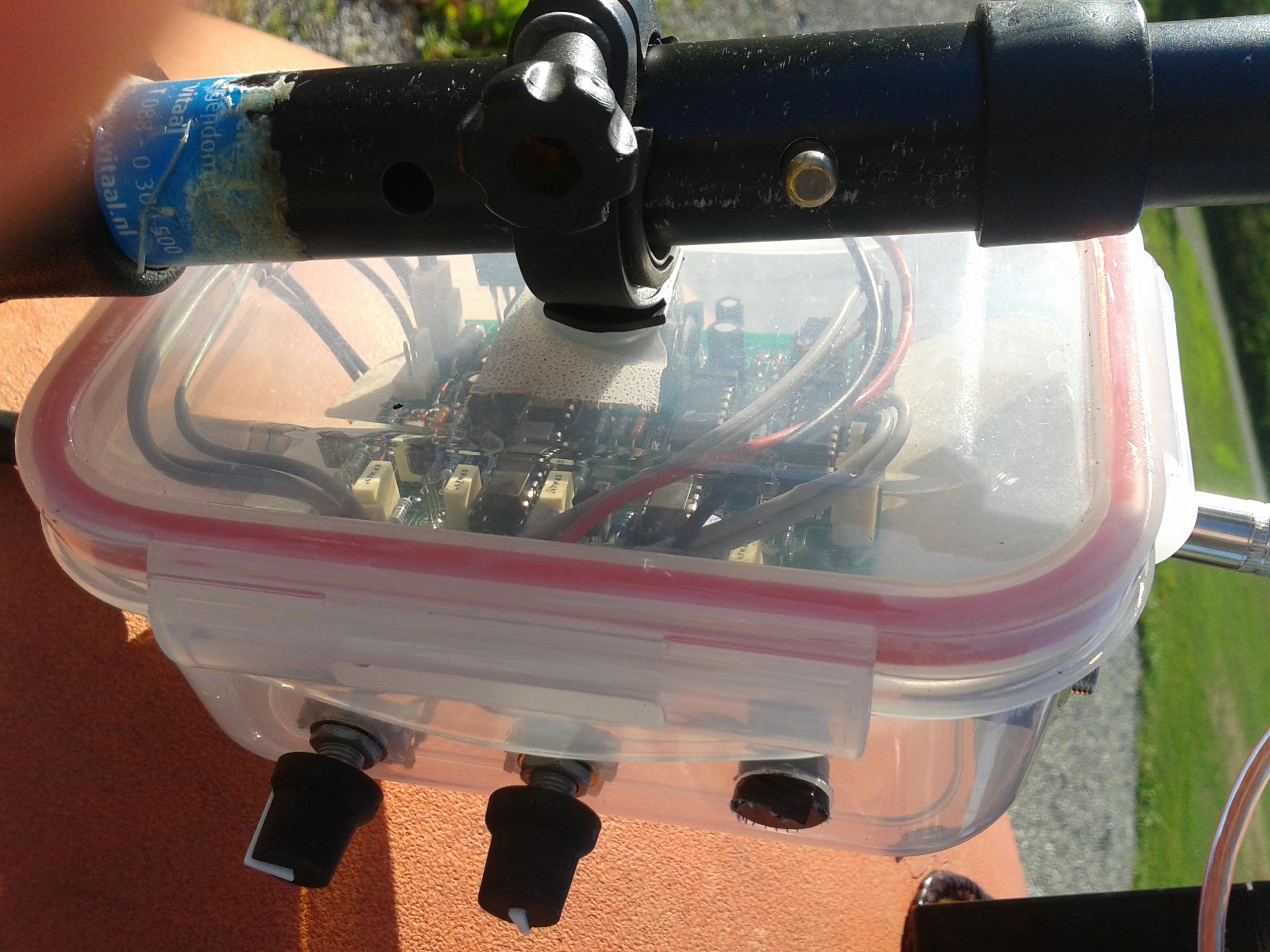

    As my battery pack connection i choised a 6,5mm Jack. Oh! That was a problem!
    Wery quickly i realised, and i put a switch betwen the battery and the connection point.

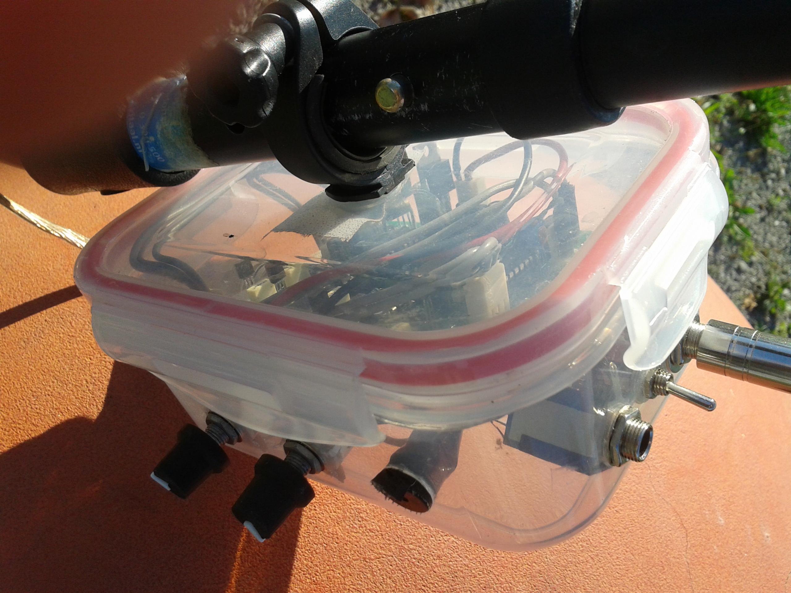

    But, Something went wrong.

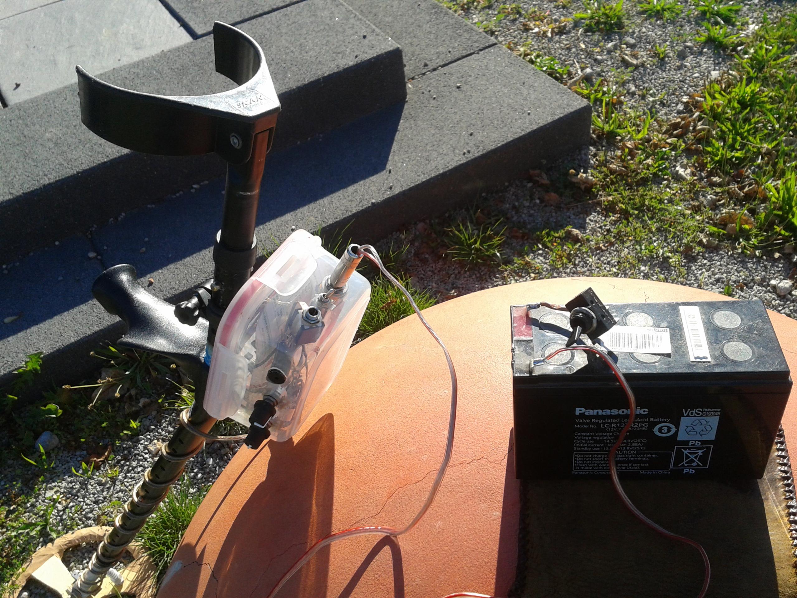

    IF I connect my battery again to the board, there is a voltage drop, and i get only about 0,7V in the power suply line. (Without boad connection is about 13,8V)(acid-lead-full charged-aku)
    Well, i quickly checked all components and there is Not any owerheating.
    I mesured that down, and the current comsumption is about nothing.
    Any idea?

          Hi to All,
          after many try I solved the theme:
          A “short” is produced on the battery in the moment when Jack is plugged to connector. That I already fixed in the first moment. But....
          First “shorts” actually have burned out a poor solder inside the Jack connector. Not at all, there was a kind of flux-glued could contact, that at the point give correct voltage with a meter but was not able to carry any current.
          I checked, and re-checked, I have changed whole voltage regulators zone.
          The bulb shinned in my head as I have seen that the circuit worked well on a lab-power-supply but show problems with a battery.
          Now the detector work fine (as it also did on-the-table).
          I got one euro coin from about 12-17 cm deep in sand (inland sand -no salt at all) and fine hair clip from about same deep.
          I am satisfied.
          Thanks for help.

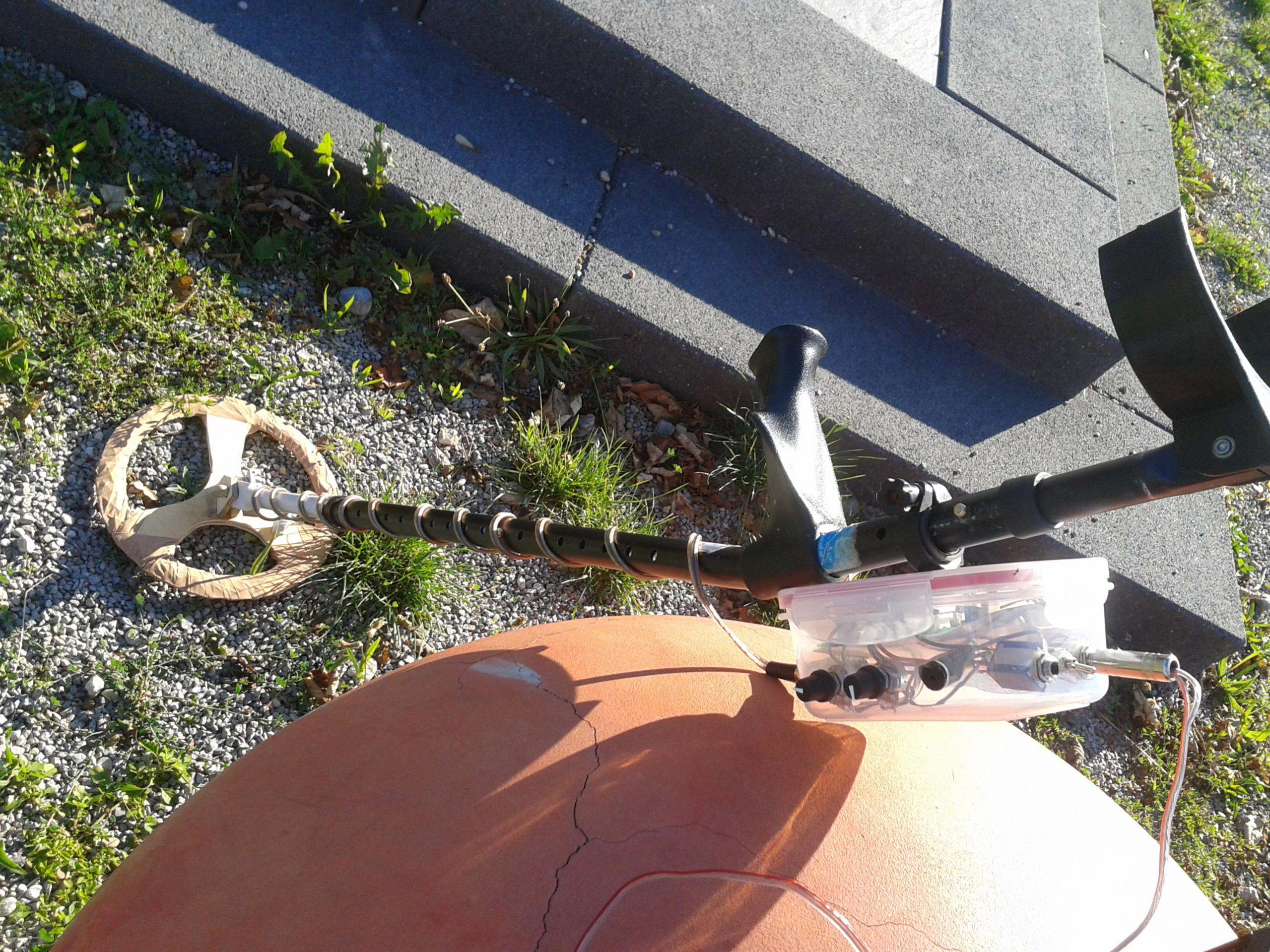

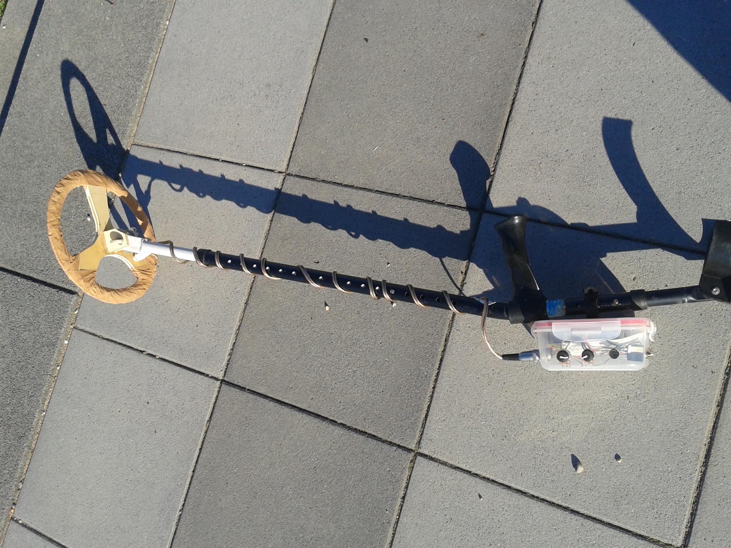

            If you attach some photos of your detector, I will add you to the Completed Projects thread.
              Yes, sorry for poor pictures quality.

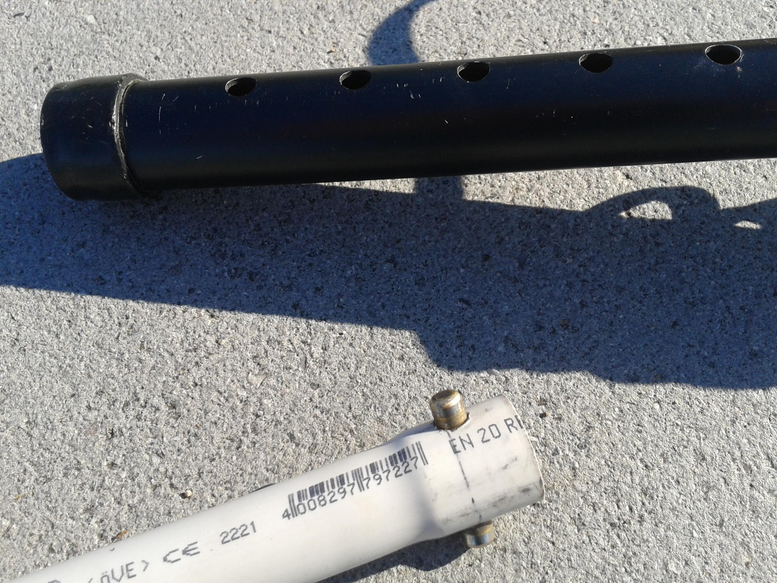

              You folks can see the solution for a PVC pipe extension of a crutch and that problematic power line with a switch between battery and connection jack.

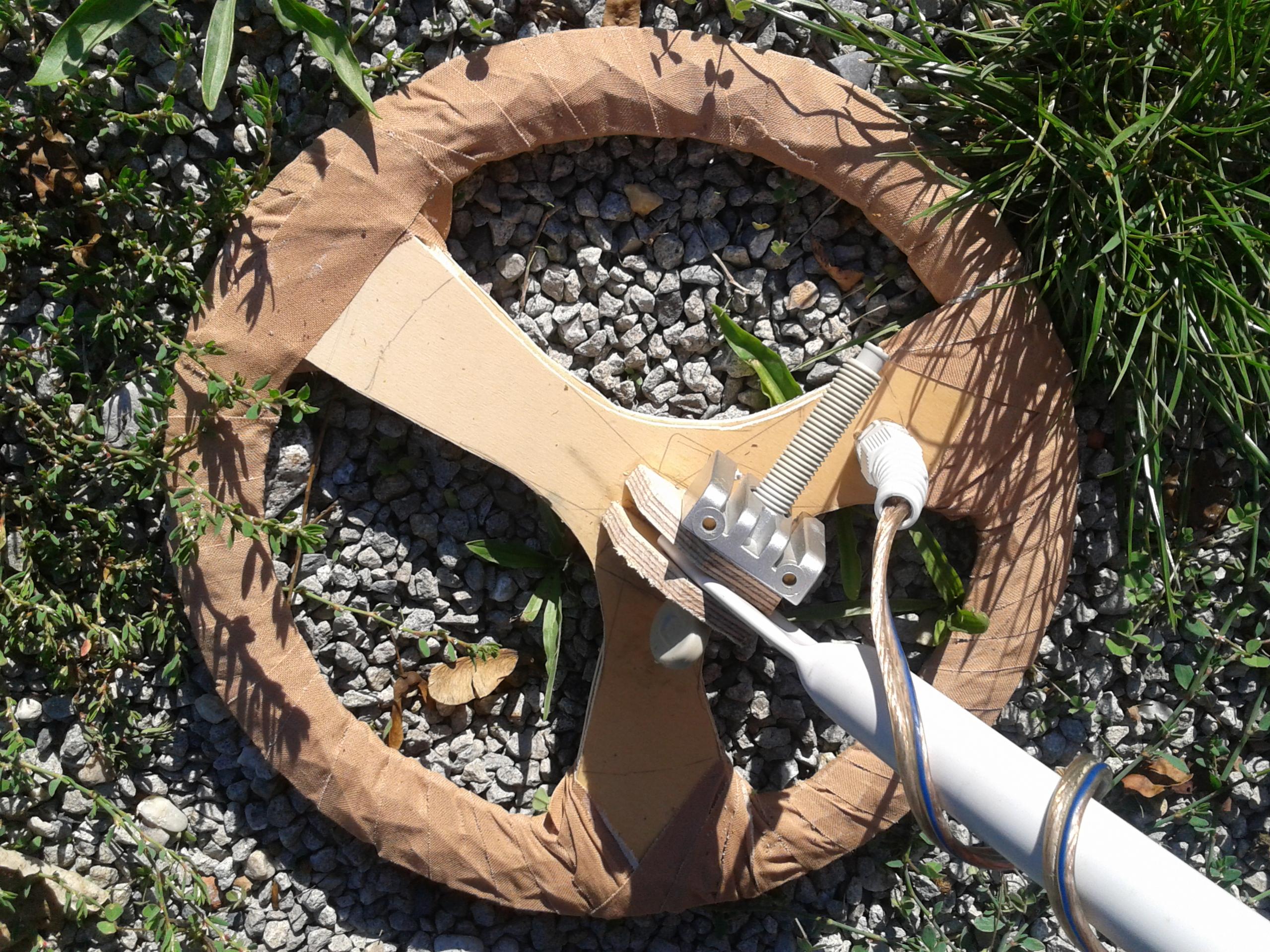

              More to say, that my new Inductance meter, recently arrived from Hamburg (there it come from China), say 1mH (1000uH) and 2.4Ohm. It have 25 turns (5x5 spider coil from this forum) of 0.5mm enameled cooper wire. The coil is 22.5cm between coil centers. ...it works good.
