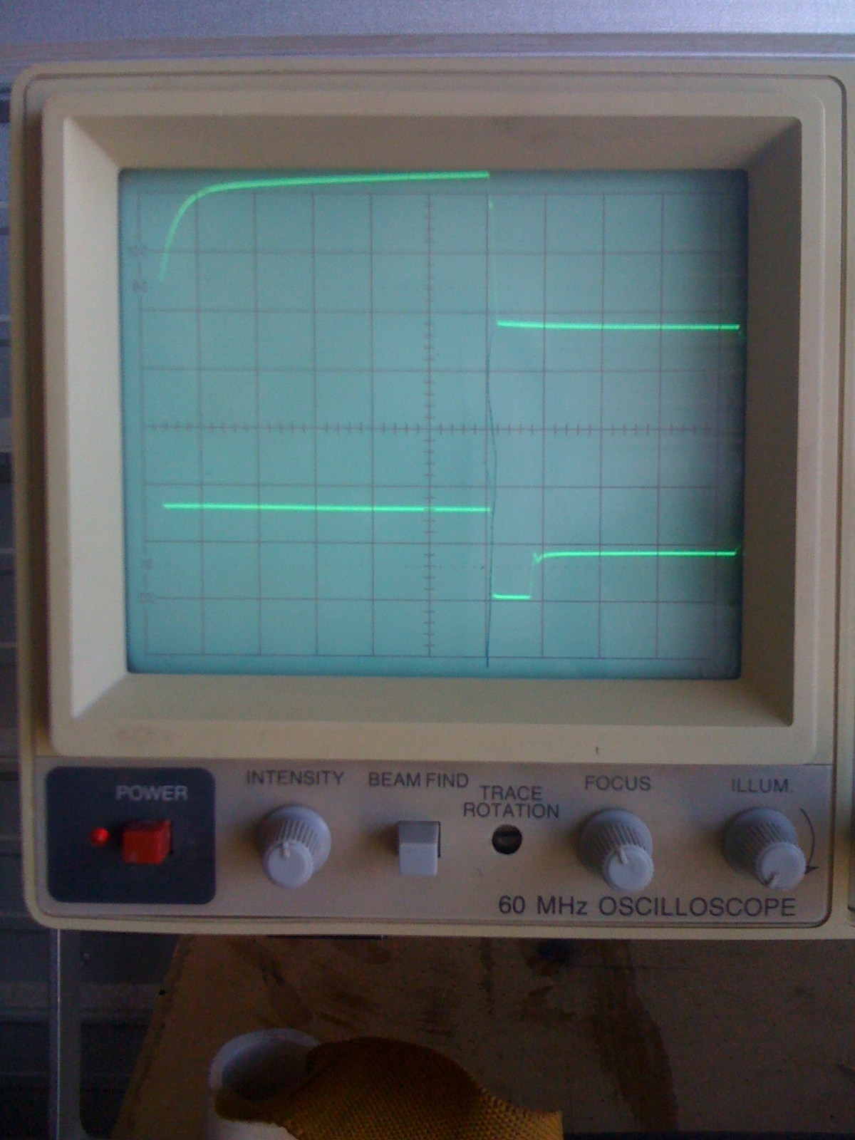

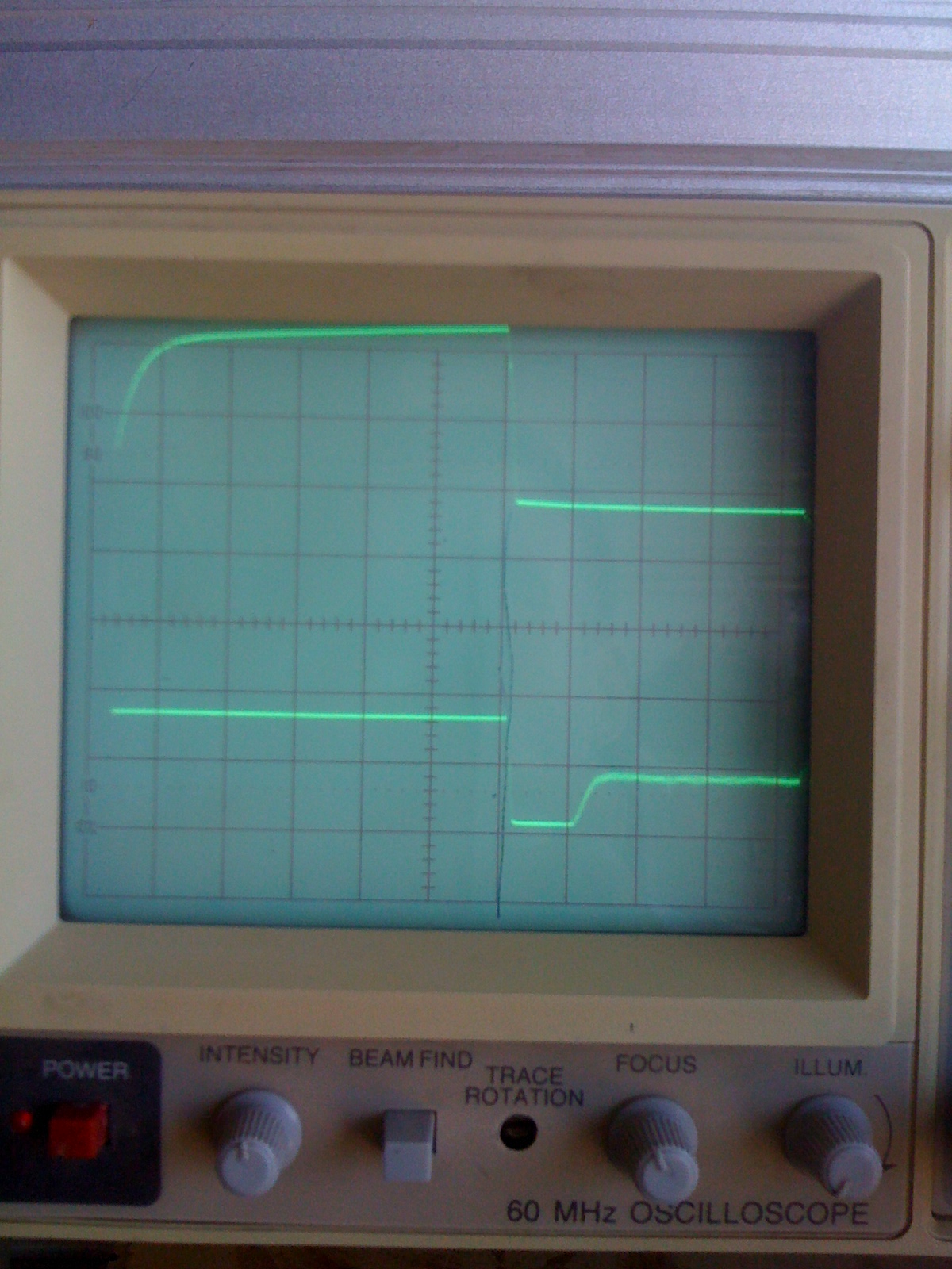

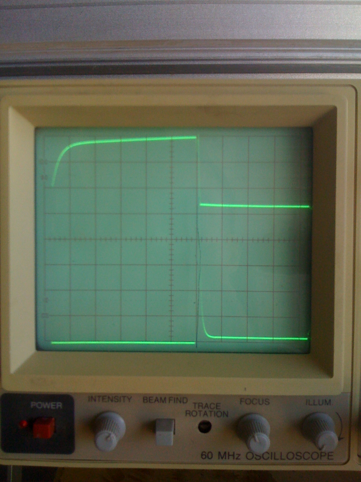

    In my post titled "Getting Ready To Build The MPP" a discussion between baum7154 and I revealed a surprising and unexpected delay in the Rx signal - very important to those of us building fast/low TC coils:
    In short, the MPP preamp section itself adds a total of 4uS delay, more than [my] the coil itself.
    'Scope shots attached
    For all 3 screen shots
    Timebase = 5uS/Div
    CH1 = 2V/Div Probe x1 - on TP1
    For the Coil Flyback pic
    CH2 = 5V/Div Probe x100
    Note the coil has recovered at 3uS
    Output Stage 1 pic
    There is an almost 2uS [propagation?] delay in the output of the first preamp stage (U5 pin 1) which isn't present at the input (U5 pin 2).
    Output Stage 2 pic
    There is a more than 2uS delay in the output of the second preamp stage (U5 pin 7 / TP3).
    Two things become apparent:
    1) It would benefit the MPP to use preamps with far less delay from input to output.
    2) The use of two preamp stages will unfortunately double the minimum main sample delay. Is it possible to keep the MPP sensitivity while using one stage with the required gain (I am guessing the original design attempted this)?
    As long as you position the early sample to begin where the signal starts to recover the delay should have no negative impact. You should be able to see sample feed though on the preamp output. Alternately you can just look at the gate drive voltage.

          The coil volts is decaying exponentially. The first op amp can't come out of saturation until the coil volts has dropped to about .1 volt. Can't see .1 volt looking at coil volts. Try looking at - input(across back to back diodes). The - input has to go to zero before the amp can come out of saturation. The output of the first amp has to drop to about .1 volt before the second amp comes out of saturation. Don't think it's all amplifier delay.
            A single stage amp will only go deeper into saturation than 2 seperate stages of less gain. The high gain single stage amp is the weak point of most kit detectors when optimizing for small gold.
            Dan

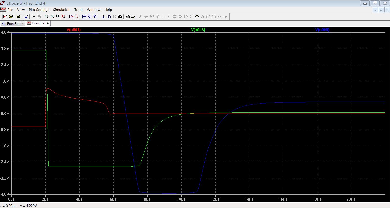

              I've done a Spice simulation on the two Op Amp MPP frontend and compared the NE5532 with the ADA4898.
              It takes about 4us for the first stage NE5532 to get out of saturation while the ADA4898 has virtually no delay
Name:	NE5532 versus ADA4898.JPG
                  [ATTACH]33578[/ATTACH]
                  Wondering why it takes so long for V(n000) to come out of saturation. KR's scope traces look similar to V(n006).
                        These two amps have vastly different specs. As follows:
                        =================NE5534 ------------------------------------AD4898
                        Slew Rate ===========8V/us -------------------------------------55V/us
                        Gain Bandwidth =======10mHz -------------------------------------65mHz
                        I think this may have something to do with this. However the AD4898 is not a Dual Amp and is not a direct replacement for the NE5534. Did not research if AN DEV has this in a dual package.
                        Dan
