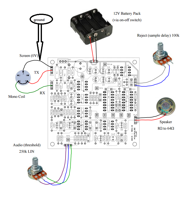

    i dont understand Coil connection TX and RX
    is that is dual coil or mono coil connection

    The diagram you attached shows the connections for a mono coil. It actually says that in the diagram.
    See Fig. 7 in the Build Document if you want to use a balanced coil.
      thanks Qiaozhi i just want use mono coil easy to make
        what is balance coil

          on that picture, line RED and Green Booth connection For Mono Coil And What Is The Black Line 0v

            This is an induction balanced coil, although a PI does not necessarily need the coils to be balanced.
              The black line is connected to 0V, which should be connected to the shield.

                ok thanks Qiaozhi
