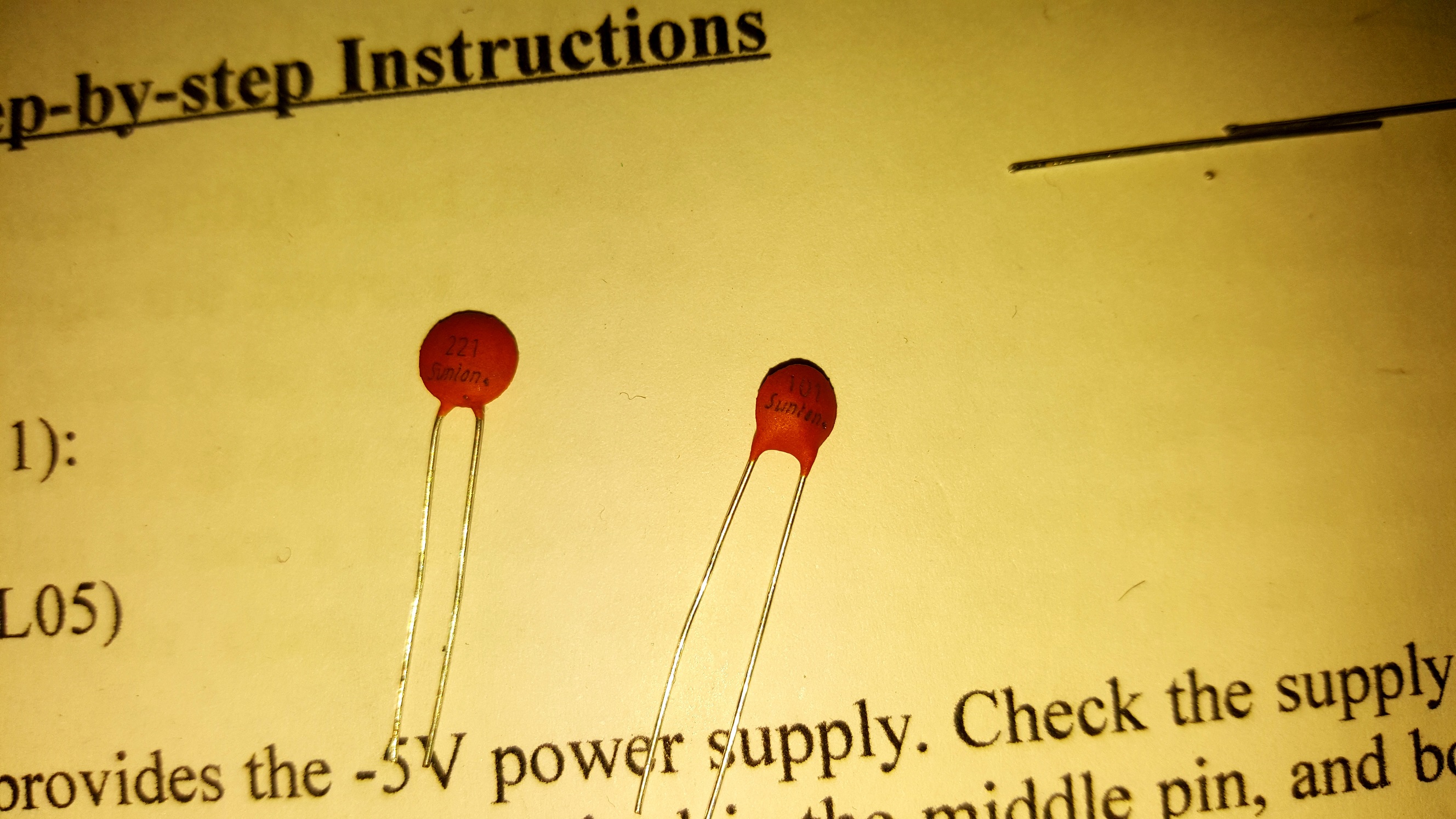

      The kit has landed! i have only had a few moments so far and i have done stages 1 (-4.979v) and 2 (5.084v) i will post pictures later. For stage 3 i started to sort the components and i cant find C20? i have looked at other posts to see what type i am looking for and it looks like it is one of the ceramic types it calls for a 100pF so i used my multimeter on both and neither are 100pF, any ideas? The last thing i want to do is put a component in the wrong place!
        you should have C20 a 100pf and C8 220pf - do either have any markings on them ?
          Heres a pic, one says 221 sunion and the other is a 101 sunion, i think it might be my multimeter as it reads all of the others fine appart from these two so i will use the 101 for C20 and 221 for C8?

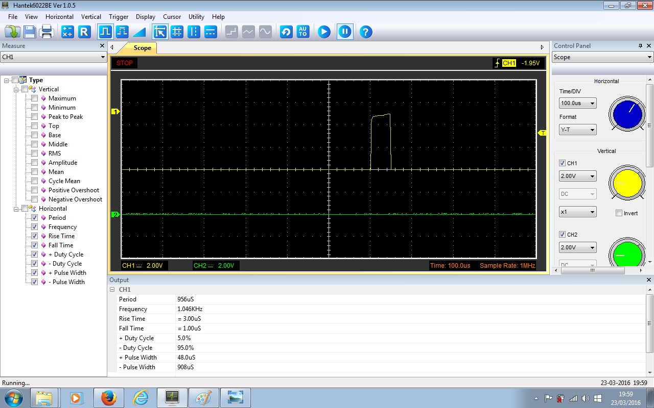

            OK so i have done stage 3 with success i think a question though, my batt voltage is a little on the low side (my fault) the manual says as the batt voltage drops the pulse width will increase (or get wider) but it says i should have 58us at 12v i would expect to see 58us+ as my batt voltage is low but i have 48us?
            heres a scope pic
            Hz - 1.046Khz correct
            Pulse width 48us battery voltage is 11.4v

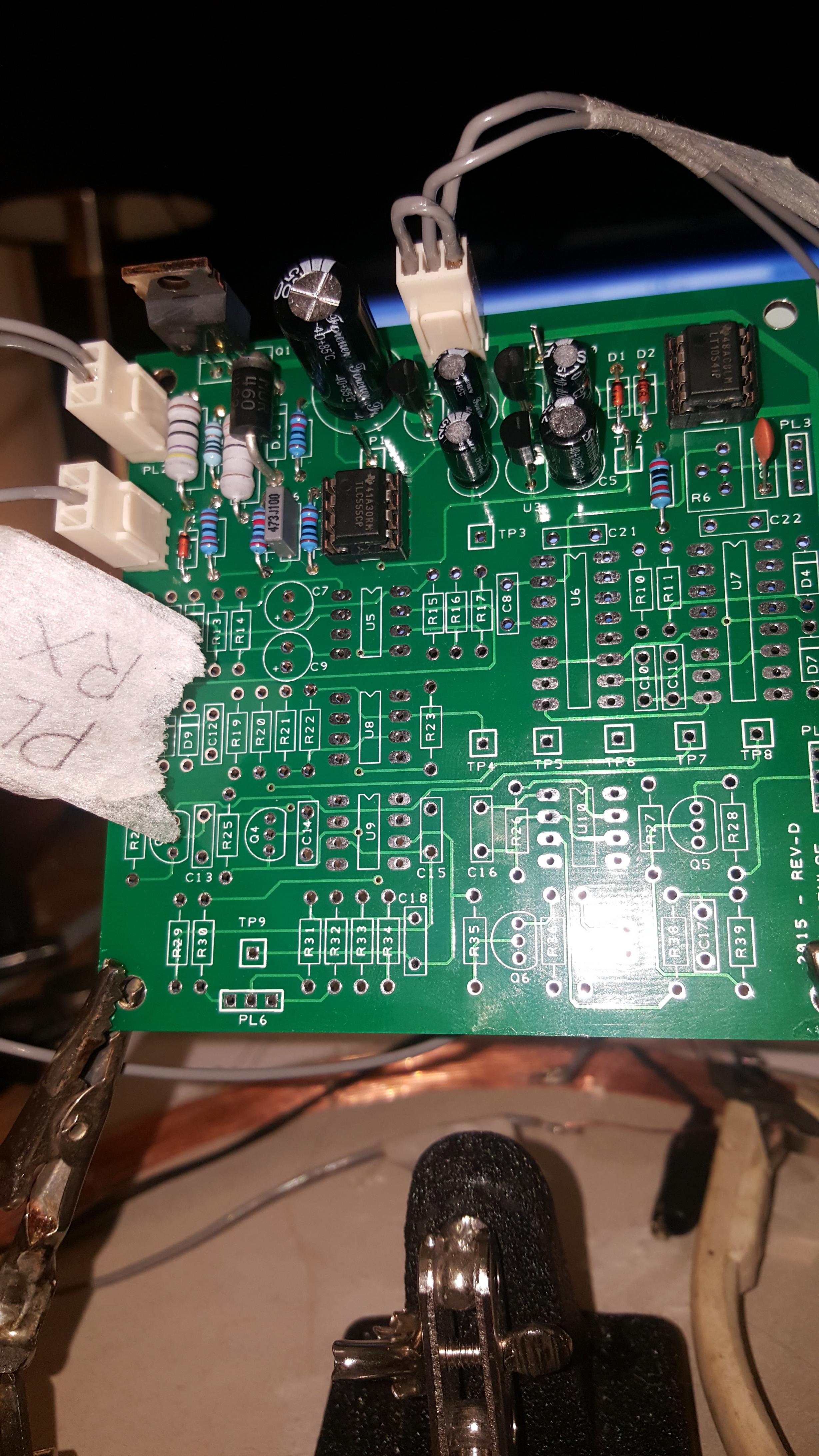

            pic of the board

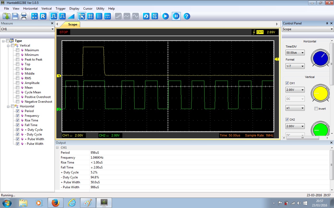

              does this look ok? this is CH1 TP1 and CH2 U2 pin2 the last check for STEP 3 i thought i would cover everything in every step

                Yes, that looks good. You can see that the voltage doubler is synchronizing with the TX oscillator.
                At this stage I wouldn't be too concerned about the TX pulse width. It might just be a problem caused by the low battery voltage, or a component tolerancing issue. You can come back to that later.

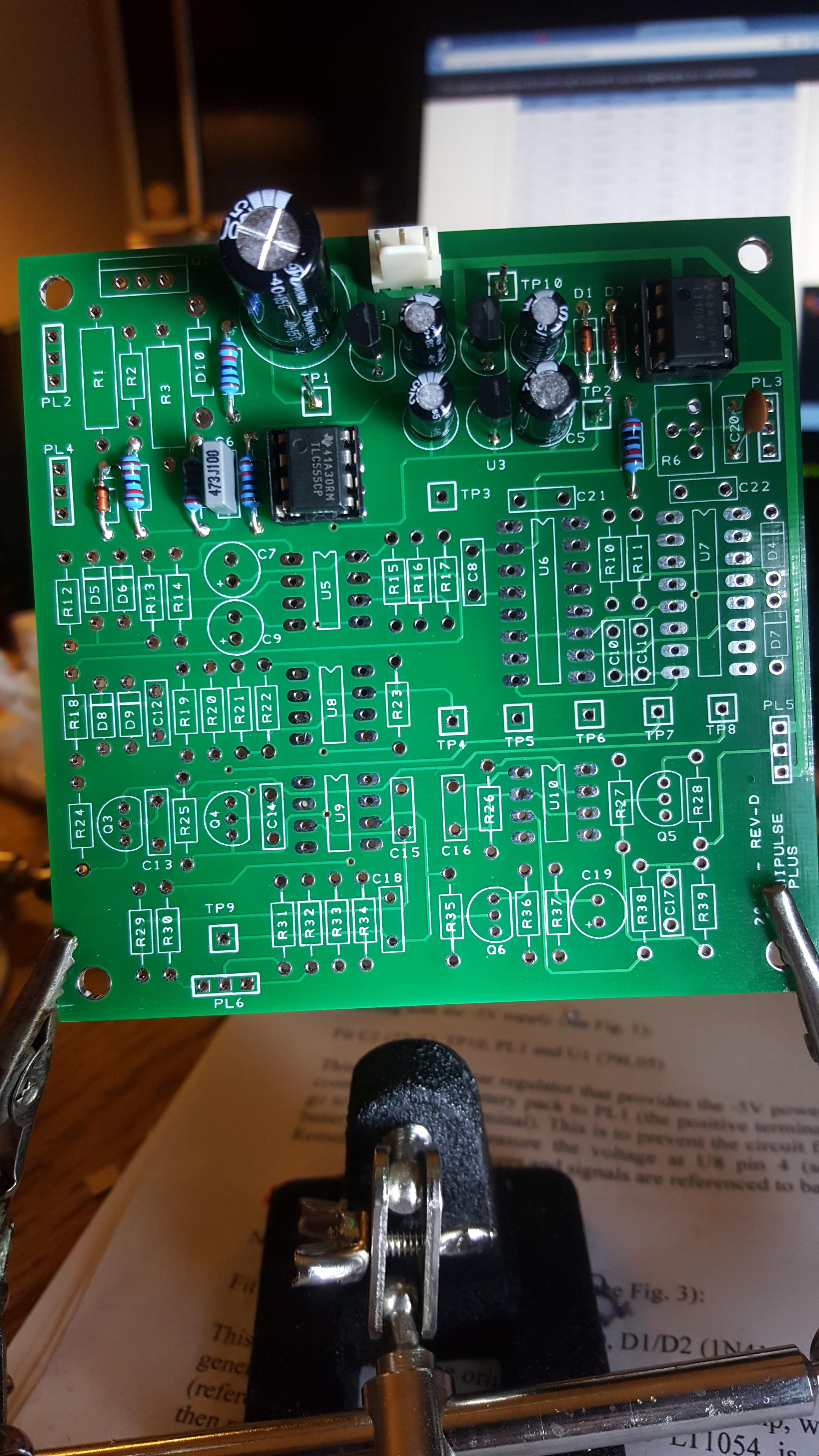

                  ok so i have managed to get stage 4 on the board but i have attached my scope to the balance resistor and i get this

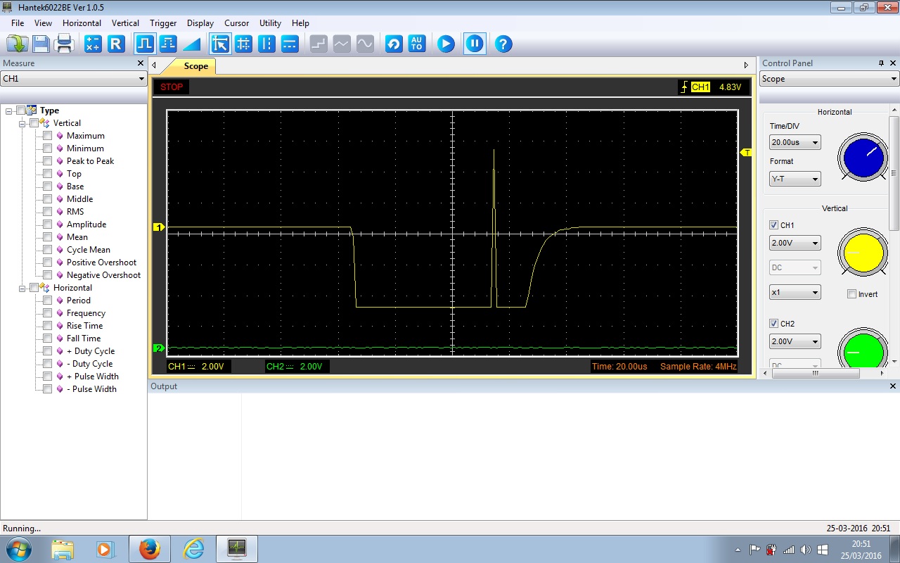

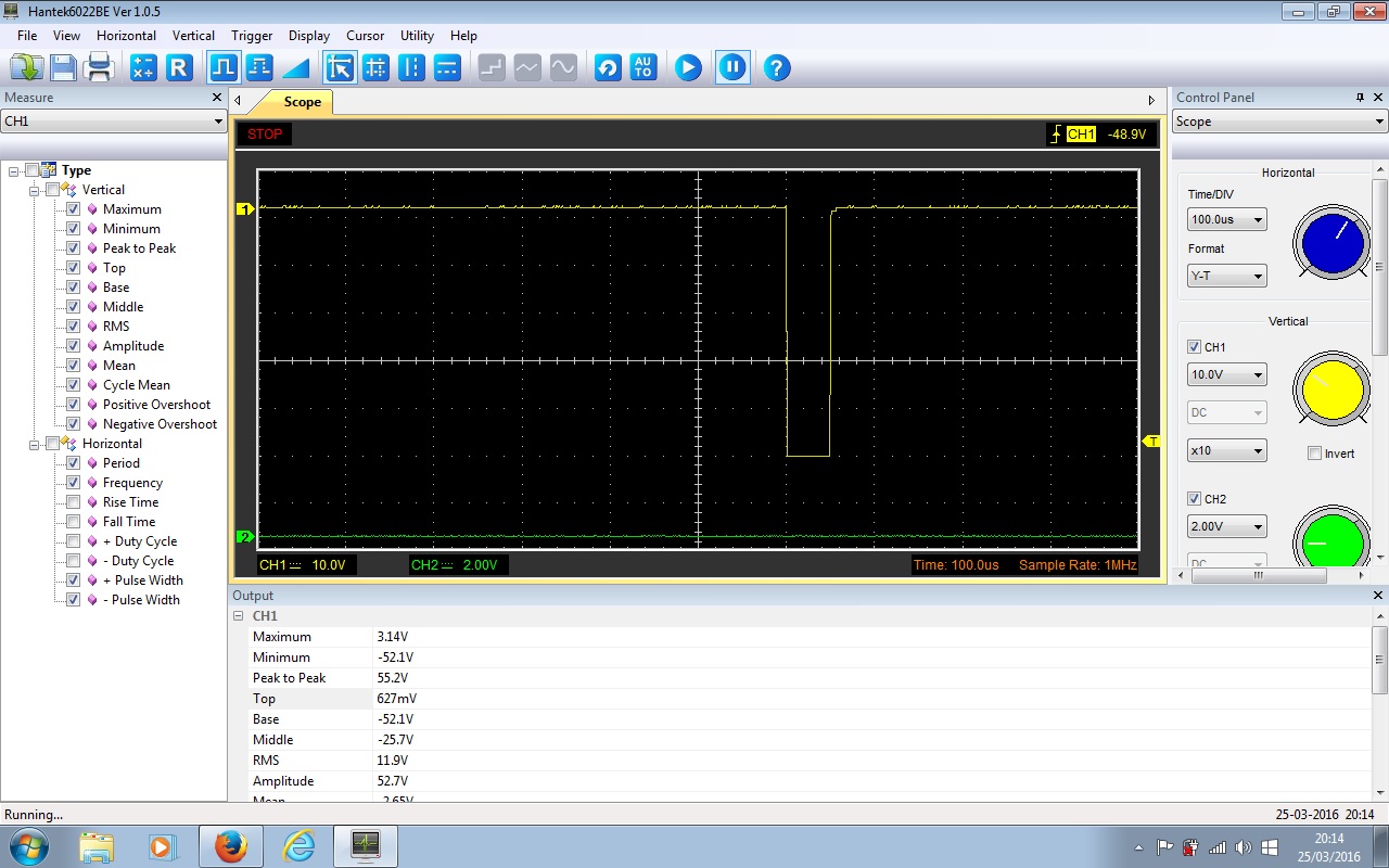

                        ok ignore the last 3 posts i have my head on now!! i have TX RX connected to the inner most winding and pin 3 of PL2 to the outer most winding now this is the o-scope image i get
                        here Click image for larger version
                        and i now get the tone in the headphones yay!
                          Hey guys does the scope image look rite I don't want to move on without confirming that it is correct?
                            Your PC scope appears to be limiting the amplitude so that you're not seeing the full flyback voltage. Try changing the setting on CH1 from x1 to x10, and use a x10 probe.
                            However, since you can actually hear the TX oscillator in the headphones, it's most likely ok for you to carry on.
                              My scope cannot handle more than 80v in 10x I don't want to break it . Thanks Qiaozhi for you help again
