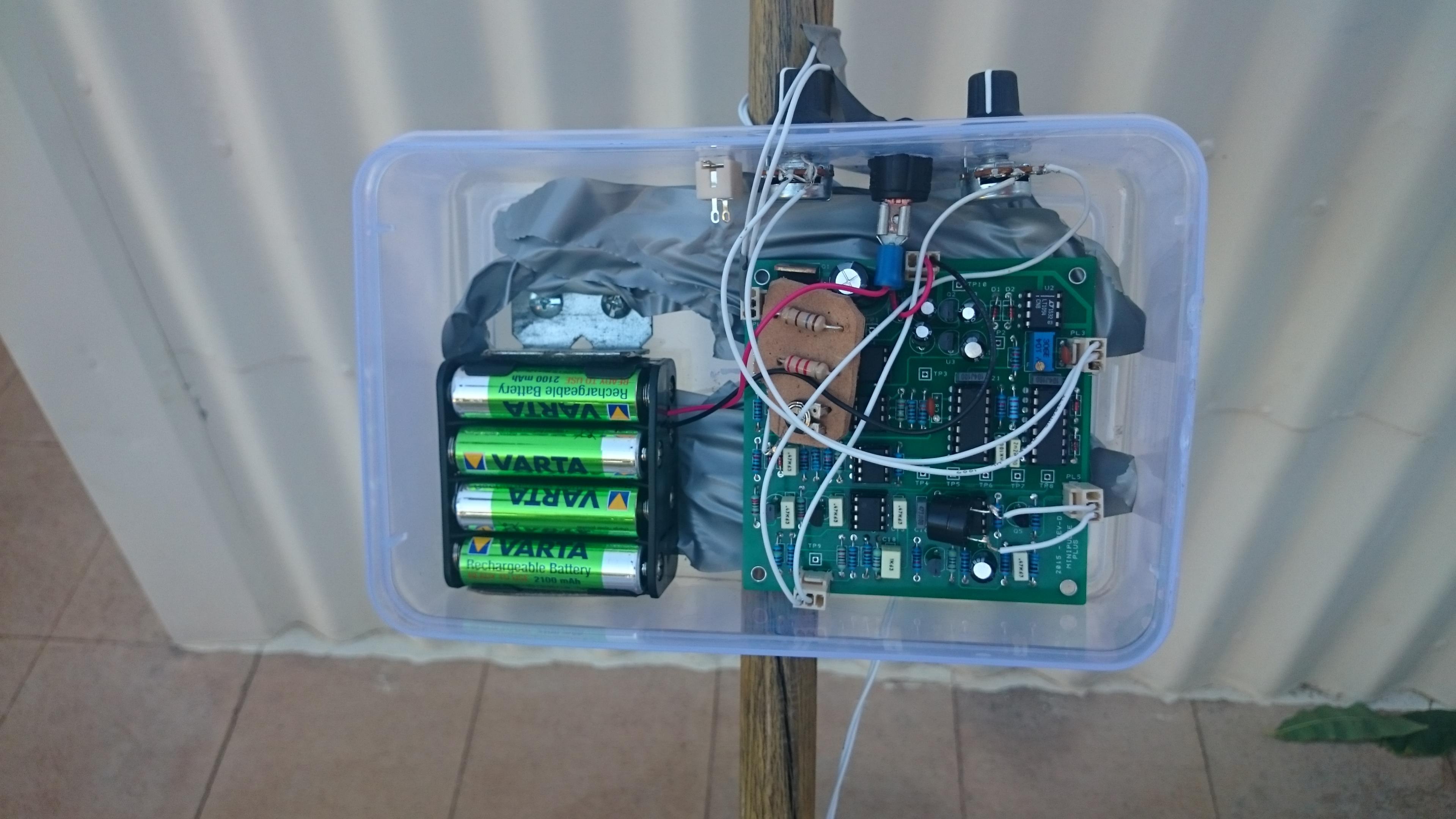

          Intresting what you guys dicuss here in my Thread I dont understand much since i am quite new to all this stuff.

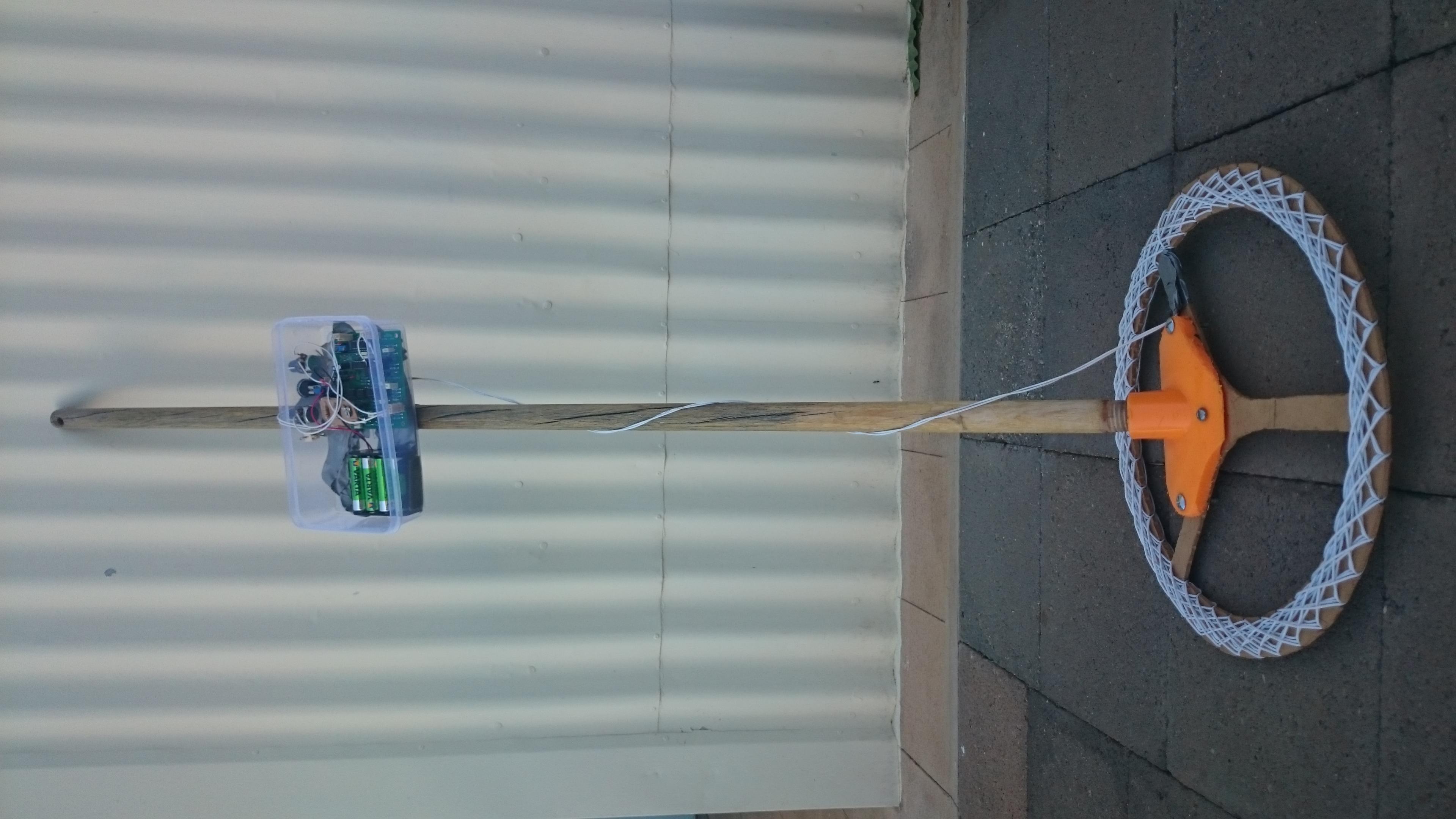

          I am thinking about building 1 or 2 coils with the 3DSS pattern from the Chance PI coil thread. I brought up 3 questions there, maybe if someone can answer them. I just have limited time to actually build the coils, since i have access to some more tools right now, but i will be back on the road soon.
          Anyway i made progress today to attach switch, Potis and Line In on a plastic box. This box got attached to a 5 AU$ broom Looks funny, but it does the job! I will post pictures when i am finished. It will look really selfmade haha

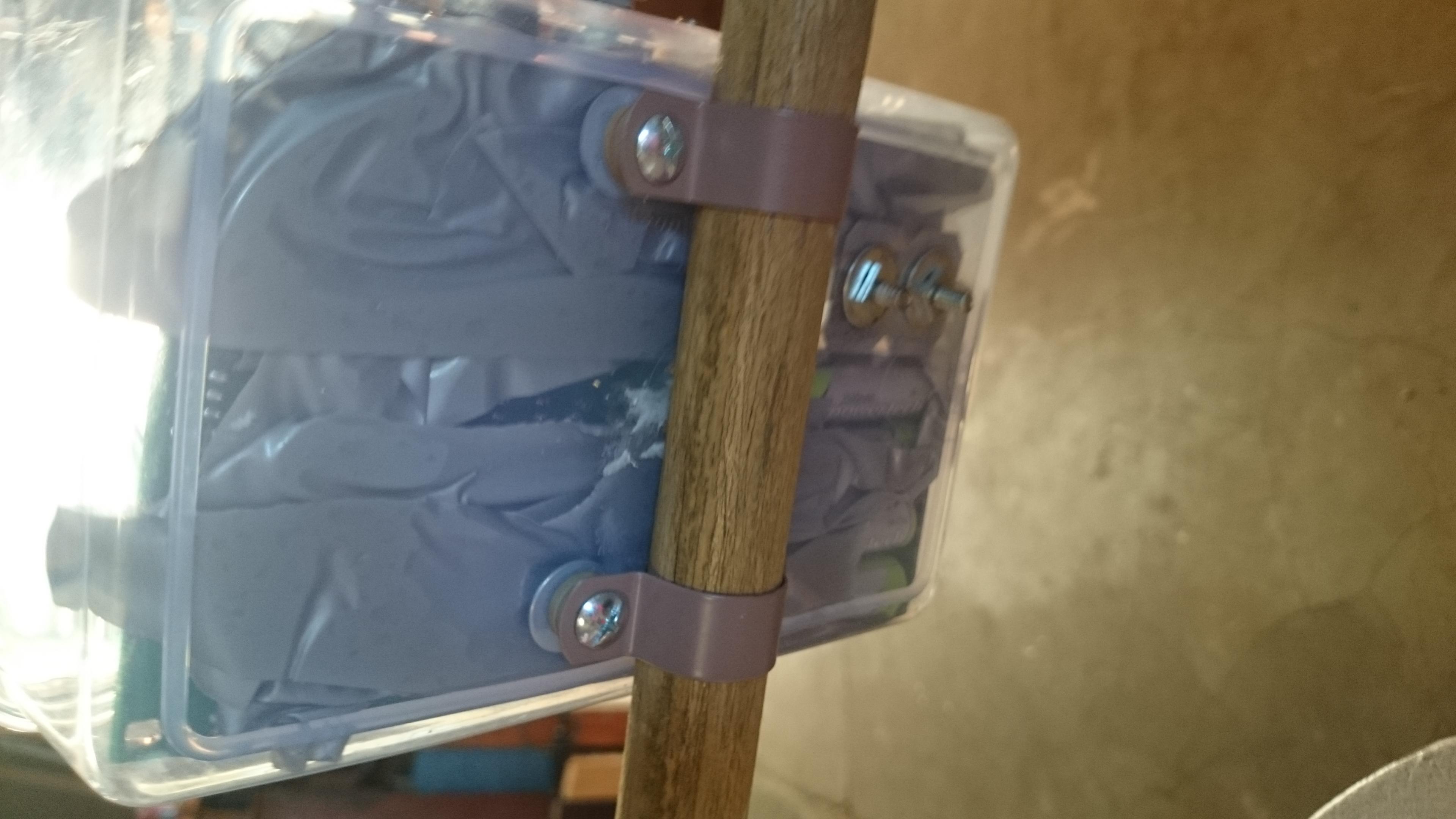

                    Got it working!

                      You might wish to replace a broom handle with a crutch, and fix the control box with something a bit more sturdy, say a pipe clamp
                      Also make sure things are not banging each other in a box.

                              The box is attached quite well I guess. Anyway I don't care much about optics and handling, it must work... ��

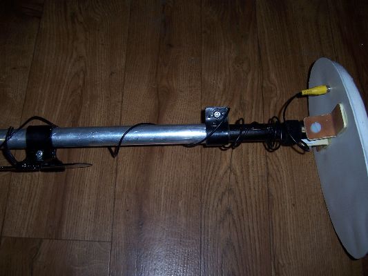

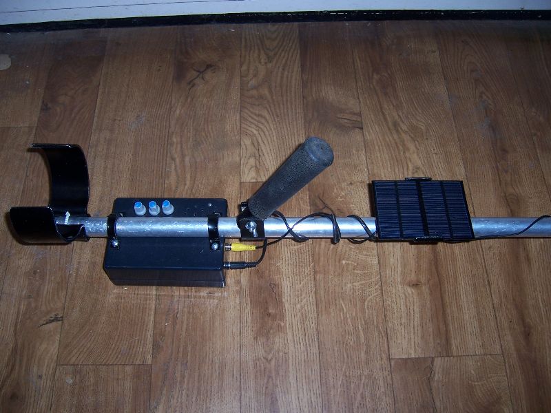

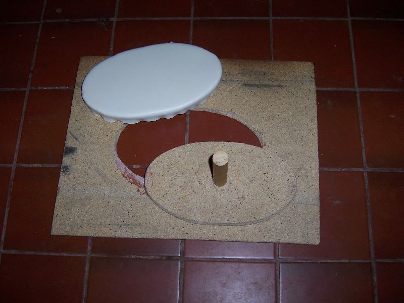

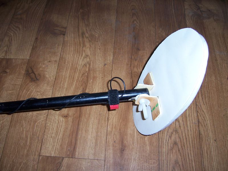

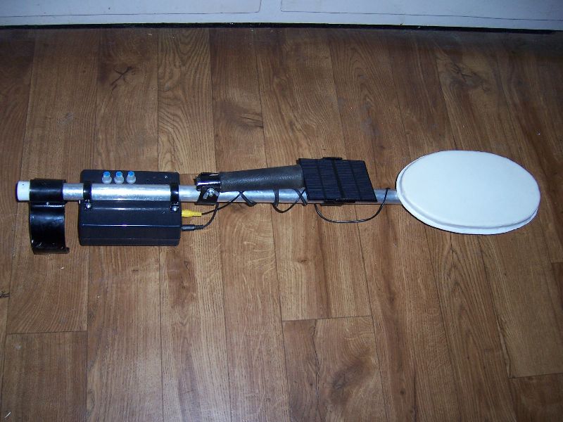

                                Here's my standardised set-up. The box is from Kitstop.com.au.($5)They are made by Futurekit Thailand. The armrest and brackets are all made from PVC sewer pipe heated and shaped with a heat-gun. Coil is sewer pipe as well, pressed into a wooden mold after heating to 180C in the oven. Coil top is stormwater pipe(thinner) glued and clamped with white silicone(for 7 days-to be sure it's dry).Filled with white packaging foam.
                                Upper shaft is 25mm aluminium from the hardware store($10/m) (700mm) and lower is bamboo veneer broom handle($5)(900mm)-very,very strong.

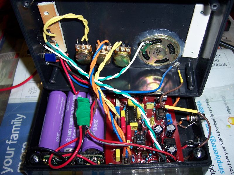

                                This is my Baracuda. The LED near the switch is seriesed with a 11.6v diode (a bit high) and stops glowing when battery is low.
                                The charge controller is along side the battery box ($4-ebay) It can charge 3 or 4 18650s.
                                Last pic shows simple brackets with wingnuts-a piece of rubber bike tube is glued in one half of shaft bracket to clamp lower shaft.
                                The MPP will need the next size box,or your choice, but it folds up very compact, and has a 1.5w solar charger. The on-board Li-ion controller means it can be charged from any un-regulated 12V source. The 10v reg in green tape was omitted when I changed the 7660 for a 1054.
                                This is lighter than it looks-about half the weight of the polio crutches used by me and others, and about the same as my Tracker IV.
                                I have the MPP RevD board from Silverdog now to build, but this 'cuda performs better than any of the MPP vids I have watched......
                                I hope this shares some useful build ideas.
