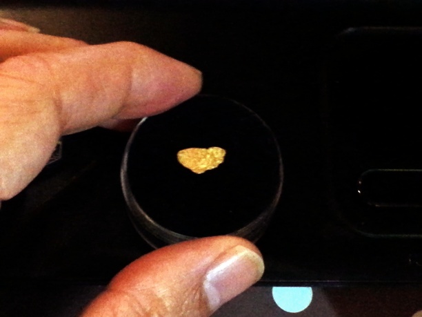

    Today I hit gold for the first time with this machine. About 5 cm deep in wet salty sand.
      Great find.

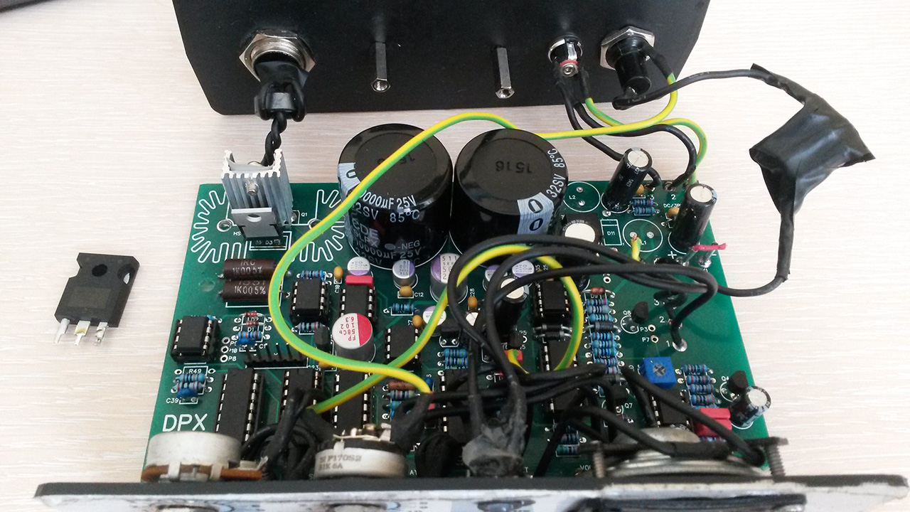

        The MOSFET (IRF740) is avalanching at 400V for a few usecs. Not good. I've replaced it with a 900V MOSFET in an attempt to increase the transient peak voltage and shorten its decay.
        The new peak is 550V with no avalanche. Less than expected. The reason for this low peak is the high capacitance of the coil (estimated 750pF).
        No improvement with the transient's decay, instead I got a slightly longer saturation period at the preamp. Minimum sample time increased from at 5,5us to 6us.
        I'm expecting a new DD coil (for ML GPX) to arrive next week. It should have less L and lees C.

            Did you check how high the peak voltage was after the replacement? How about the output of the preamp?
            My guess regarding depth is that the gain of the preamp has to be reduced because the signal is now stronger, which causes saturation at early times.
            Regarding overheating... how does the Rds_on of the new MOSFET compare to IRF750? If it's lower then the current at the coil increases and you should either reduce the pulse width or add an appropriate resistor in series.
              The Mosfet was STW40N95K5
              N-channel 950 V, 0.110 Ω typ., 38 A MDmesh K5
              Coil was 1.6R @ 550uH, added resistors in series (4 x 2.5R, 2 Watts each) - those showed signs of high heat too (!)
              Have no scope at this time so no measures were taken, just swapped and tested.
              Depth was significantly lowered no matter the pulse width (100-400us).
              Mosfet had almost no heat, could handle all this without a heatsink.
