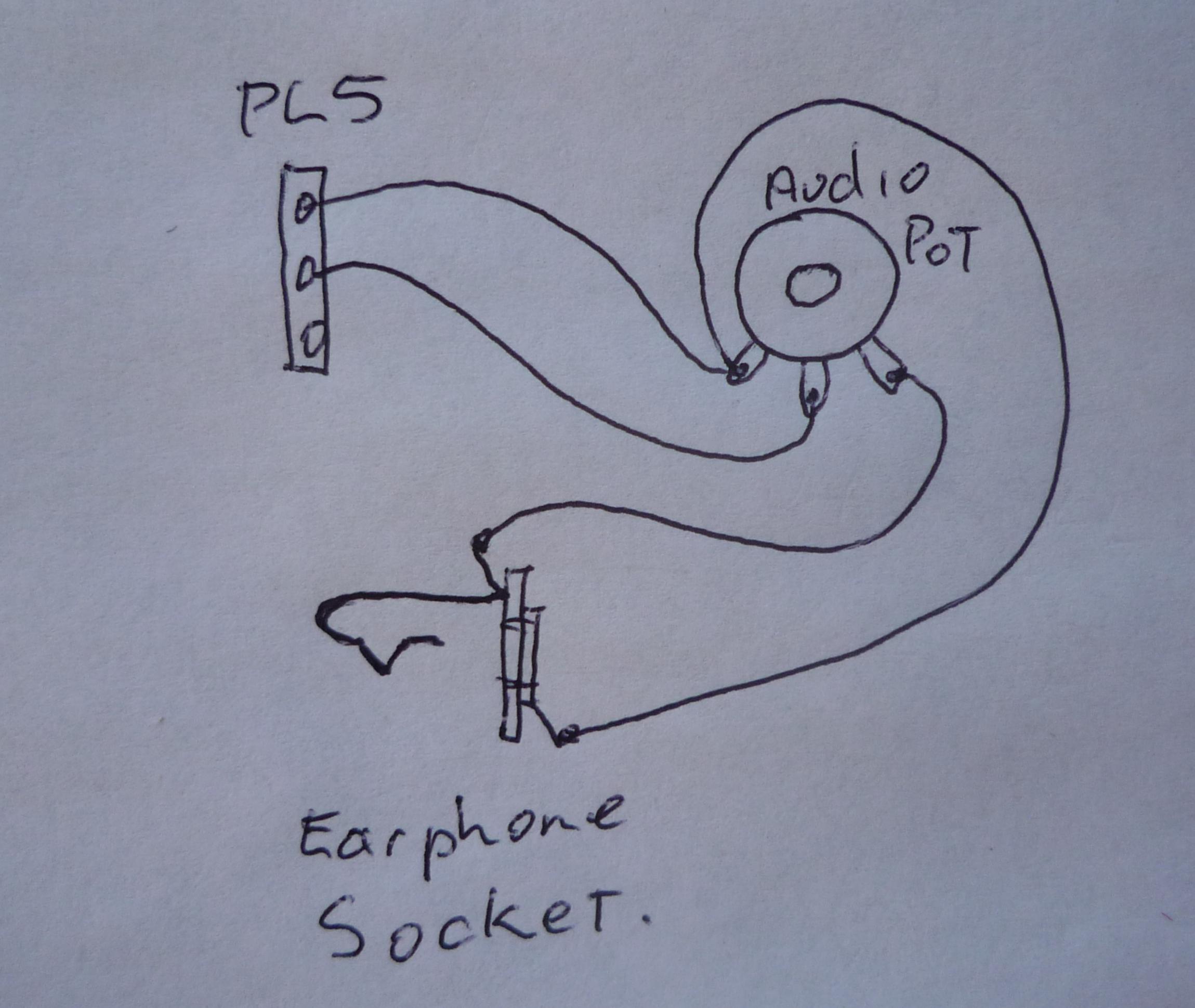

Minipulse build
Think I got it sorted.
Sketch attached.
I found that a 100k pot worked better than the 5k. Might try a 250k when I can get hold of one.
If you have your electronics in a metal box make sure the earphone socket is isolated from the box.
Cheers
Hope the sketch makes senseAttached Files
It is not the correct way to set the volume at the output of the 2N3906,
let the circuit unmodified at the output....,R28 protect the 2N3906.
the easy way is to connect parallel to R27 a poti,
or replace the R27 with a potentiometer.
it work perfect.

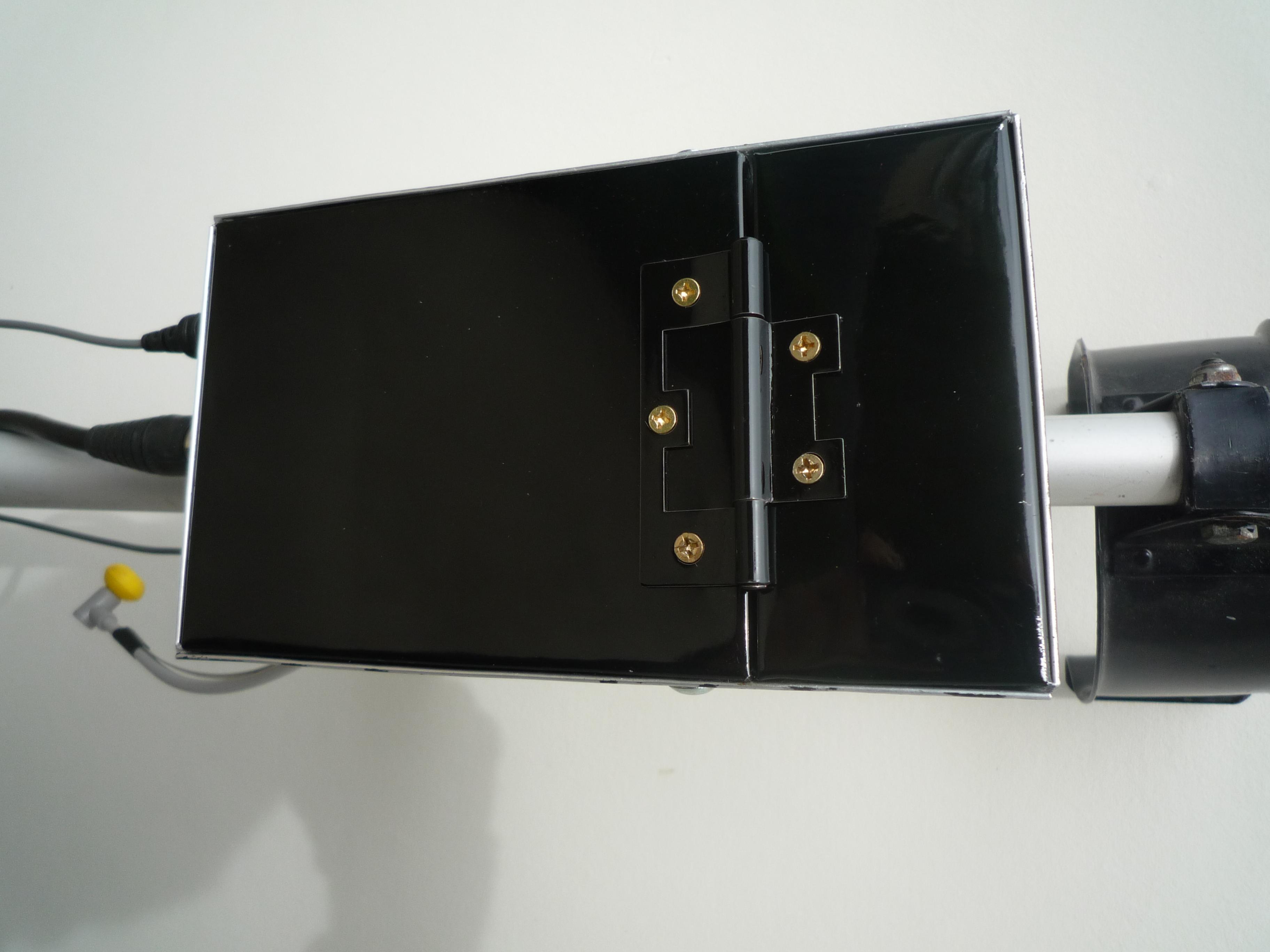

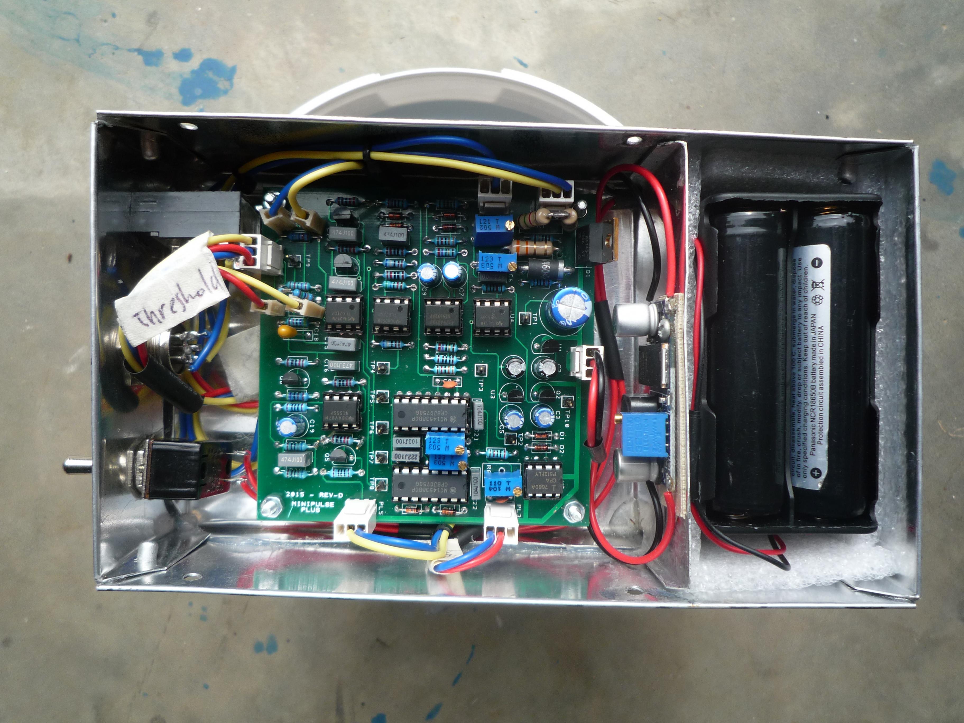

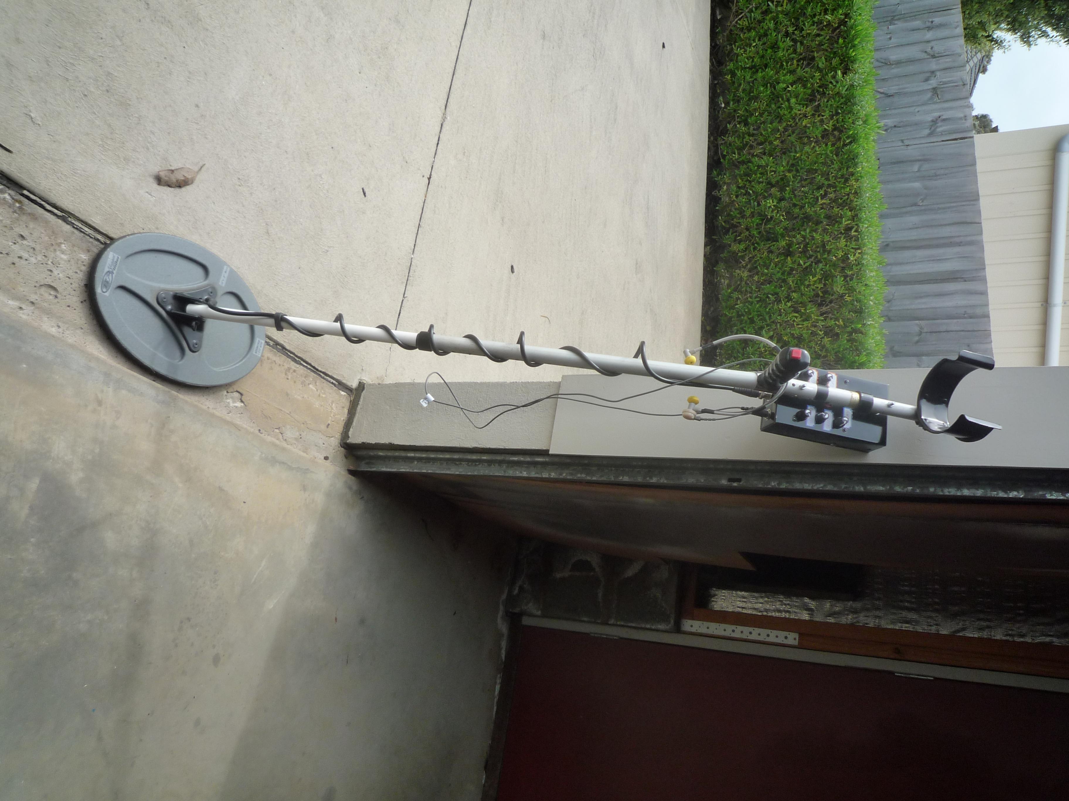

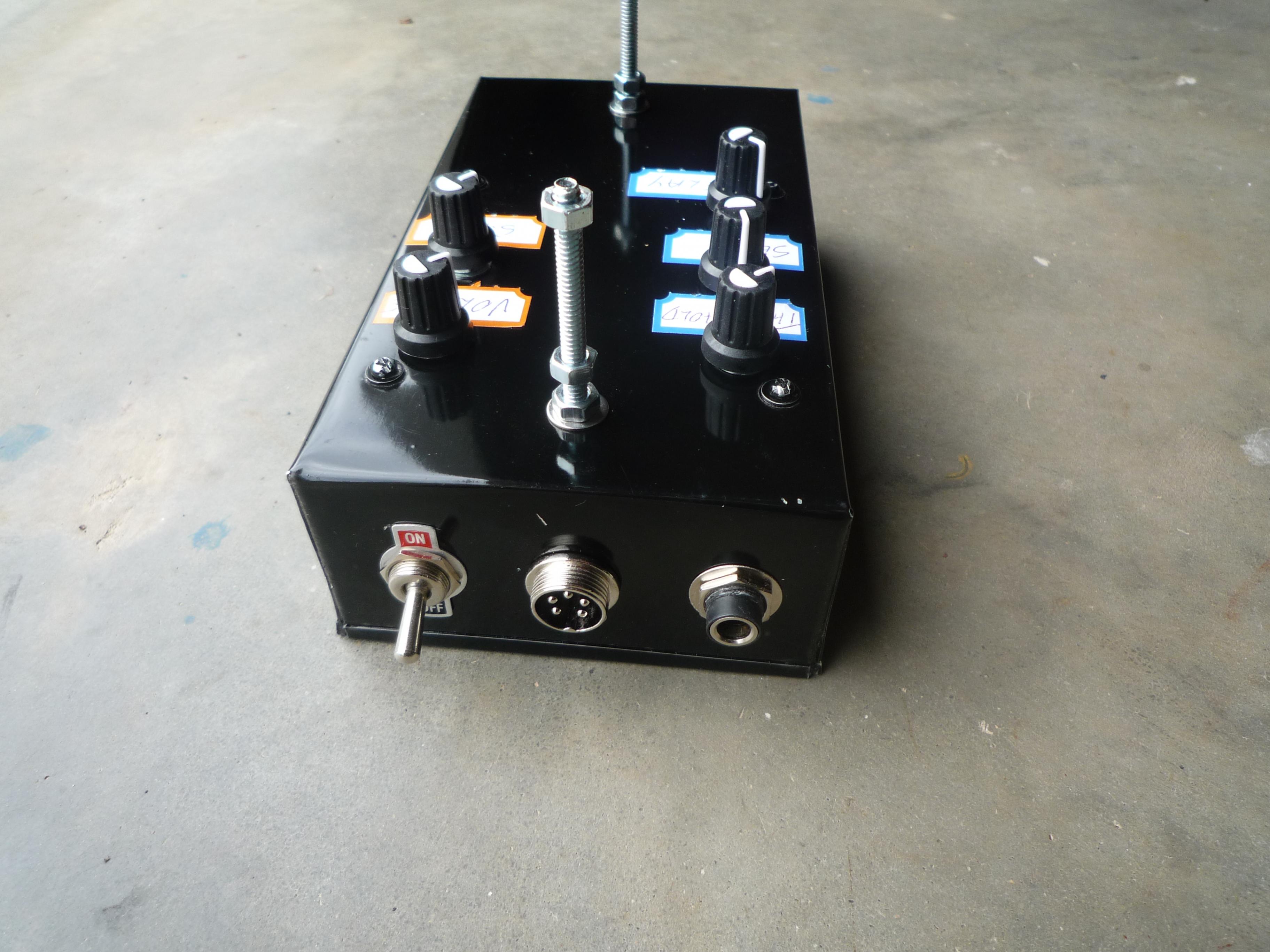

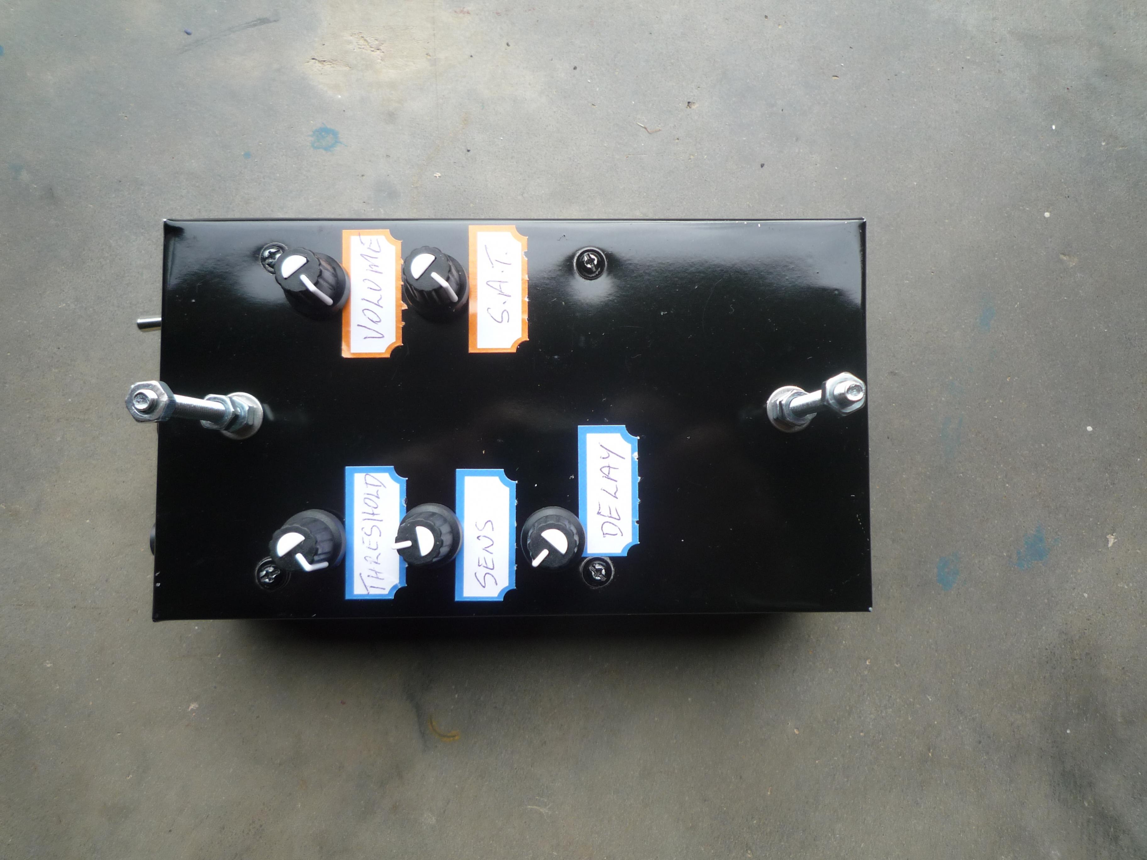

Finally got everything packaged up.
Made an enclosure with separate battery compartment from aluminium sheet.
The power supply at this stage is 4 Li-Ion batteries with a voltage regulator set at 12v but this may have to go because I think it has introduced noise into the circuit.
Most of the mods are from KRinAZ, Thank you.
TX pulse width is 30us
Frequency set at 4000. May put an external pot for this at a later stage.
Main sample delay min is set at 6us
Sample pulse width is set at 22us
Sample delay is 130 us.
Very happy with the outcome.
Plan on testing it in the goldfields on the coming weekend.
