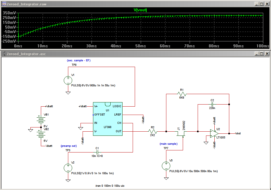

    The differential integrator in MPP is based on a small signal model. It's is not a true differential integrator for larger signals.
    I'm submitting this alternative based on a Sample/Hold auto-zeroing configuration. The LF398 chip is inexpensive.
    The second sample (EF) is used to charge the S/H capacitor. The main sample is fed to one side of the S/H capacitor, thereby subtracting the "memorized" EF from the input signal (auto-zero). The output of the S/H is then fed on to a true integrator.
    This is the concept (node references corresponding to the MPP Rev. D schematic):
    J1 and U2 were chosen for convenience in LTSpice, but the original J113 and TL072 can be used just as well.

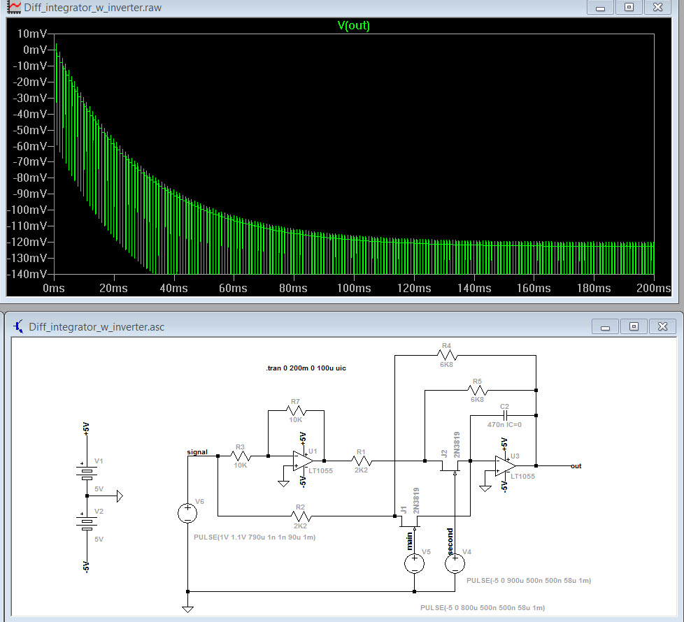

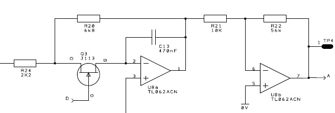

      To maintain the polarity of the output we would need an inverting amplifier, like the original MPP:
      Also, the capacitor C2 in my schematic should be 470nf (not 22nF).

          Didn't test it myself. In any case using that audio circuit would allow you to remove the inverting amplifier U8b.
            Here's the updated version with the inverting op-amp. Attaching PDF file only because it's better than JPG, no preview sorry
            20092016_2.pdf
              [ATTACH]37199[/ATTACH]
              It looks good. Now we only need to replace the timing logic by an ATtiny uC for flexibility. Q3 can be replaced by a 900V MOSFET, too.

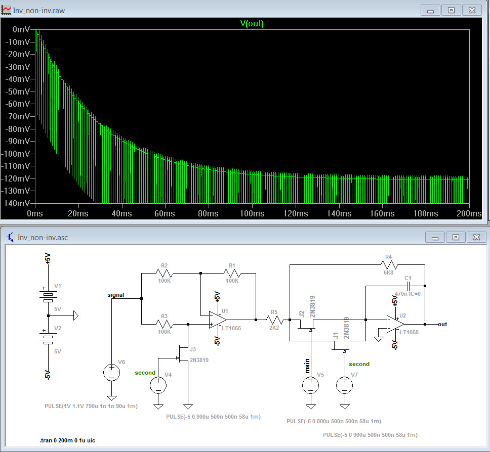

                    Two more alternatives:
                    1. Switchable inverting-non-inverting voltage follower + integrator
                    2. inverting voltage follower + 2-path integrator.
                    LTSpice files attached as .zip

                      Here's the full schematic with Option 1 with LF398 (not tested!).
                      20092016_3.pdf
