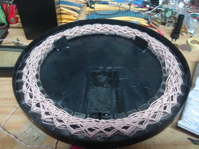

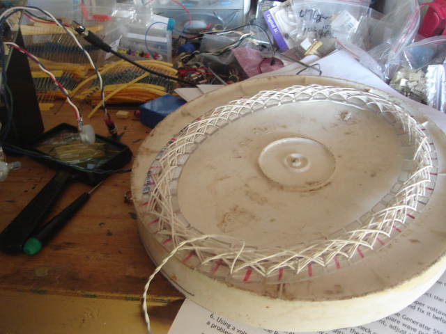

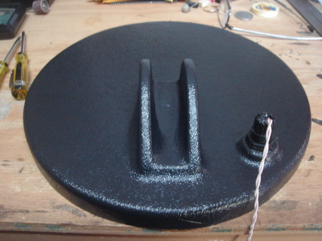

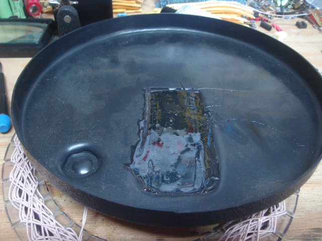

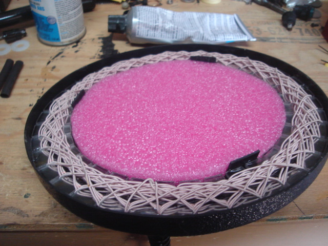

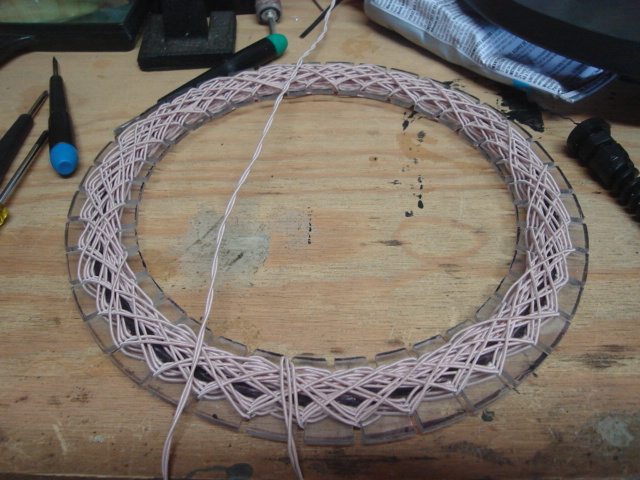

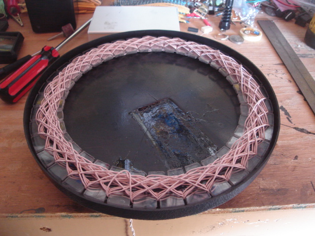

some pics of my last 3dss @ 7-3/4" round with 250/46 litzAttached Files- 7x9 eliptical spider coil.JPG (145.8 KB, 161 views)

Nice work on your 3DSS coils. Did the Litz show a significant improvement over the teflon wire?
yes, in my testing and coil building I find the litz to be more sensitive to small gold than the Teflon silver plated. Also I have built them using the different size litz and find that the 175/46 and the 250/46 are the best sizes to use. Both work well but in retrospect I would use 175/46 as it seemed to have the best sensitivity.
All my tests were done with modified MPP's and I have them setup specifically for small gold. With the same size coil in litz and one in Teflon the litz won by over 1 inch in air tests with small gold test nuggets of 1 gram and 8 grain.

I bought 3000 ft of the 600v 24awg silver plated wire and built numerous coils but my personal opinion is the litz is just a bit better and worth the extra investment.

All of my coils I keep 36/40 inches of tag line or feed line directly from the coil as the leads to my coil plug on my rear panels, twisted at a rate of 3 twists per inch so I have no breaks or solder points any where near the coils or coil housing. Seems to work very well.
I believe Dan (baum7154) came up with the twisting of the leads, not sure but it was something I had been doing for awhile. It keeps the sensitivity at max or unsaturated keeping all solder points away from the coil itself.

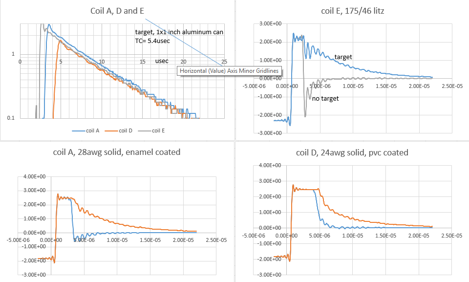

Have you looked at amplifier out with a scope with the different coils? I did some tests awhile back in another thread.http://www.geotech1.com/forums/showt...725#post213725
The amplifier did come out of saturation sooner with the litz coil. After the coils came out of saturation the coils looked close to the same with 175/46 litz, 28awg solid enamel coated and 24awg solid pvc coated. Wondering why you are seeing a difference. Maybe a no target scope trace would show something, maybe not.

You know, I did use my scope to base my thinking off of, I don't remember if I took any screen shots or pics of the scope at the time, I'll have to look thru my files.
The big thing that was very noticeable was the recovery of the litz wire coils versus the Teflon coated wire or ptfe plated wire coils. Now one thing I didn't mention was the mmp boards were modified, using 30 and 34us TX pulse, freq/pps set to 3000 along with sample delay set at min 7us, both sample widths set to 15us, secondary sample set to 147us.
With 2 boards set exactly the same, the 3 coils used were 7-3/4 round, one with 24awg 600v ptfe, one with 175/46 litz and the last with 250/46.
During initial tests (at least from my limited knowledge stand point) both litz wound coils, at output of opamp would return to 0 within 3 to 4us whereas the ptfe coil was around 10us before return to 0. The part that was very noticeable was the very quick recovery from a target signal to 0, it was snappy, very crisp and clean. Again, I don't have the knowledge or know the technical terminology to use for some of the things I mentioned so it may sound odd to educated ears.
I tried adjusting the TX pulse up, reduced the freq/pps and basically after much messing around found a sweetspot for the litz wire coils with my mpp's the TX pulse set to 34us, the sample widths set to 15us, minimum sample delay set to 7us was best and fastest with the cleanest and most crisp response and air test depths. With those same settings and using the ptfe coil, I lost sensitivity, air depth loss was extreme for some test objects and especially my small gold.
So, I hope that sort of answered your question, I'll try to dig up my scope shots if I took some, which normally I do for my own records so just have to find them, when I do I'll post what have.
Again, jus my uneducated opinion, my litz coils smoked my ptfe coils while using the same exact settings on 2 exactly the same built mpp boards and the scope showed clearly which of the 2 coil types was best (or to me seemed to be the best) for those particular boards. I did try them with my mirage builds as well, 2 different mirage boards, different settings and both clearly excelled with the litz wire as well.
I wish I knew more about how to explain things and had a better understanding of some of this stuff, I sure love building these things and do enjoy learning it hands on. With guys like you and George or Carl and Eric it is a blast to know that at 51 yrs old I am being educated by some of the best in the business and sincerely appreciate everything this forum has offered me as a member.

Hi Green,Originally posted by green View PostThanks for the info. Looks good what you're doing. Including the scope recordings before and after subtracting the no target recording from the target recording. Don't remember if they were before or after shielding. They weren't critically damped. Don't look very clean, overshoot and oscillation. Scope was external triggered(zero time) when signal to fet driver commanded of. The main thing I was looking for, does the wire act as a target? The amplifier comes out of saturation at about 2.5usec with the litz. All three were out at about 5usec. I wasn't trying to sample before 5 or 6usec so I assumed litz wasn't necessary. I didn't try 24awgTeflon. Yours and my test aren't the same. I'm just trying to understand what's different to make your litz test a lot better. Maybe someone could suggest what I'm missing.
Well, I wish I was more knowledgeable on the subject. Maybe the only difference is I was using completed PI boards that I spent many many hours tweaking and tuning for best performance after modifying and using closely matched parts along with all 1% resistors. The coils were wound in the same manner as well, using the same force so to speak so the wire laid in tightly wound as close as I could, along with close uH and resistance. Maybe all those things put together relate to the good performance & bench test results along with the fact it was well after 1 in the morning so electrical interference was low???
As soon as the weather is better and God willing I am healthy enough to get out this coming spring I can get some field testing done too. Since my cancer has come back faster than anyone expected I will be starting chemo and radiation this coming week so not sure on how well I will be, hoping good...
I did look thru my files and found a couple scope shots along with a 15 second clip of the target reaction for the 250/46 litz coil using my 1 gram test nugget. Other scope shots were not labeled even though they were the mmp coil shot results, I wont post those just because I'm not sure which is which or what is what.
