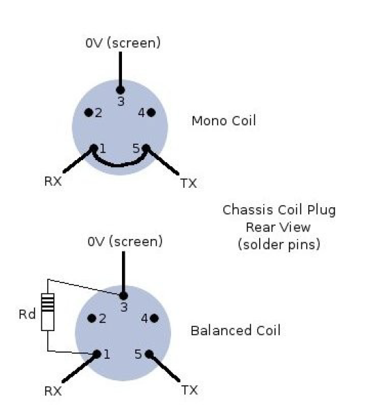

            Thanks very much for the reply - I understand except the last sentence. Fig 14 of the MPP build guide shows me that the 2 ends of the coil are effectivly joined together as they enter the PCB (pins 1 and 5 are shown bridged)...

              Thanks for replying so quickly. It is fig 14 that has got me thinking! My coil is one length coiled 25 times and the 2 ends go up to the pcb. Here, according to fig14 they are effectivly joined together. So I got thinking- why cant I join them down at the coil and make that continuous with the central wire of a coax cable and then up to the pcb?

                Here is the connection diagram, one wire from coil to pos or plus of control board and one wire to shield or ground of control board. since your using a single mono coil and NOT 2 coils ( tx and rx) you will jumper the rx at the plug on the control board to the tx, still just 2 wires from coil to board.

                  Umm, so when you say just 2 wires travelling from coil up to the box you mean one of these is connected to the sheild I am wrapping around the coil I made. What is the second wire? I have the 2 ends of my coil ----- are you saying therefore I connect these together at the coil end and connect to the 2nd wire ??
                  Assuming the upper plug layout in fig 14 is at the box end then this sugests I send down to the coil THREE wires ie one to the shield and one to each end of my single coil?
                  I think I am not understanding something here and I can hear you lot saying -- its obvious!!
                  Please educate me further!!
                  Cheers
                  John

                      OK Dan, so if I hear you right - what I do is take the 2 ends of my single coil and continue them up to the control box with the turns as you say. Then at the PCB I connect them to pin 1 and 5 (which are then bridged according to fig14). Then in addition the screen around the coil - I solder a wire to this also down at the coil. I then send that wire up to the control box as well (and connect to 0v)? So all in all I will have 3 wires going from the coil end up to the PCB box? Is this correct?

                          Connect one coil wire to 1(receive), the other coil wire to 3 (screen), and the shield to 3 (screen), and jumper 1 to 5 at the connector as in fig 14.
