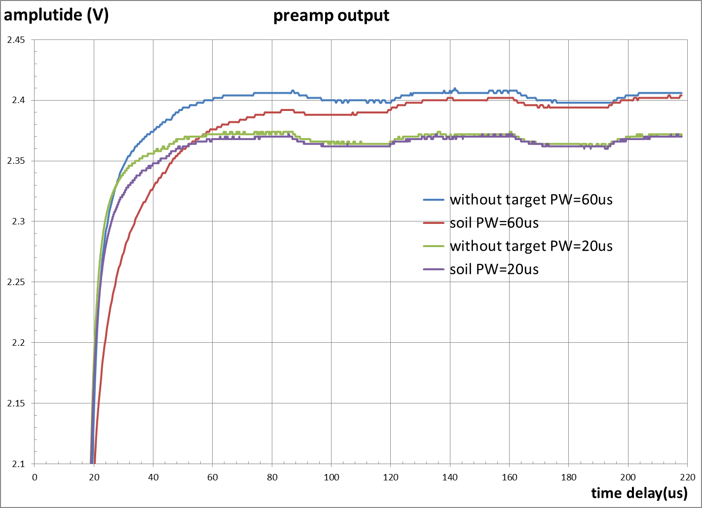

    can you decreese TX power (pulse width) and do new charts?
    here the soil response for pulse width=60us and pulse width=20us
    what do you think kt315?
    • #62
      perfect result! wow! that i waited ))))
      thank you
      • #63
        welcome kt315
        so you still think the problem is not mineralized soil or not?

            i use for preamp the ne5532 op-amp, the preamp is two stage with totally gain 1000 (gain 33 for each stage)
            • #66
              maybe lower gain would help you, my gain 200 - 400 NE5532 Philips
              • #67
                how the lower gain would help?
                if i decrease the gain i will decrease the device sensitivity

                    yes that is true but the totally gain with the next stages is the same range with the MPP which i use
                    i mean the decrease the preamp gain and increase the next stages (the integrator , final gain...ex) with totally gain is the same would not change the result
