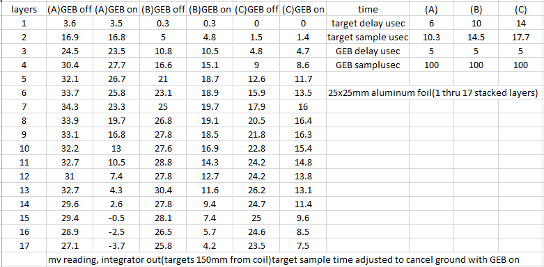

                  I would be interested also. Carl mentioned in another thread using layers of aluminum foil between 2 layers of clear packing tape to hold in place. A test using 25x25mm squares of regular aluminum foil with my detector(1C integrator). Recorded integrator out instead of distance because it's faster for me. Recording distance might be better since distance isn't linear with signal strength, closer to log. Changing delay time 6(A), 10(B) and 14(C)usec) and adjusting GB(target sample) to cancel ground effected how many layers caused minimum signal(hole). Need more layers for 10(B) and 14(C)usec delay. Cutting the foil to correct size and folding works best for me. 25x50mm folded once(2 layers), 50x50mm folded twice(4layers),as examples.

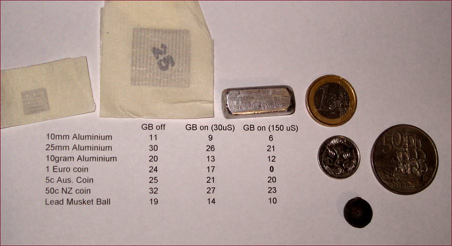

                    Since a few have asked about attenuation, I just ran some indoor tests (where there is admittedly a lot of interference) and I've come to the same conclusion I had last week - that it is so highly dependent on the settings that I cant give a clear answer.
                    eg. A 1 euro coin (although measurable at greater distances) gives a "decent" signal at 22cm with GB off, and a main sample length of 50 μS.
                    This does not change if I turn GB on and have a GB sample size of 30 μS. But that is a very low value and would hardly have any effect on ground. It could only be used where mineralization was almost non existent.
                    As the settings are turned up further for more compensation (more GB length and less sample length) the distance gets worse until at a main sample length of 20 μS and a GB sample length of 150 μS the coin is invisible. This represents the sample of highly mineralized soil I took from Wedderburn.
                    So whats it going to be for the soil where you live? Its a local issue, with attenuation results depending on the settings needed to get rid of the mineralization you have in your local area.
                    But that was a quick indoor test. I'll go out sometime in the next week or so and bury some objects for a field test.

                        If a 1 euro coin falls in the PI hole with target sample(20usec) and GB sample(150usec). What are a couple targets detected at similar distance with GB on or off with target sample(20usec) and GB sample(150usec)?
                          ok, more indoor testing, but for this one I put my "better" 8inch coil on for a bit more distance.
                          To get the 1 Euro coin to blank out with GB on, I had to turn the main sample size down to 17 μS, which is probably a bit lower than you'd want to use in the field. Also worth mentioning that even though the 1 Euro coin can go invisible, the effect varies across the diameter of the coil. If the coin was within 1 or 2 cm of the ground surface, you'd still detect it when the edge of the coil was over the top of it. It only went undetectable under the middle of the coil.
                          The "notch" to remove the coin from detection is also very narrow. At 17 μS main sample size it was invisible (with GB on, 150 μs), but at 20 μS it was being detected as normally as all the other samples.
                          Detection distances in cm.
                            To get the 1 Euro coin to blank out with GB on, I had to turn the main sample size down to 17 ìS, which is probably a bit lower than you'd want to use in the field. Also worth mentioning that even though the 1 Euro coin can go invisible, the effect varies across the diameter of the coil. If the coin was within 1 or 2 cm of the ground surface, you'd still detect it when the edge of the coil was over the top of it. It only went undetectable under the middle of the coil.
                            The "notch" to remove the coin from detection is also very narrow. At 17 ìS main sample size it was invisible (with GB on, 150 ìs), but at 20 ìS it was being detected as normally as all the other samples.
                            Thanks for the test. The 10mm and 25mm aluminum. Regular, heavy duty aluminum foil or something else?
                              The 10mm and 25mm aluminum... cut from a Red Bull drink can.
