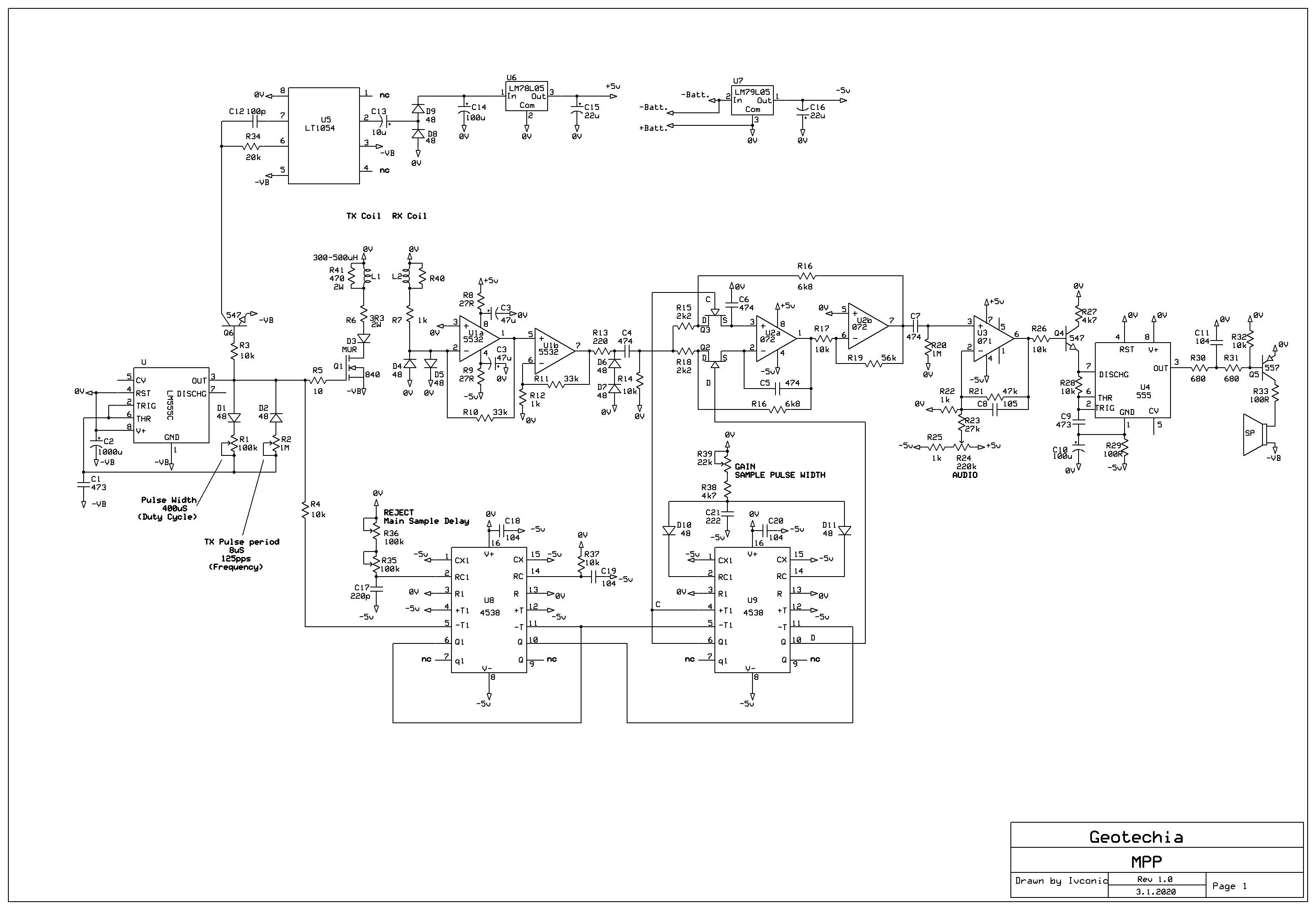

MPP Beach REV-E
  • Qiaozhi's clam that this can detect single coin in soil at 30cm attracted my attention.
    So i want to see the schematic.
    PROPERLY drawn Q. !!!

        Yes i know, you misunderstood me.
        I went on that page and downloaded all.
        Than i don't like the way how schematic is drawn; so i drawn my "vision" of how schematic should look like.
        Schematic i posted above is the schematic you posted on that link, just is drawn on my way. The way much easier to see and analyze it... at least for me. Can't tell about the others.
        I drawn that schematic today, between two posts.
        Also i don't like the pcb design (war crime it is), and decided to draw my own pcb too.
        It is shame that this design is not having GEB feature.

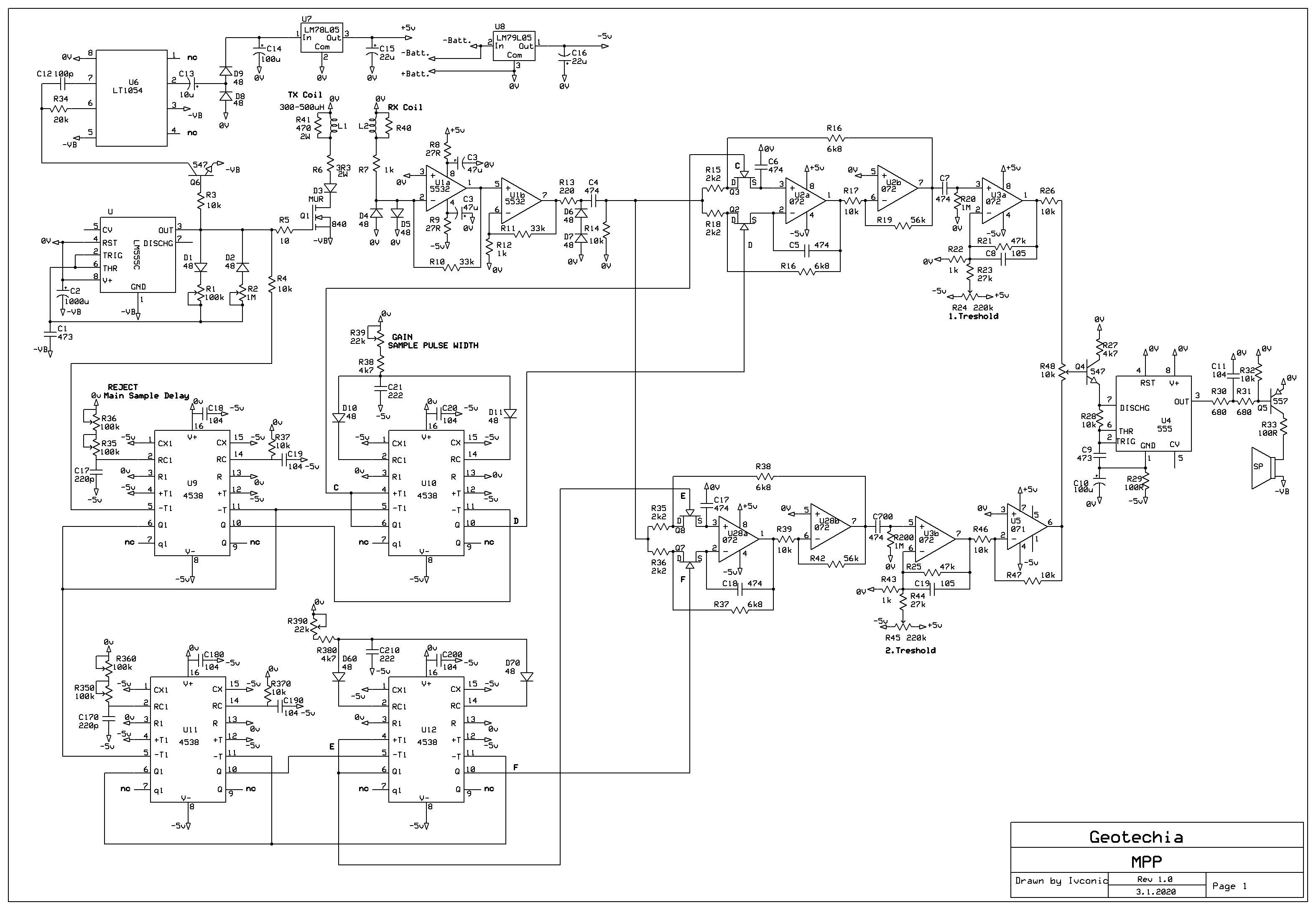

                • It would go something like this:
                  This is just adhoc Copy&Paste "projecting".
                  Now i would need real help from Qiaozhi or any other conversant fellow member to correct this schematic and make it proper.
                  This is just a suggestion.
                    [ATTACH]49014[/ATTACH]
                    Oh, wow I did not expect you to draw anything but thanks, so looks like we will be useing something like TDI, 4 sample system
                    • Let's face it; without GEB option: MPP still belongs to "small PI" projects like SurfPi and Barracuda ... and many other lookalikes.
                      Once you add it GEB; it will become serious PI.
                      Only correct and tested approach to do this so far is what Eric did on Gold Scan.
                      So i was skim adding that part, doubling the first channel.
                      Adhoc Copy&Paste, like i said.
                      Now it need more conversant expert to analyze this and correct few points.
                                Like this one:
                                [ATTACH]49005[/ATTACH]

                                Had a closer look at your well drawn schematic.
                                I have found maybe a mistake/betterment/other version of the MPP?
                                Take a look at the resistors around R24 (220k pot) AUDIO.
                                I am comparing this to version E of the MPP.
