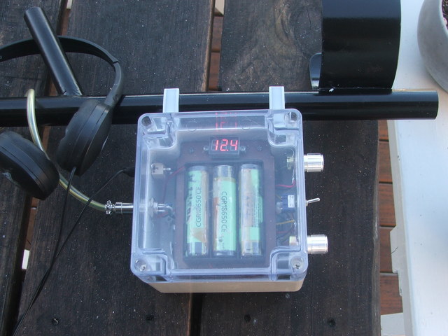

    I guess I must have the concentration span of a gnat as I bought the board for this from Silverdog several years ago and have only just got it to the stage of a working detector.
    Along the way several other detector designs have served to distract me, each having a different purpose in mind – a surf pi for beach wading, a Baracuda (still unfinished!), Pickini for snorkelling and micro experience, a still unfinished Pirat and an assortment of test equipment and various coil designs.
    It’s hard to say what I enjoy most about metal detectors – the challenge of building the electronics or the the simple pleasure of getting away from it all on a beach or around an old ruin or gold mining area just poking around ‘looking for stuff’, but the part I have to push myself with is the hardware. Needless to say, this part seems to end up pretty basic. As long as it serves its purpose I am satisfied.
    And my MPP is no exception.

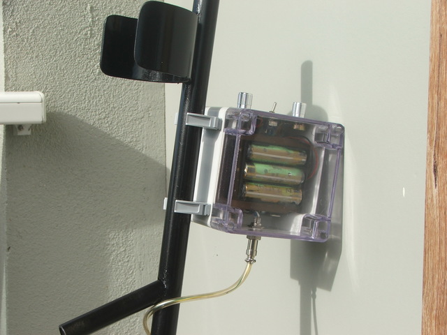

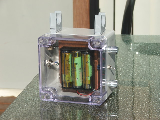

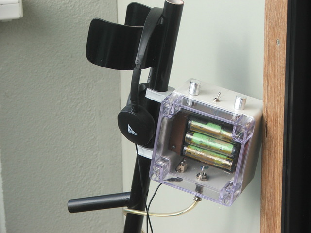

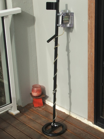

    Most of it is made of 20mm PVC electrical conduit made to look almost presentable with a spray of
    black acrylic lacquer. Still, it feels well balanced and the whole thing only weighs in at 1.2Kg including the coil, control box and batteries.

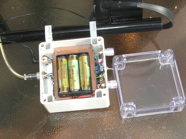

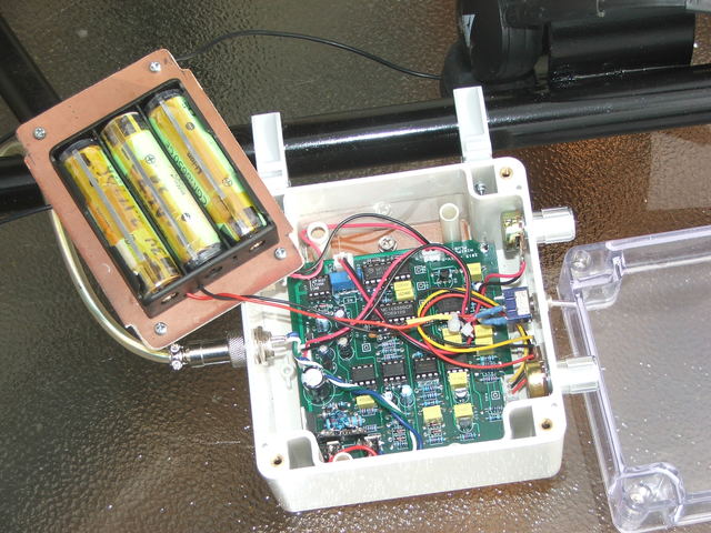

    The electronics are sandwiched between a couple of sheets of copper clad pcb to provide some shielding (yet to be connected up) and the 3 Li cells (ex laptop battery pack) mount onto the top pcb shield for easy charging access. I plan to add an led voltmeter next to them to monitor their state of charge. I have also fitted protection boards to each cell. The cells are individually charged in a Nightcore charger so they should remain balanced.
    From the photos it can be seen that the control box is mounted to the shaft using plastic conduit clips which enable the configuration to be easily adjusted by clipping it to a different position.

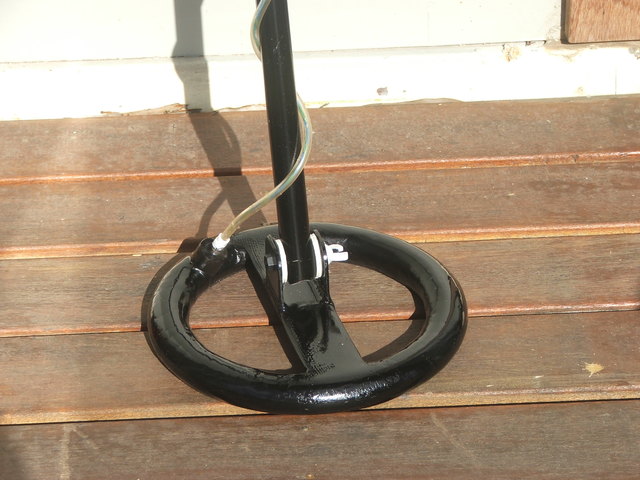

    The coil is a 3DSS wrapped with polyethylene packaging foam and then glassed with epoxy resin. The feedline is twisted pair fed through clear plastic tubing.
    So, thanks George for a really well presented project with most comprehensive instructions.

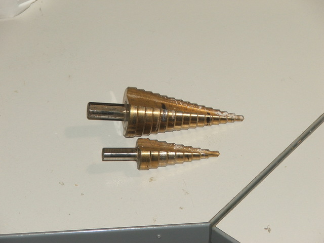

    Looks good , how did you get the angle on the handle if its made from pvc ? is it drilled and glued ?
      Yes, I just drilled the 20mm conduit at an angle using a stepped drill and fitted a short length of smaller diam for the handle.
      I think it was 10mm electrical conduit from memory. I shaped the bottom of the 10mm tubing to roughly match the inside profile of the 20mm stuff using a sanding disk and then used plenty of PVC plumbers adhesive to hold it all together.
      If given plenty of time to dry it turns out quite strong - more glue can always be added to fill any gaps. The old gluggy stuff is good for this!

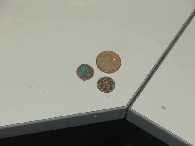

              I did manage to get down to the local beach last night for a brief 'play' before the rain started and came back with a few coins -
              So it definitely works!

                LED Voltmeter fitted.
                This serves as a power on/off indicator as well as letting me keep an eye on battery use. Cost just over $AU1 but I have not checked accuracy yet!

                  Watch the current draw on those led voltmeters.
                    Thanks for the kick in the bum to check this - I thought about it earlier but, as usual, got too distracted to do it at the time (nice weather here today so I spent the time checking my backyard bee-hives instead!)
                    Anyway, it appears to draw about 10.8ma at 12V which does not seem too bad.
                    When I was taking the photo I noticed the led segments flickering in the viewfinder of the camera so the display segments are obviously multiplexed and this would help to reduce the current drain.
