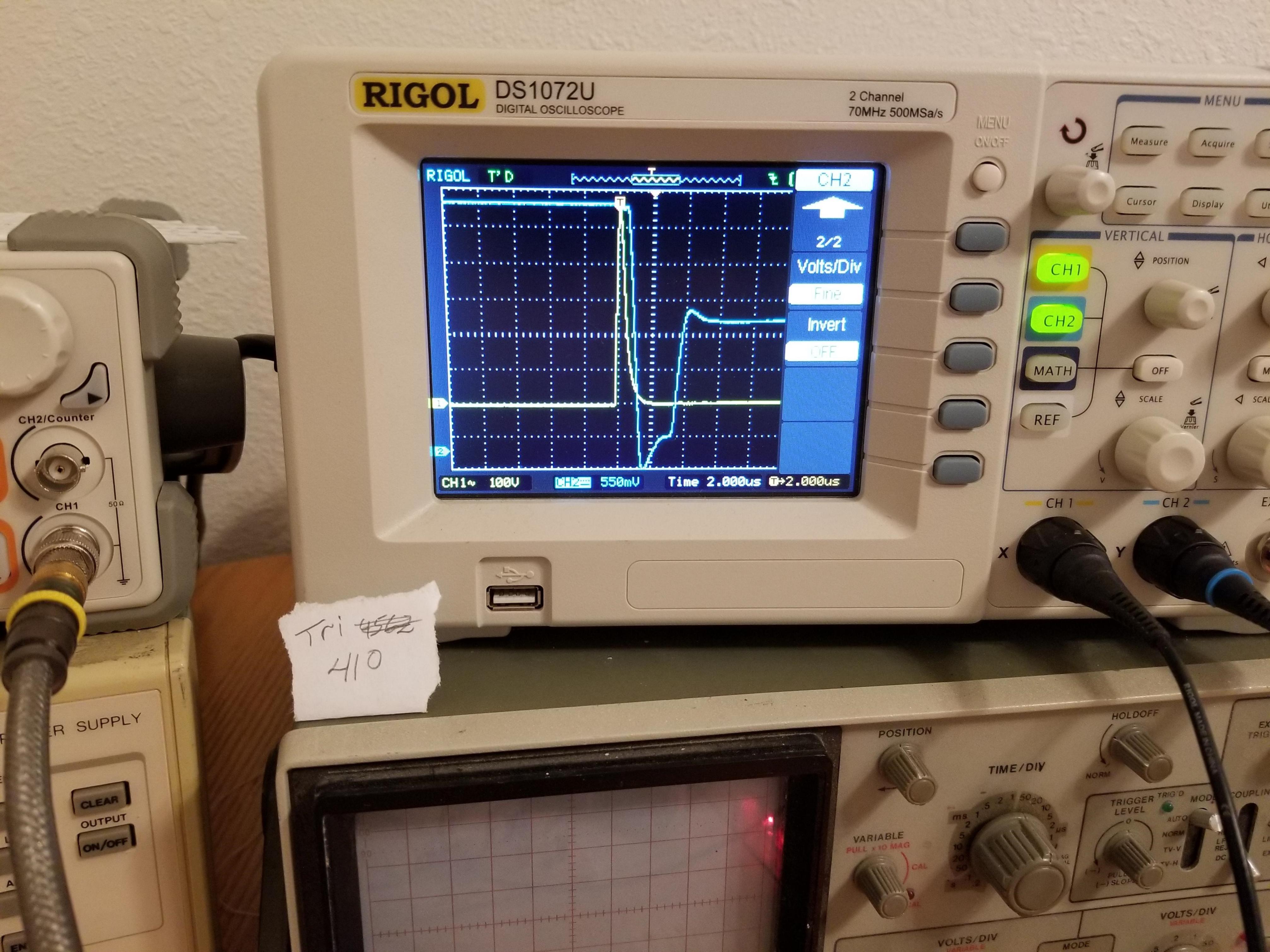

    I made the changes and added the 410 here is the 3 stage amp with the 410 and the filter caps.
Name:	3 stage with 410.jpg
    You guys can see its slightly under damped ( I like it that way)but looks allot better.

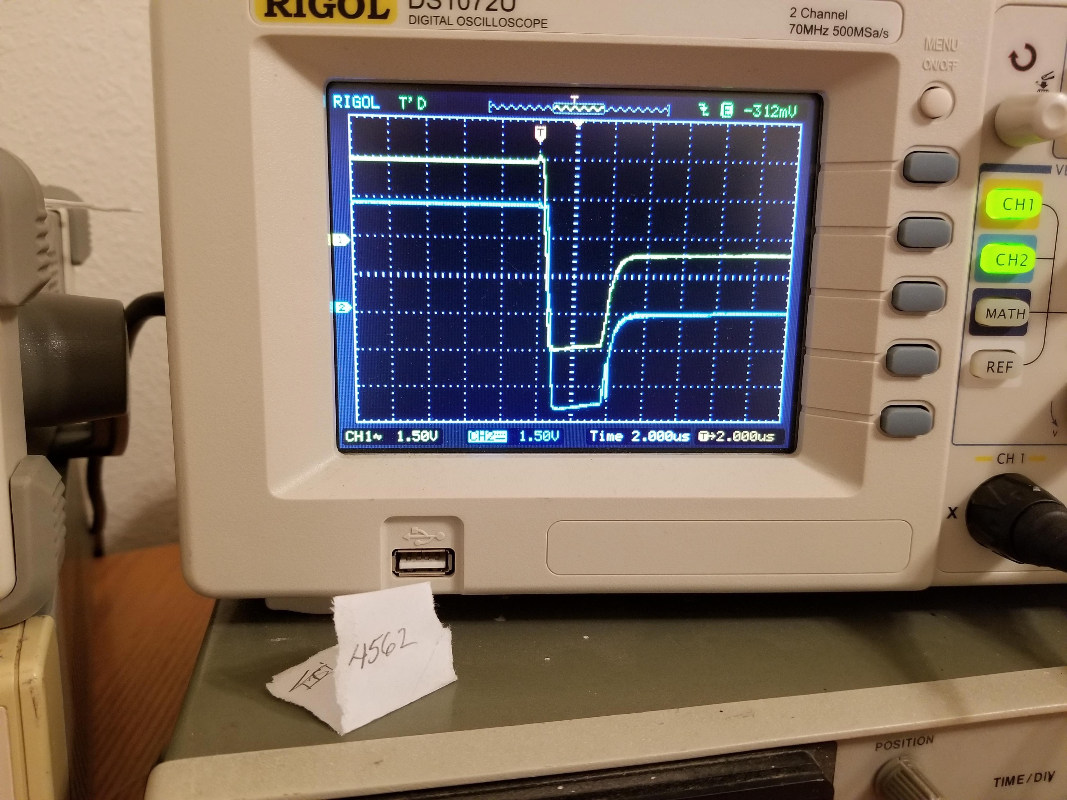

                If your still looking into this three amp set up I think I finally got it and the 081 is far superior to the 412 with this set up, the 412 is just as fast but did not like the diode much.
                I tried a couple things cap on the feedback resistor , adding input resistor between amp 2 and three but Bat 85 seems to be it.
                I'm still learning but it looks like first sample at 3.7 us "'ish" .
                The threshold problem is gone solid as ever 1/4 by 1/4 beer can side distance doubled, gold samples all better.
                Here is scope shot Channel 1 yellow 4562 two stage.
                Blue channel 2 081 with the diode.

                  • first sample at 3.7 us "'ish"
                    close enough

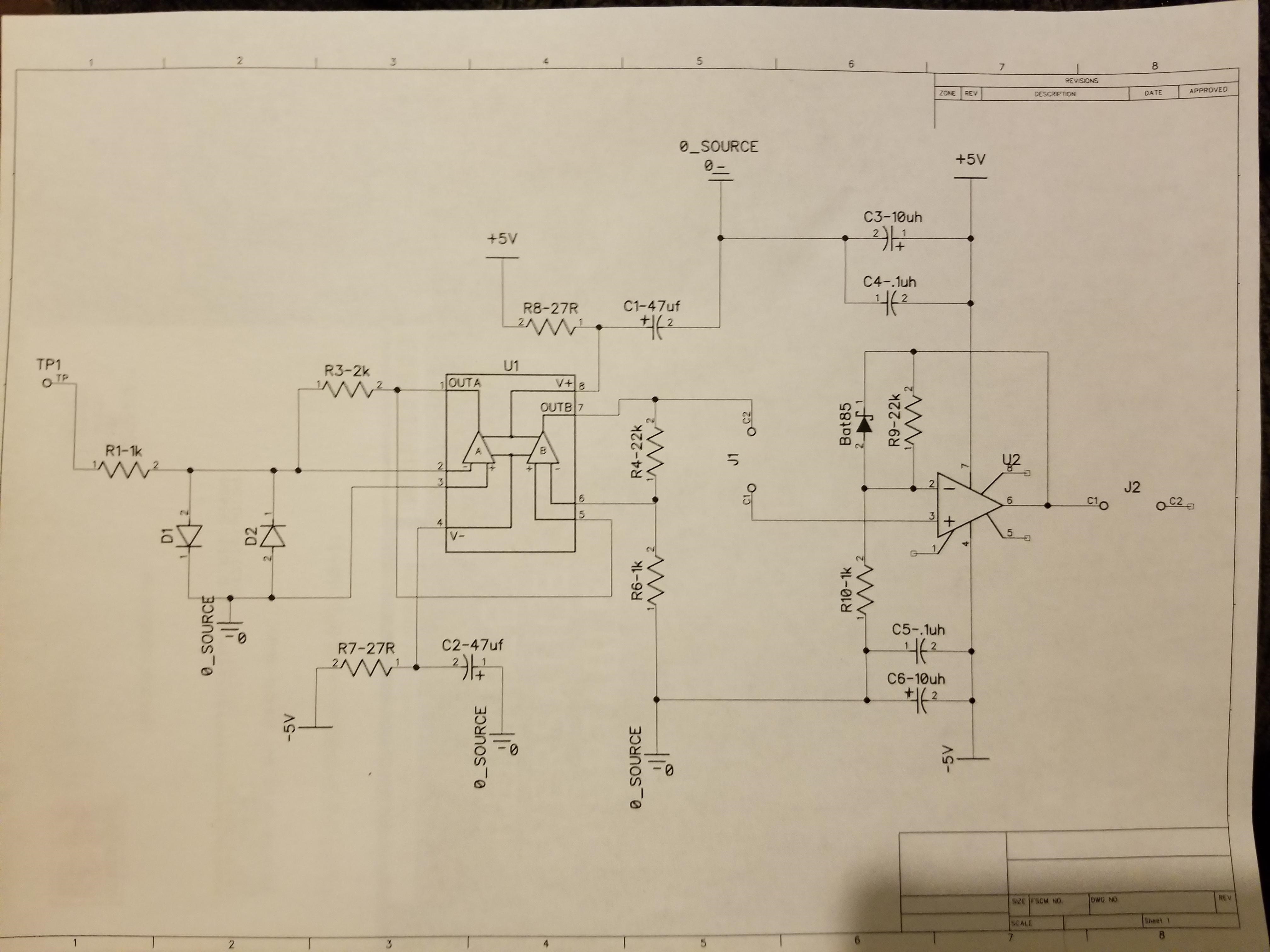

                    if you get the chance could you scribble down your circuit, thanks.

                        Here is the Schematic I built to.
                        The first two stages are the MPP preamp .
                        I'm not sure why Telano had switched polarity on amp 2 but I built to the Mpp Schematic on the first two stages.
                        The filter caps at C6 and C3 should have been 6.8 uf tants but the 10 uh electrolytic were closest thing I had.

                        I haven't had time to test it much more but did try a 4562 as the third amp, Ill get some shots tomorrow of the 412 and the 4562 tomorrow.

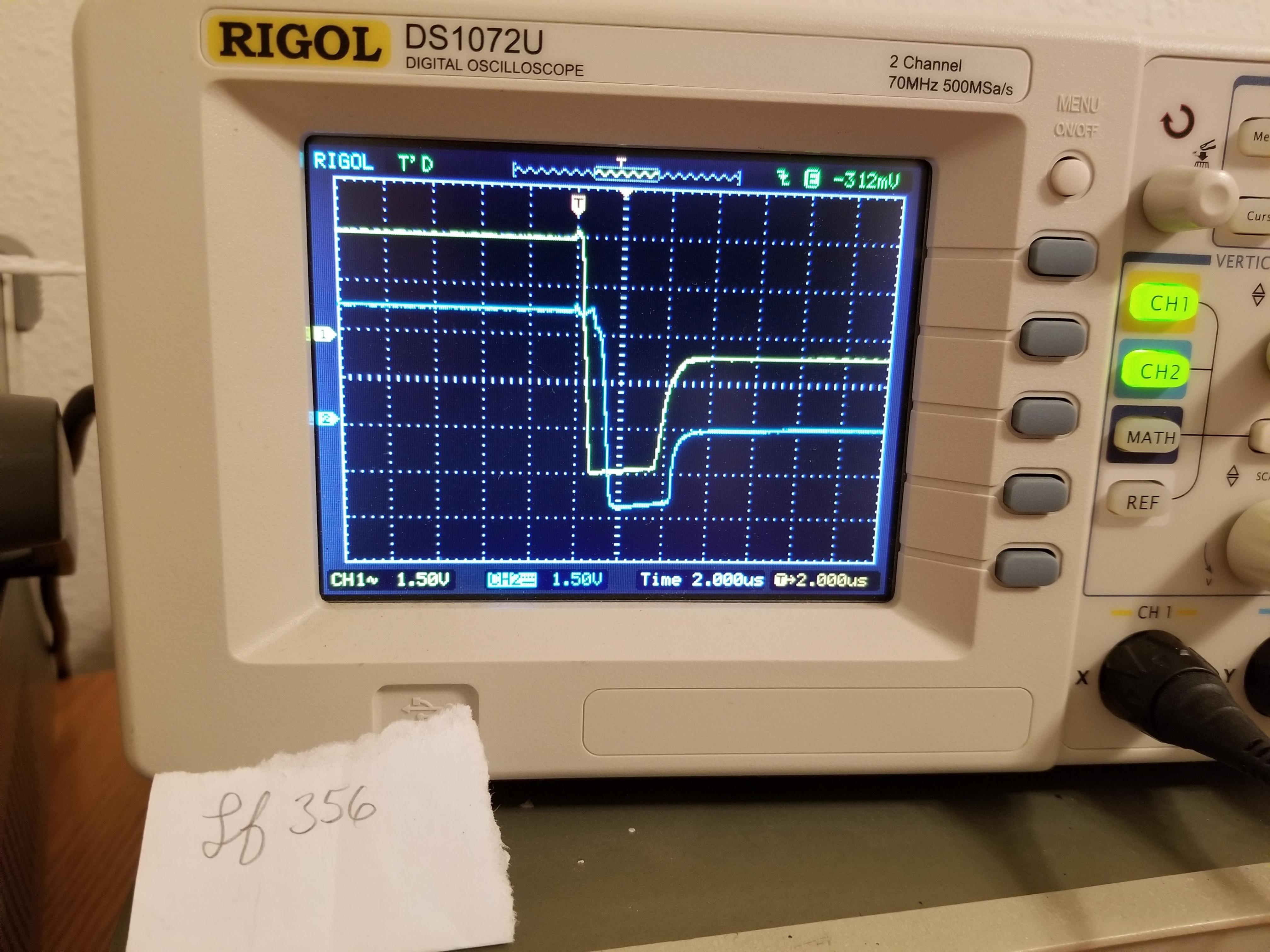

                        • Thanks for the info, do you have a LF356 to try for #3 op amp
                          • I found a couple LF 356's in my stuff, they are old and I got them at a estate sale so I tested both to see if one was better than the other.
                            But both acted the same so I think they are alright. The wave form is a little funny and sensitivity went down.
                            Iv'e been doing a quick target test with a 1.2 gram nugget a 1/4 by 1/4 can side and a nickel .
                            Here is the 4562-356 paired.
Name:	4562- lf356 combo.jpg

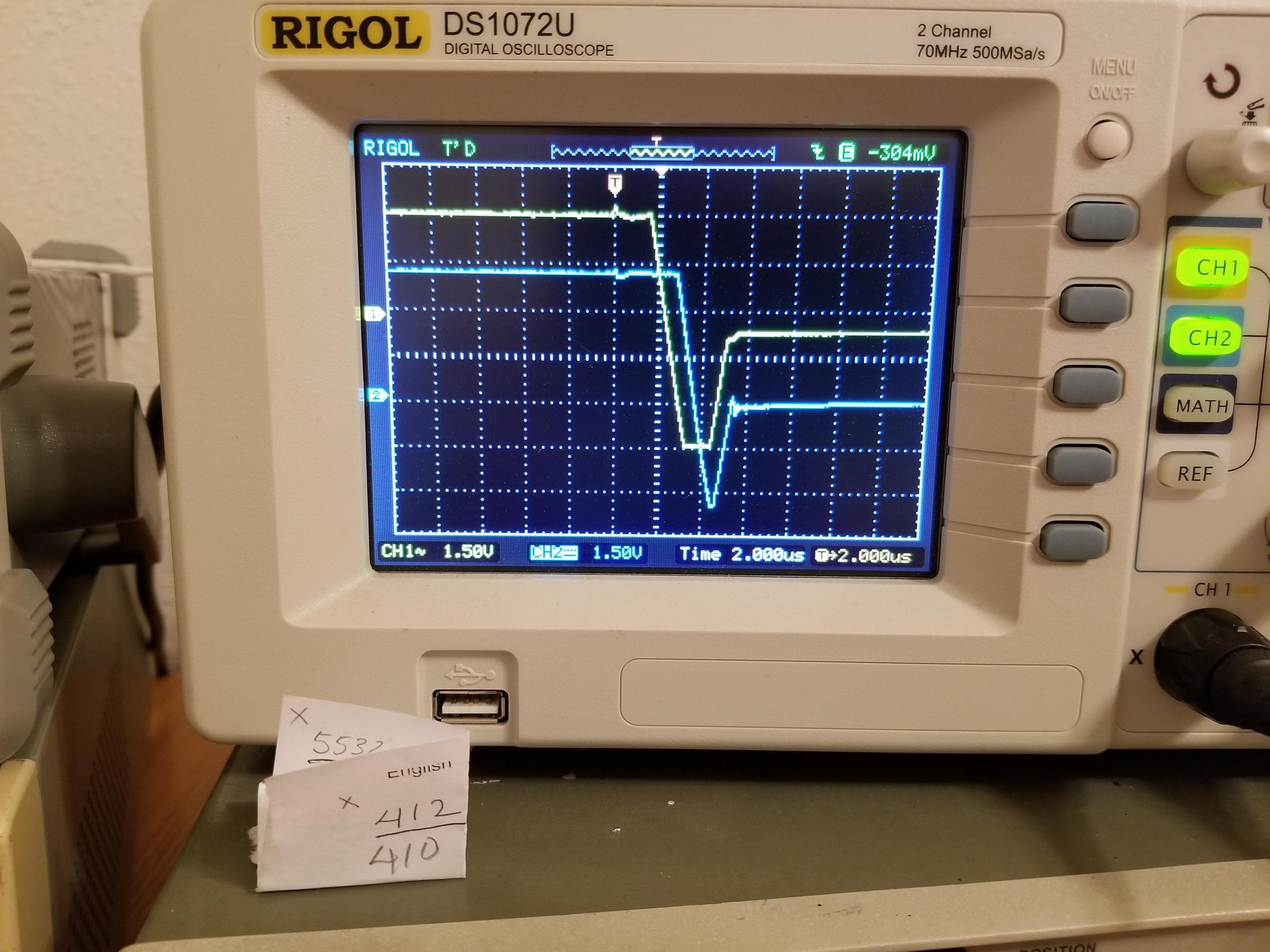

                            I tested some other pairs as well to see what would happen.
                            The 4562 as a lead amp is the fastest but the 412- 410 combo is interesting.
                            If the turn off wasn't so slow it would be great, Maybe a diode on the 412 ?
                            As is its performance is right up there with the 4562-081 combo.
Name:	412-410 combo.jpg

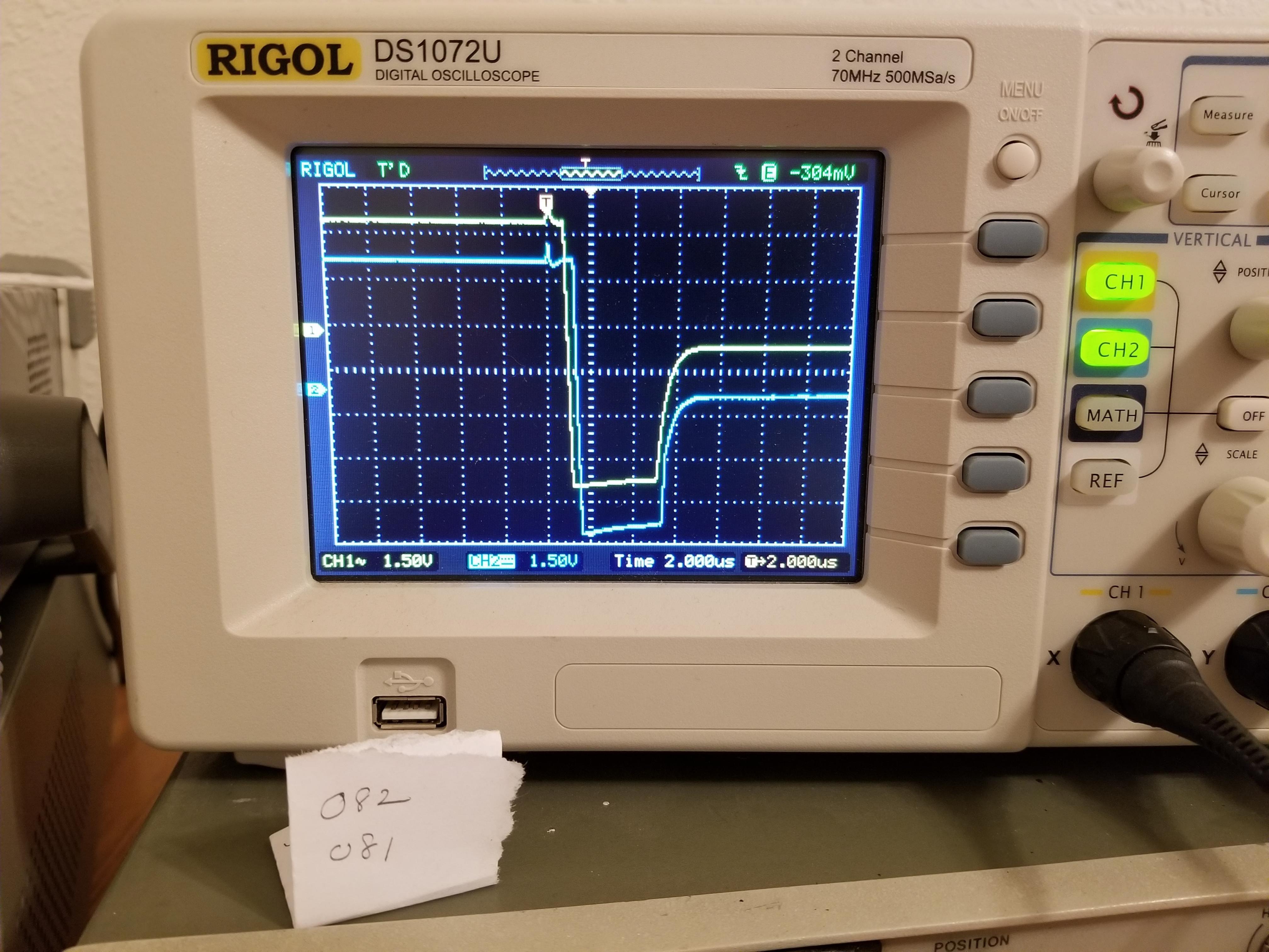

                            Here is the 082- 081 combo
Name:	082-081 combo.jpg

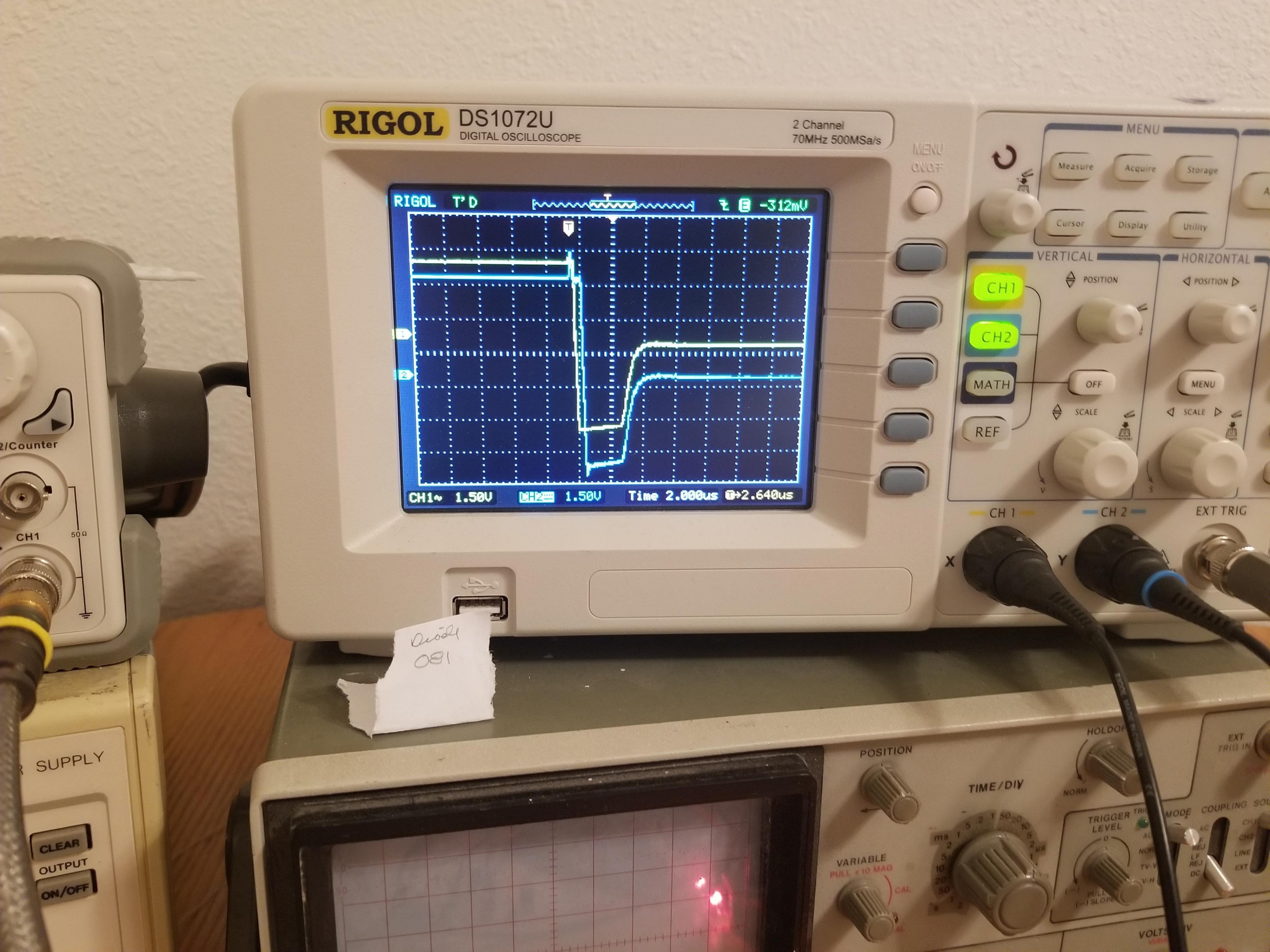

                            4562 -1/2, 4562 pair
Name:	4562 -4562 combo.jpg
                            On each amp I'm getting a spike at turn off with the 4562 pair its moved into first sample area.
                            Its before or right at where I can first sample at this point so I'm not seeing any effects I can tell.

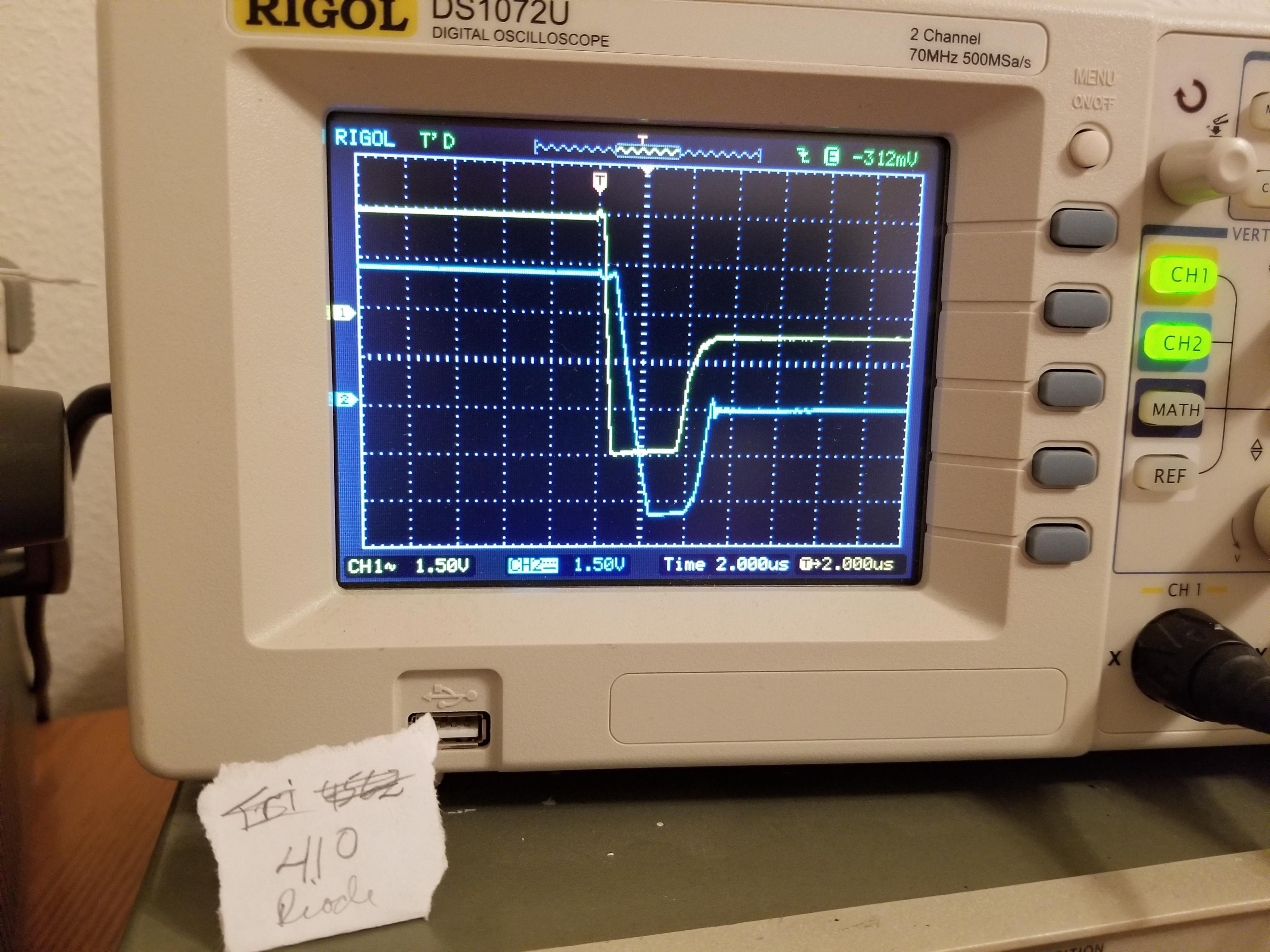

                            The last combo is the 4562- 410 pair.
Name:	4562-410 combo.jpg
                            I don't know if we can find a way to pull down the 410 -412 amps faster or if its a product of their design but the turn off seems like a trade off for less saturation time.
                            Is their any gain to a trade off in this way ?
