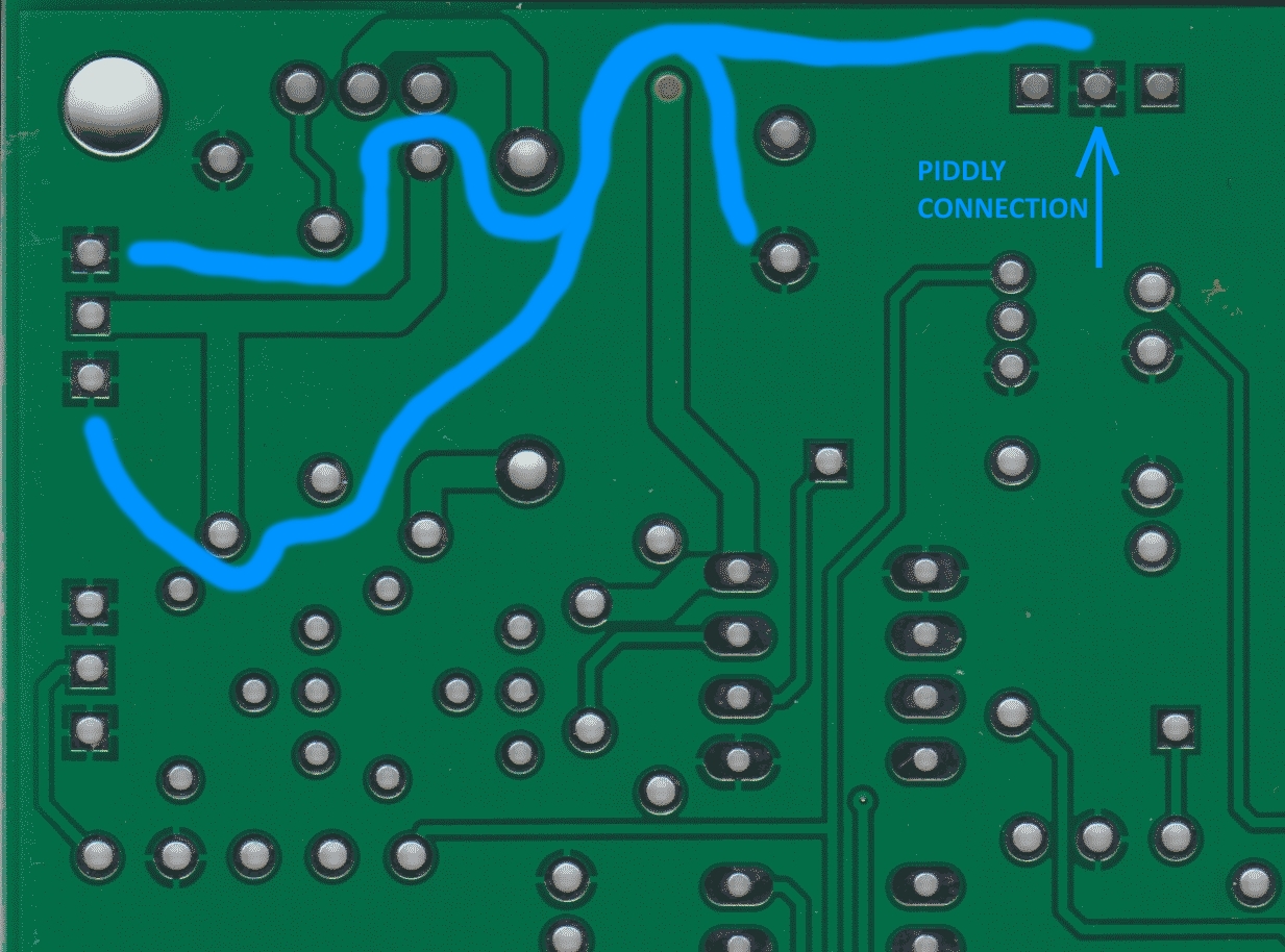

    I have been reading a lot about having a solid ground connection and no daisy chaining power rails.
    What has me wondering are the piddly little connections to the ground plane from the pads.
    There are usually four of them to a pad. Is this enough for a "solid" ground?
    Is this intentional? Why not have the pads solidly connected to the ground plane, I mean complete copper connection all round the pad?
    The ground plane also looks to be interrupted by many traces. The way back to "mother" ground looks like a run through a maze.
    Is there maybe a third PCB layer of contiguous ground inside the PCB?
    Here a close up picture with the piddle pads and also possible return paths for Tx coil electrons.

    Hi Polymer,
    It is standard board design practice to connect pads like this to large copper areas (generally ground planes) and it is done mainly to enable reliable solder joints.
    Without them, the amount of heat required to solder to ground plane areas increases quite dramatically and then you run the risk of overheating some components.
    The MPP board shown is layed out quite well..
    When it comes to signal grounding and low noise design, shortest route is best and the so called "star" grounding method is often used, the current from each ground path meets at one point only.
    Then you have partitioning of ground area methods too, all this helps control current paths to ground in an effort to keep noise down, among other things.
    On the flip side, things like the TX Tank cap also require short & fat traces to help reduce the nasty high current switching noise

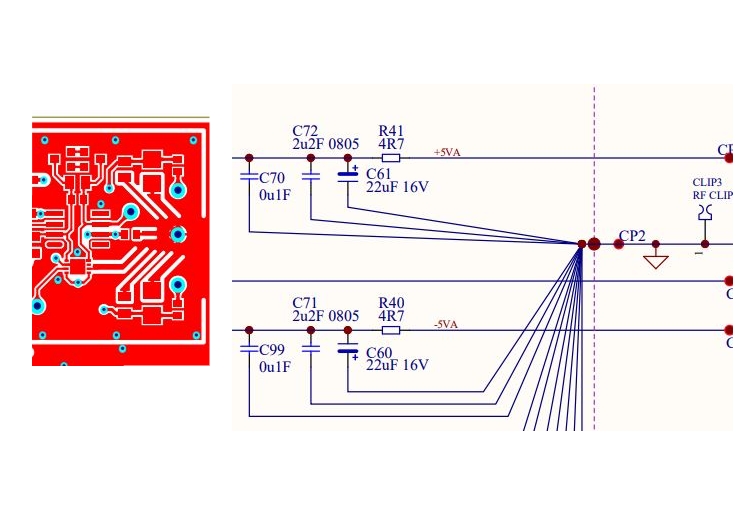

    Here is a snippet of part of a star ground on one of my boards (not MPP)
    cheers
    Mdtoday
      Mdtoday

        Hi Godigit1,
        Thanks and yes, it really does help and in particular around the front end amp stages, of course, it becomes hard to get all of the signal chain to same point (and not all needs to be) but then that's where partitioning of the ground plane helps.
        It is an extension of the star ground method in a way.
        Cheers
        Mdtoday
          Hi Mdtoday,
          Ha, you're a Star! Thank You for your concise description and your star example.
          It now makes sense to me. Easy solderability is important, especially to beginners like myself.
          Would putting in a wire from Tx Return connection directly to the cap benefit much?

              Hi Mdtoday,
              You could do this but in this particular design, it is ok, you can't get the cap any closer to MOSFET, although I would have had thicker tracks and separate return right back to power connector.
              Having said that, the layout is fine for the Tx pulse current in this design, I would not go hacking the board.
              if you want to look at experimenting, lift the tank cap leg that is connected to return and connect a wire from it directly to power input connector area...I don't think you will see a lot of difference but this is the way to think when designing layout.

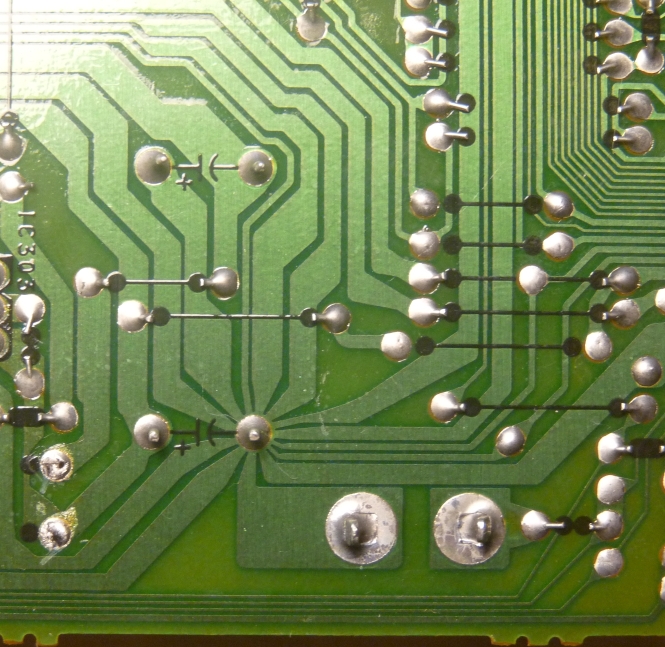

                      Found an old banged up Sony stereo on the side of the road from the 80's. Couldn't resist.
                      The insides have lots of nice components for experimenting and in sizes I can handle without a magnifier ...
                      Anyway, I found a lovely star ground connection on one of the PCB's. What a work of Art!
                      Here's a picture: Click image for larger version
                        Wow, now that is a star.
                        Great find for usable parts.
