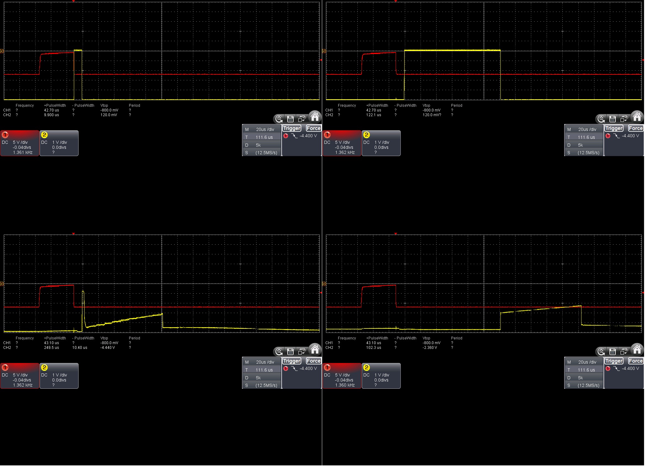

    I have gotten stuck at STEP 6 on George's test procedure.
    TP6 Main sample delay is 10us ==> OK
    TP8 Sec. sample delay EFE is 120us ==> should be round 100us, not sure if OK
    TP9 Main sample pulse width looks rotten
    TP10 Secondary sample pulse width, looks OK but maybe too wide @15us
    Here is a picture of all four measurements.
Name:	MPP rev E TP 2 vs 6_8_9_10.jpg
    What could be wrong here?
    I have replaced the TI CD14538BE, no change to be seen.

    I assume you have shorted pin 2 of PL5 to either pin 1 or pin 3, as the main sample pulse delay is correct at 10us. Have you also shorted pin 2 of PL6 to either pin 1 or pin 2, as stated in the Build Document?
    The secondary sample delay is set by R32 (10k) and C18 (10nF), which gives 10E3 * 10E-9 = 100us. If you're not using components with a low tolerance (such as 1% resistors) it is conceivable that the secondary delay could reach 120us.
    The main and secondary pulse widths should be identical, and are set by R35 (4k7) and C19 (2n2), which gives 4.7E3 * 2.2E-9 = 9.68us. However, D10 and D11 also have an effect on the timing such that the actual value will be higher than 10us.
    If the R and C values are definitely correct, I would suggest fitting a 25k pot to PL6 to check if the sample widths can be adjusted.

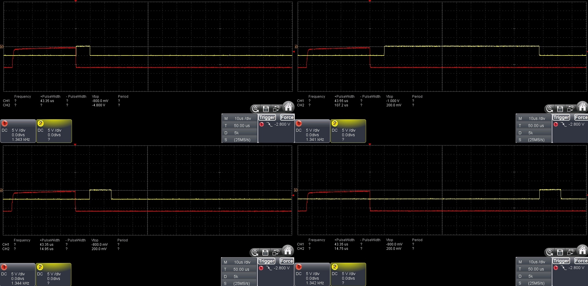

      Thank you George!
      Yes, I had shorted pins of PL 5 and 6. In the new following oscilloscope pics I have put in a pot on PL6 - the width IS adjustable.
      I am using 1% resistors. I measured them all before placing. Same with capacitors except the tolerances are 2.5 to 10 %.
      The main and secondary pulse widths are identical.
      The shape of the main sample pulse width still looks unhealthy to me (TP9). Looks like something is awry here.
      What is your take on this shape?

        That definitely doesn't look right.
        Are you sure you're taking the measurements with reference to the +ve battery terminal, which is treated as ground (0V) in this design?
          If the third scope capture is on TP9 then it is not correct.
          Re-check the parts installed around U10a. Ensure that D11 in not backwards, etc.
          Use a good magnifier to look at the soldering. Ensure all solder is flowed well and no shorts.
          The other scope captures look good.

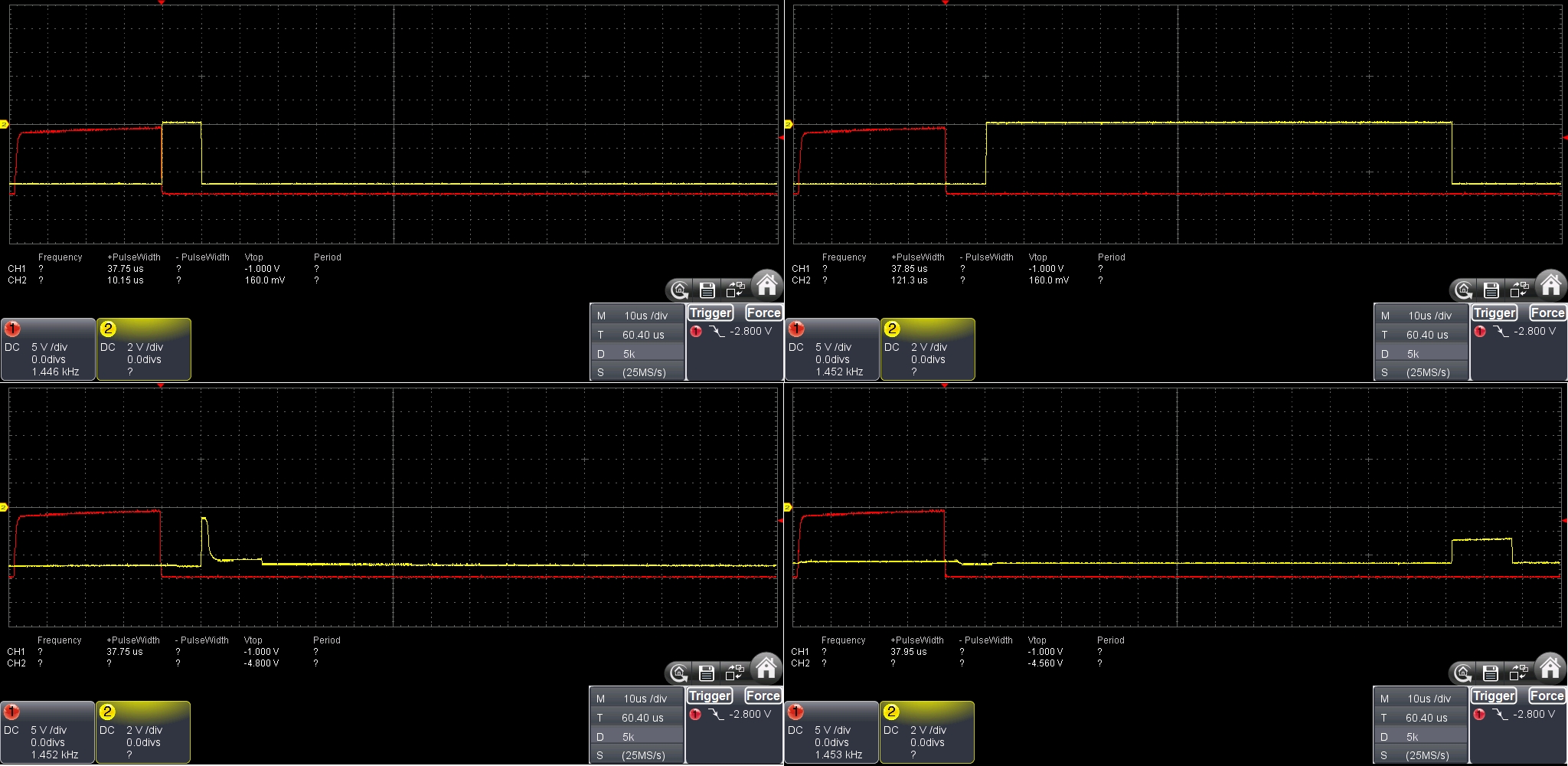

            Uh, oh - my mistake writing vs. TP2 in previous posts/pics. Mixing up 2 & 5 is a weird thing.
            Yes, I am measuring vs. TP5 (ground, which is + of 12v supply)

              Now it looks right:

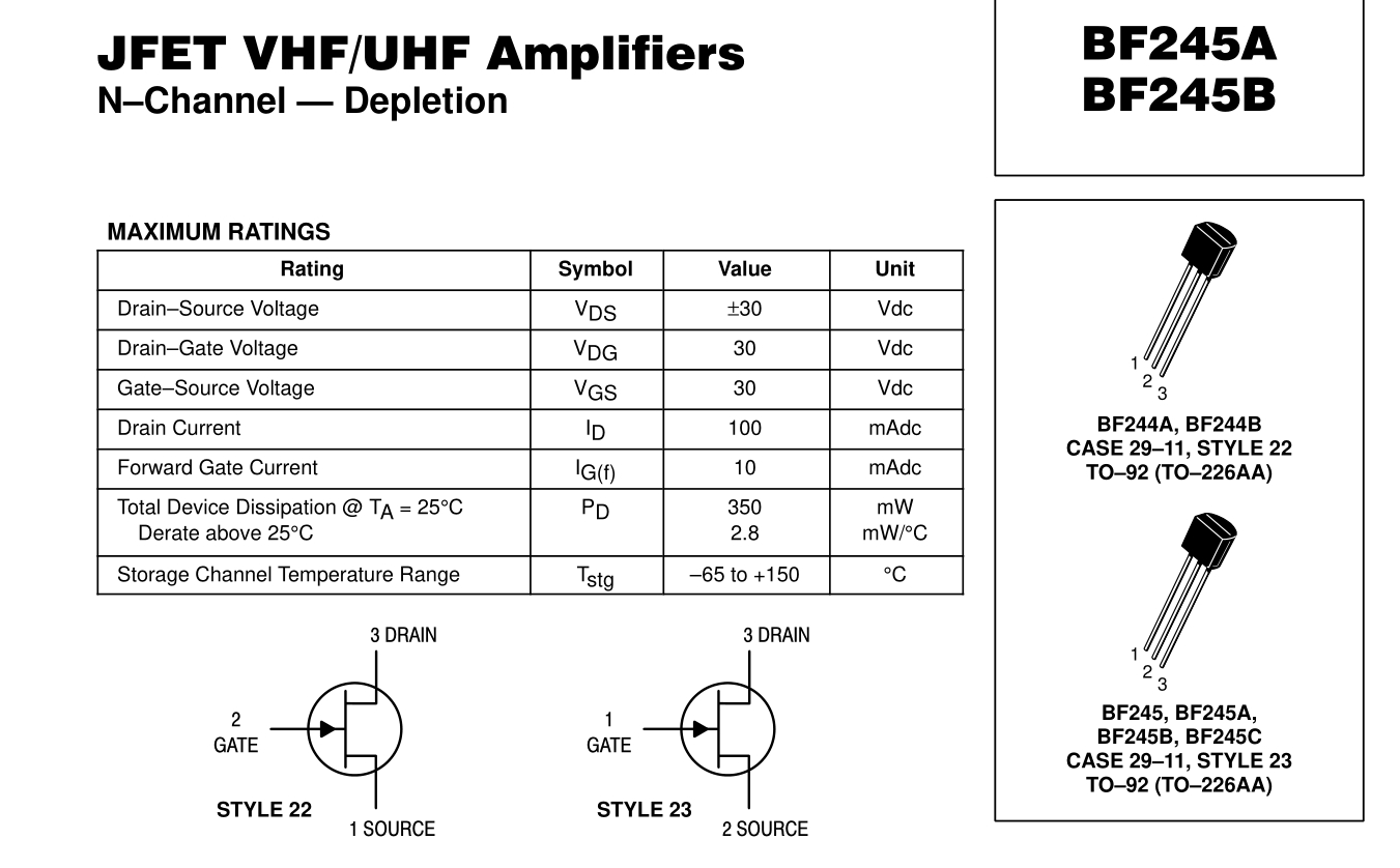

                  The J-FETS were "bogging" down the signal. Mine had different pinouts, so were incorrectly inserted.
                    Ahh... I had the same problem on my first PI detector build. Forget to check the pin out of the JFETs I bought verse the ones I designed for.

                          Here's a jfet data sheet that is made by mischievious ... errrr, data sheet makers - at least that's how I see it.
                          I found this one difficult to decipher at a glance, it's prone to misreading ... could have been done better.

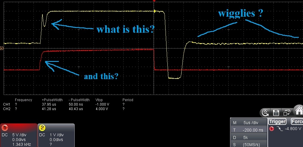

                          Step 5 Rx Preamp:
                          Here's a scope pic of my Rx out, that would be TP3 and reference curve is TP2.
                          Some things look funny to me. Is it normal?

                            The slower rising edge on TP2 seems to be the MOSFET gate charge. the dip on the TP3 rising edge may be the slow gate signal plus the diode, D7.
                            The rising edge of the Coil drive (TX) is not too important. The falling edge (end of the TX pulse) is sharp and is the important edge.
                            The wiggles is simply Noise picked up by the coil and amplified by the pre-amp, Gain = 1156.
                            In your house will be noisier due to AC mains and the Integrator & SAT circuits will remove a lot of this.
                            Once you get outside and away from AC Mains noise this will be better.
