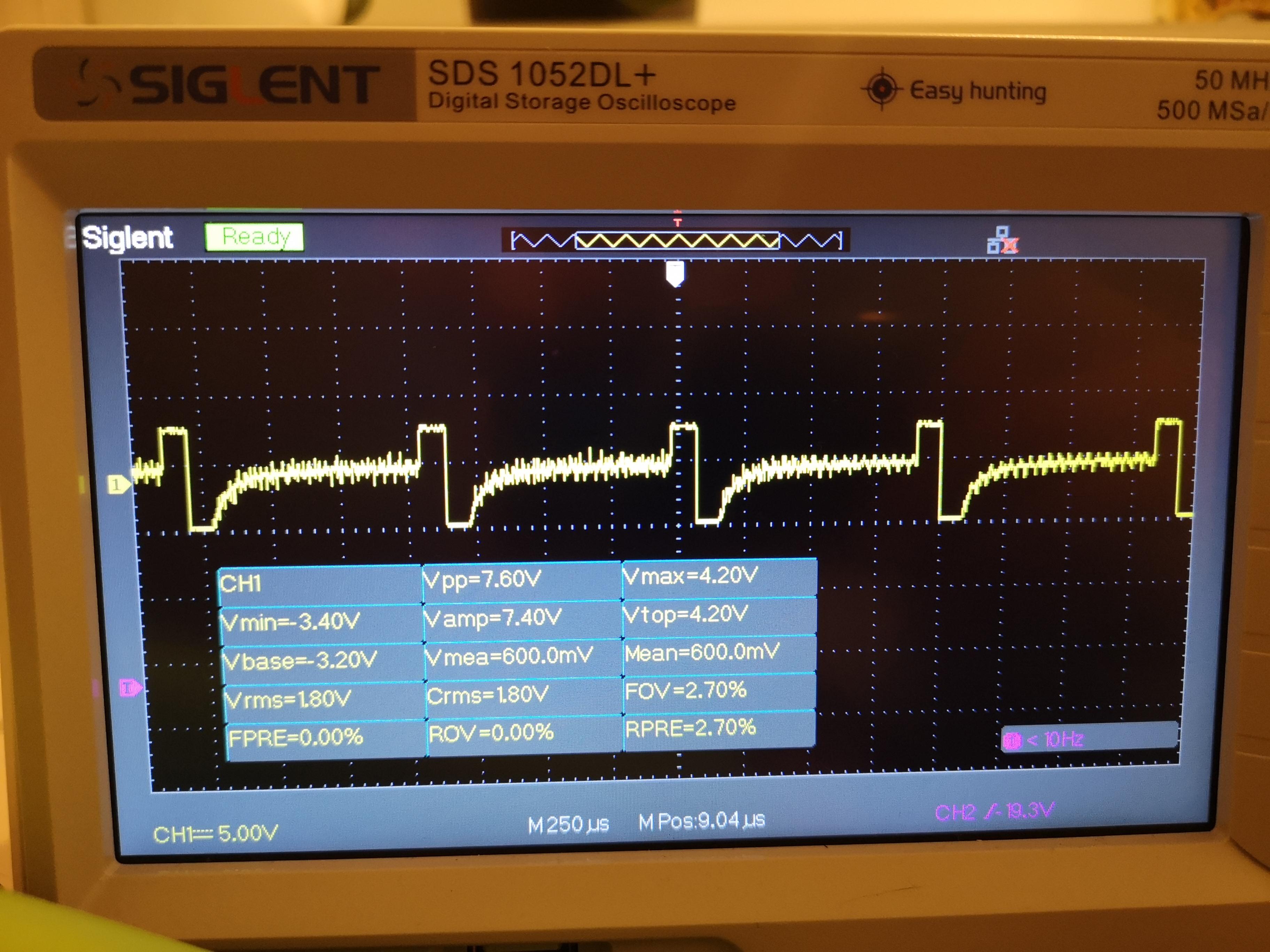

        Can you post an image of the pre-amp output at TP3?

                      How did you shifted main sample pulse more right? In my circuit TP6 like this picture
                        Looking at your photo. It appears your Tx pulse is approx 400us based on your scope setting of 250us/div, This is not correct, it should be around 100us or less, Check all the capacitors and resistors around the NE555 timer U1. Maybe you used a 470n when it should be a 47n? I think if you fix the tx pulse your other problem with the first sample will be solved

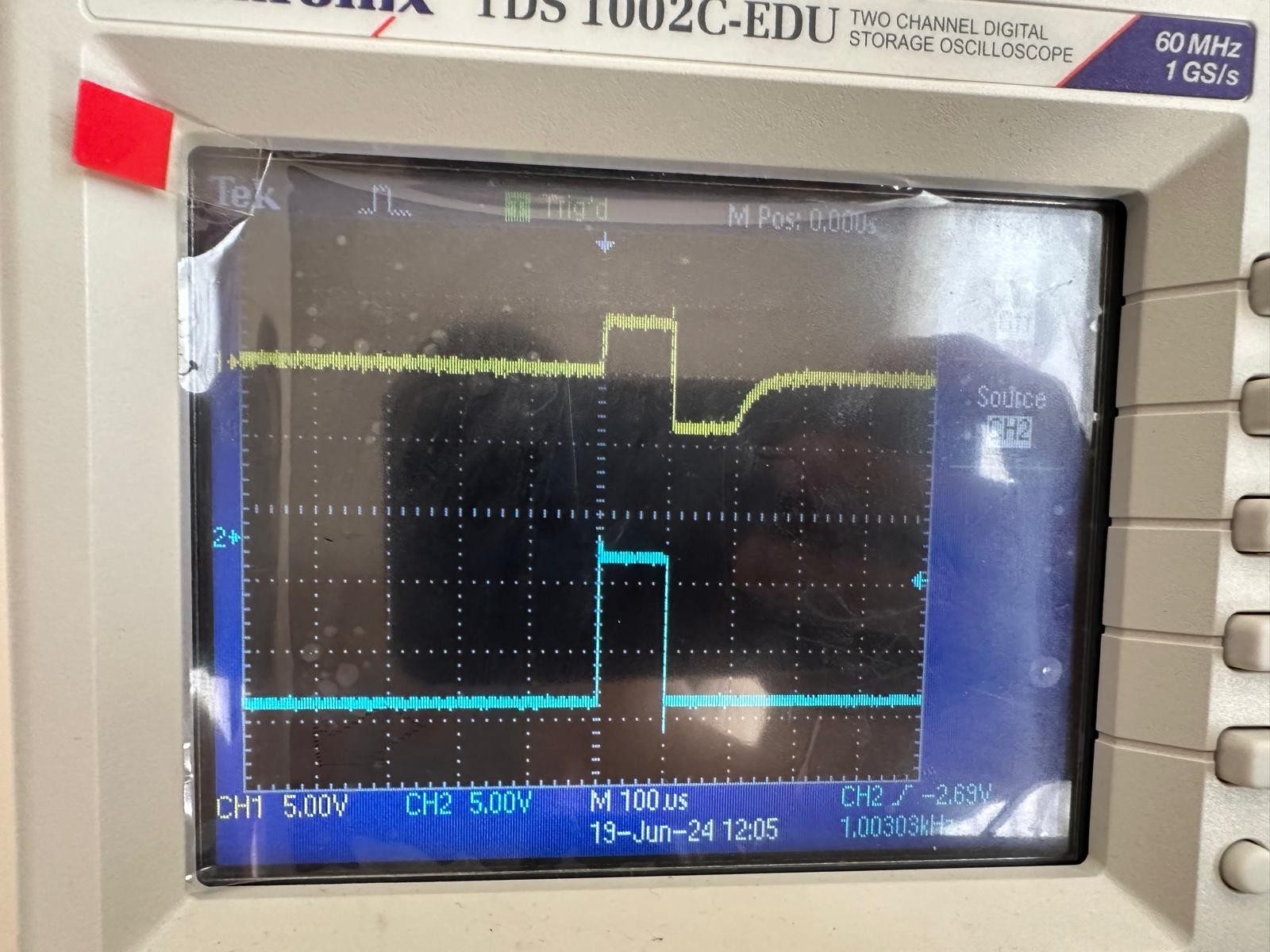

                          tp3 and tp2 like this. it is 100us pulse and 1ms period.
                            tp3 and tp2

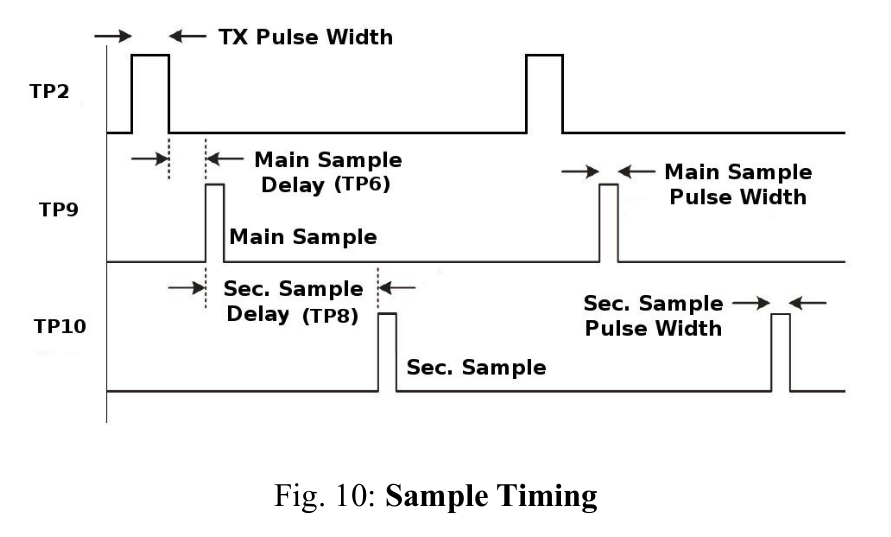

                              I think you may be confused about the sample timing.
                              TP6 is the sample delay, and TP9 is the main sample.
