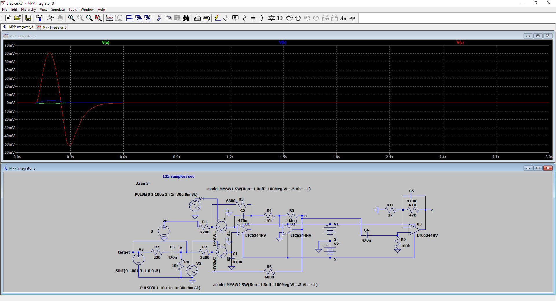

                Trying to simulate integrator with spice. Doing something wrong. Could you attach a scope picture of (TP3 and TP4) and (TP4 and TP1) while swinging the target across the coil.
                        See what I was doing wrong. Scope pictures not needed. Thanks
                          My spice simulation. Wasn't thinking earlier, needed to jumper R7 C3 for simulation. Changed R9 to 100k like waltr suggested. Increasing R5(1meg higher than needed?) seems to help with simulation. Changed C5 also. Not sure simulation is same as detector.
