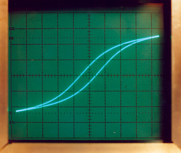

              Is there a way to measure core saturation? Maybe connect a 1 ohm resistor from +battery to coil and scope Tx on current(voltage across coil).
                It's tricky, as you would really need to plot the B-H curve.
                      Here's some food for thought:
                      https://www.nutsvolts.com/magazine/a.../probing_cores
                      Taken from the above article:
                      "typical core materials show a straight line which curves towards the horizontal at both ends (see Figure 1). The curved tips show the core's permeability falling at high currents." End quote

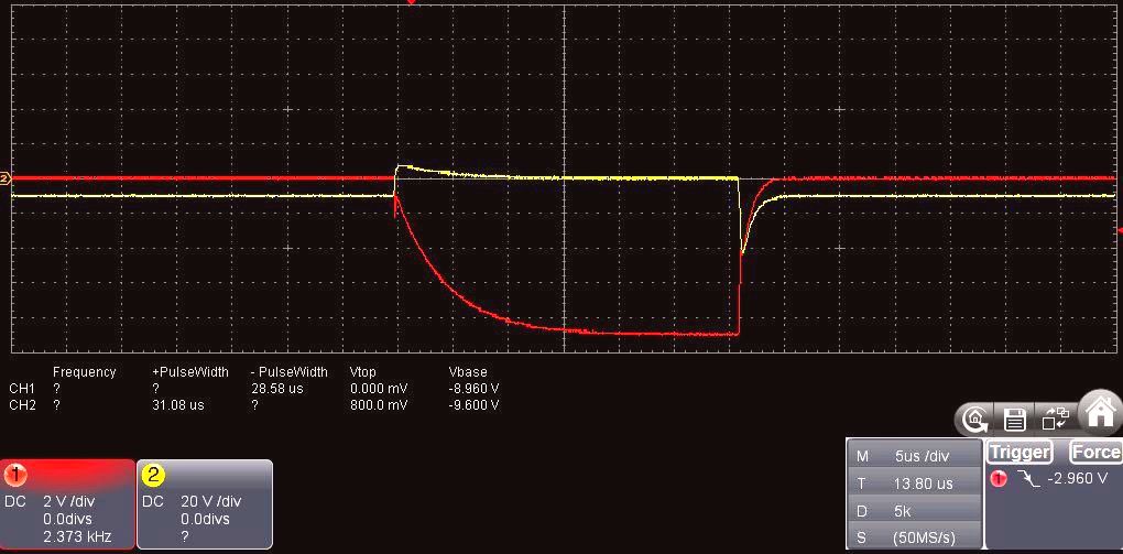

                            Heres a scope shot of the shunt voltage measured across the 68 Ohm series resistor of PP2: Click image for larger version

                              The inductance(ie number of turns) is too high for the Al value of this ferrite core PP2, causing it to saturate.
                              Reducing the number of turns would likely cure this. Or limiting the level of the pulse.

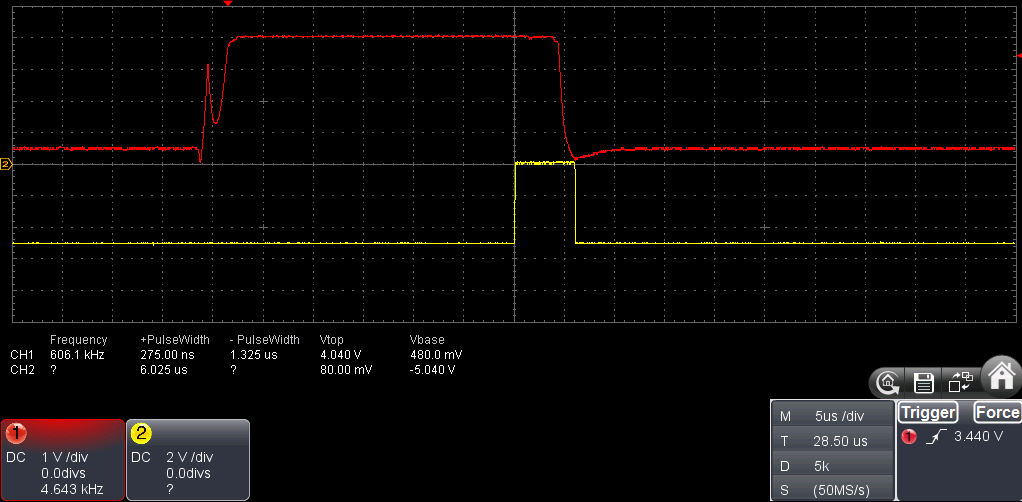

                              It looks like you are right. I reduced the windings in steps of 5 and testing this "compass" (Thanks Carl) until I got to 35 windings less.
                              The problem is practically not noticable anymore. I also played with the sample delay - it did not make much difference.
                              The pre-amp output looks much different now, yet it still detects a nickel at around 3 inches.
                              Here's a scope shot: Click image for larger version
