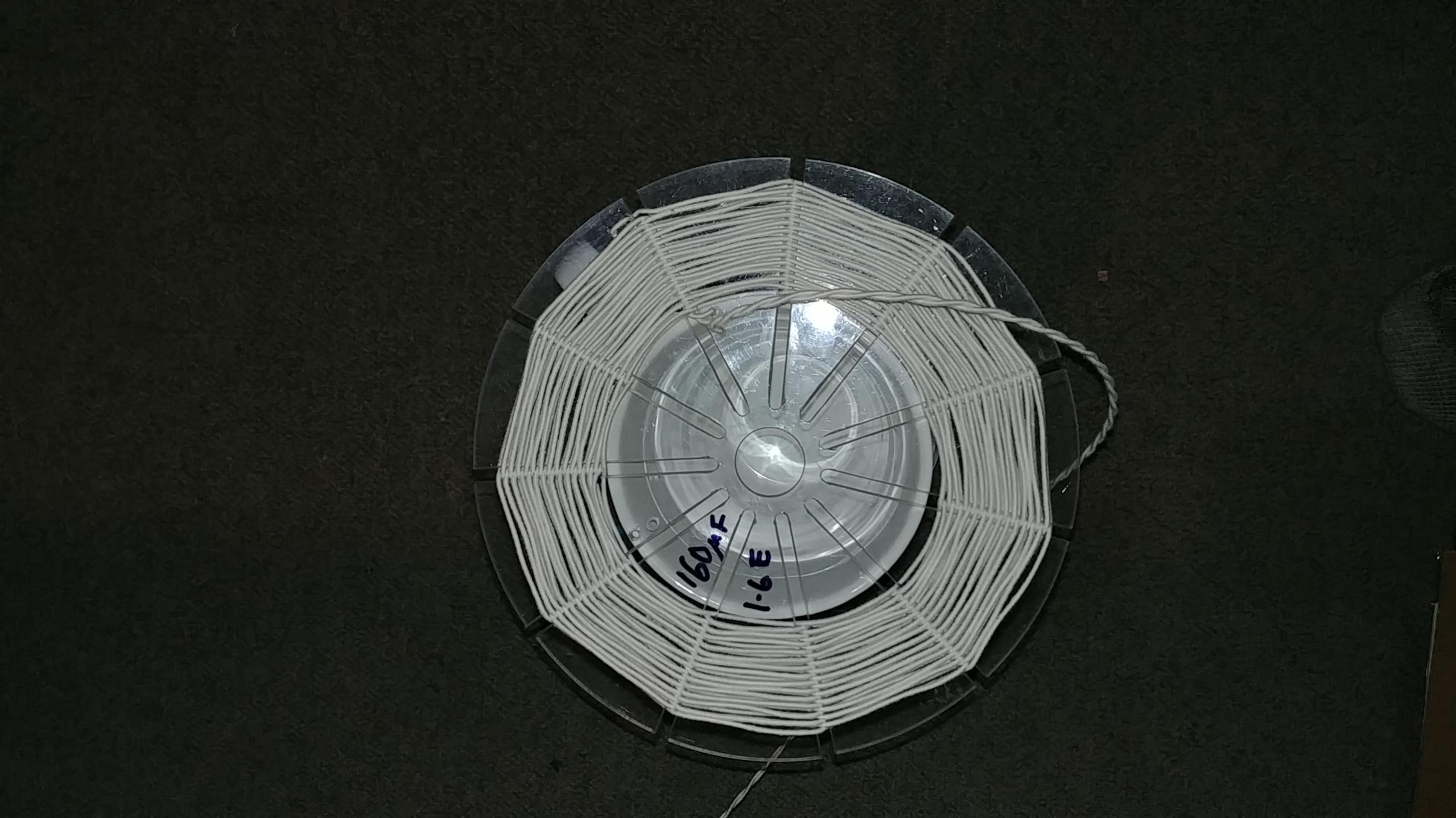

Hi All,

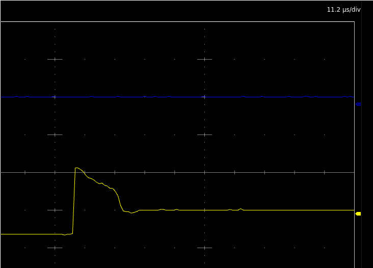

I have tried with a very fast coil. It is 160uH 1.6E Spider weave, photo attached ..
I am getting TX discharge curve in 2uS
I have set my min delay to 5uS ... I can't seem to get lower with the current parts ..
However air testing is quite good.
My gold ring on it's side is 200mm and with the ring in the same orientation as the coil 300mm .. not too bad.
Be interesting if field testing is as good ..
I know you are mean't to be in the 300uH..500uH range, but not possible with the former I used, unless you fill it completely .... and that would be counter productive I feel ..
The outside dimension of the coil is approx 190mm ..

Thats very fast, will be interesting to see what happens with in ground testing, good luck.
Depending on your soil conditions, you'll probably find that it falses a lot due to ground signals. I expect you will have to increase the main sample delay to 10us. If you go to the beach, then 15us is more suitable for searching at the surf line.Originally posted by SaltyDog View PostBe interesting if field testing is as good ..
Originally posted by Qiaozhi View PostDepending on your soil conditions, you'll probably find that it falses a lot due to ground signals. I expect you will have to increase the main sample delay to 10us. If you go to the beach, then 15us is more suitable for searching at the surf line.
I thought the whole idea of the 2nd sample was to cancel out ground effect ..
