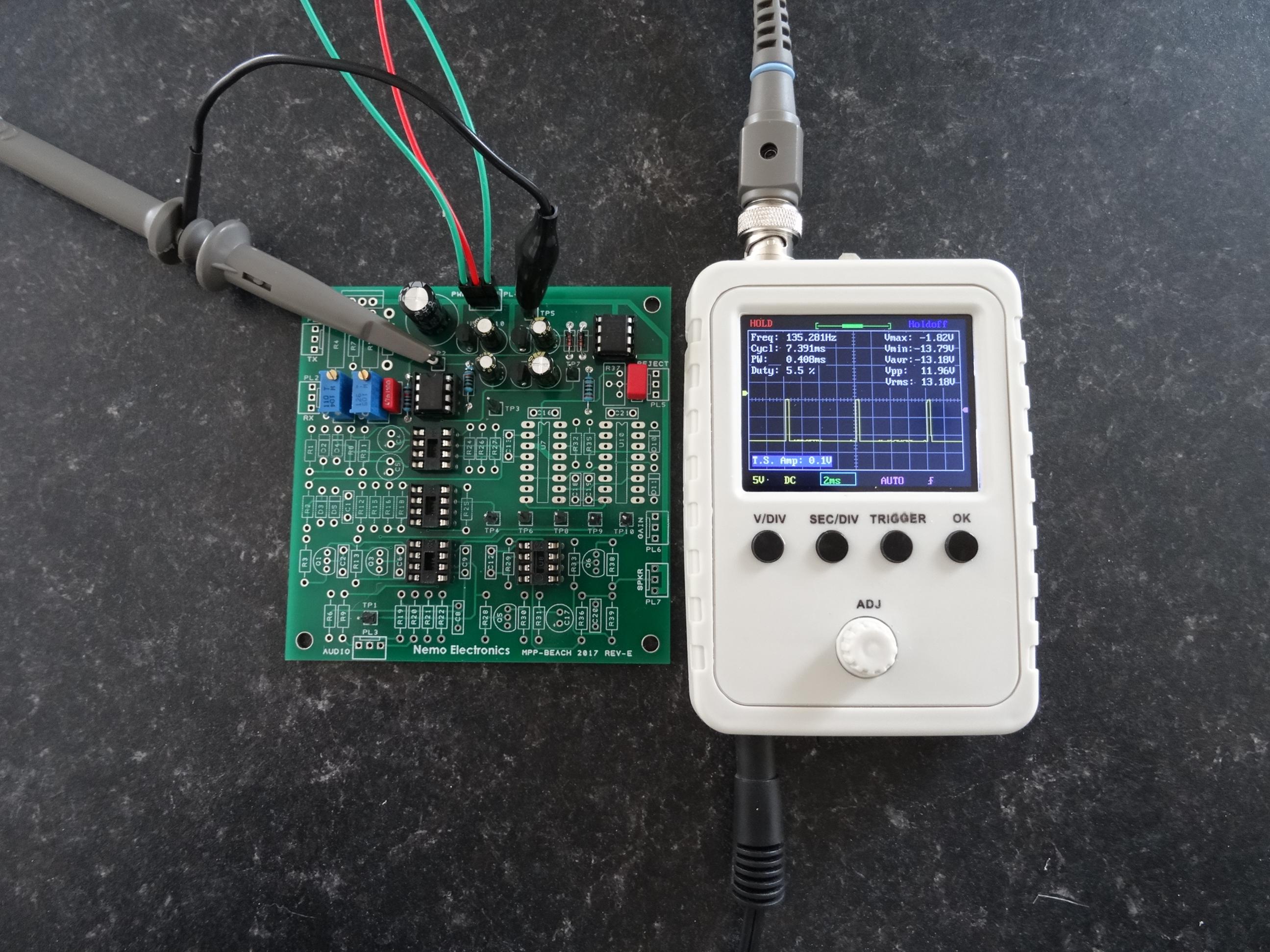

    I'm new to the forum and electronics. 7 months in it sometimes seems like rocket science but I've managed to do OK so far. Building a MD struck me as a challenge and something I could use instead of flashing LED circuits all the time.
    I bought the MPP board online before learning about this forum so apologies in advance for not doing things in the best way. Wasn't aware at the time I needed a scope to build it so that's something I am learning also.
    Can you check the pics to see if I have correctly completed step 3 ?
    The scope I have is a cheap DSO150 about the size of a cell phone. Not great but maybe enough for now.
    Here is what I did.

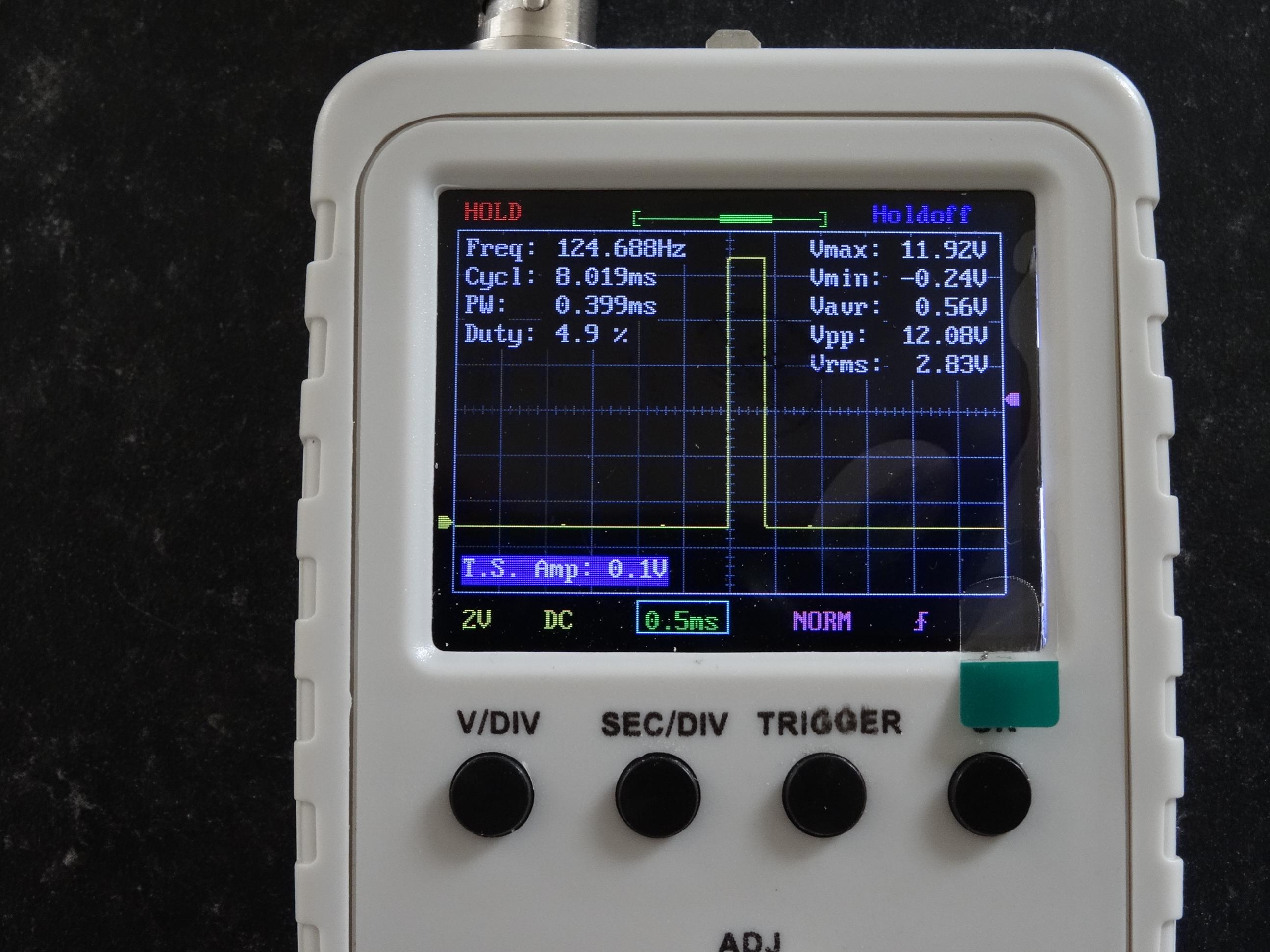

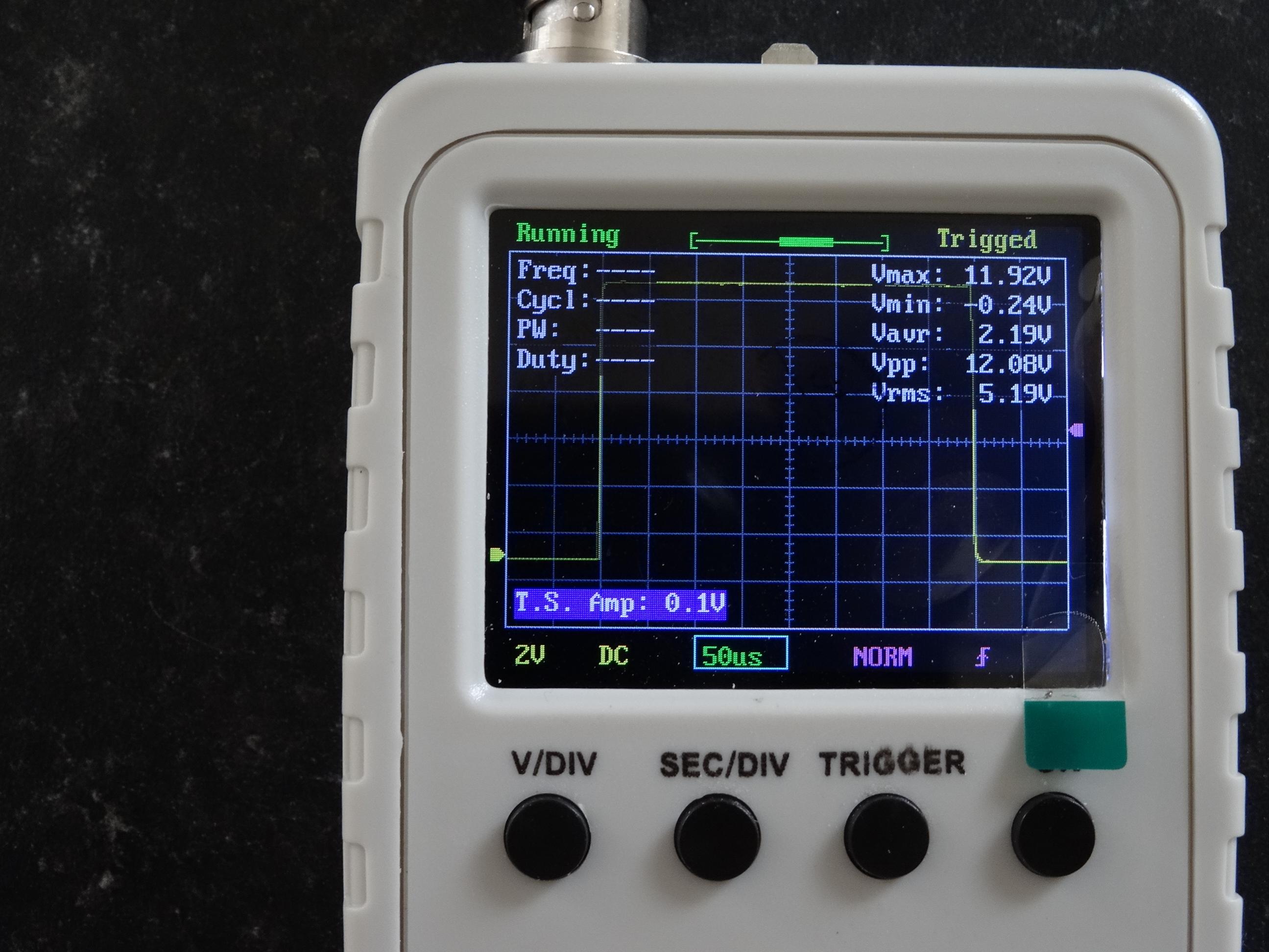

    Set the time base to 50us at 2v. This way I see the biggest pulse on the screen. faster than that it dissapear's. Slower and its too small to see enough detail.
    Adjusted to span 8 divisions on the screen. Assumed 8x50 = 400us
    Have to turn the dial to 0.5ms in order to see any numbers. Top left. Nothing will show at 50us for some reason.
    Looks to be about 80% of a division at 0.5ms and checks out with the math.
    Adjusted R14 to 8ms
    That coincides with 125pps
    The numbers do tend to bounce around a little but its the closest I can get.
    Does this look right to you?
    If not, can you explain like you would to an idiot what needs to be done to correct it. My brain, what little there is of it struggles with understanding scope readings at the moment.
    Thanks in advance.
    The first scope picture shows a high pulse of 400usec and 0 to 12V.
    I tend to count screen divisions rather than go by numbers displayed.
    To measure frequency the scope needs to 'see' at least two pulses. So not sure if the second display's freq is correct.
    However, IF the scope triggered of the falling edge and that edge is on the left edge of the screen then the freq is about 290Hz.
    I would want to see two pulse to be sure.
    If the period is 8ms then set the time base to 1ms.
        Thanks for the reply waltr.
        So this 0 to 12v reading is incorrect even though it is showing 400us ?

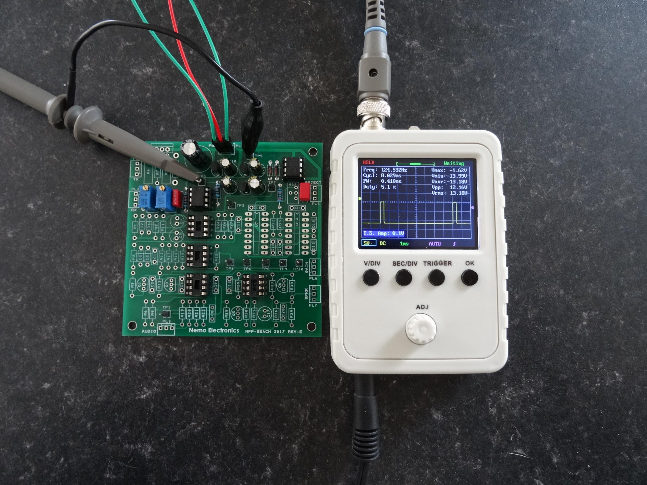

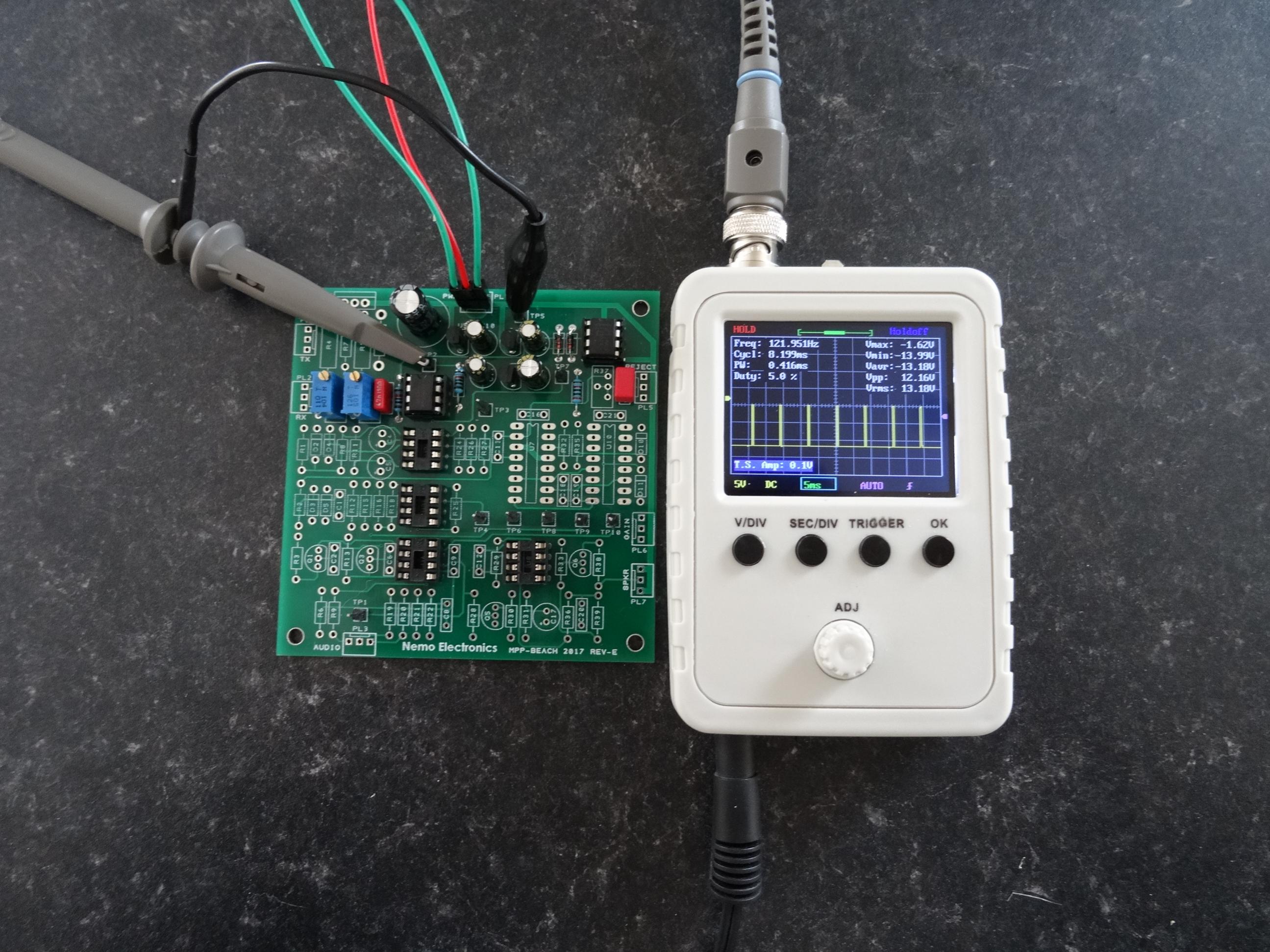

                Ok some progress, some uncertainty.
                I have volts now. Adjusted settings on 5v instead of 2v as I did last time. The numbers bounce a little but are in the ball park on 1ms setting.
                Shown is the connection setup.
                As are two pulses across the screen.
                Probe connected to TP2 ground part of the probe on TP5
                Uncertainty = the frequency changes at 2 and 5ms settings leaving me thinking "which one is the correct speed selection starting point"
                Makes it tempting to adjust the trim pots all over again depending on what speed its running
                  The cycle time measurement with 1ms time base is the most accurate.
                  The reason the 2ms and 5ms time base measurements are different is due to the resolution of the scope's timing on the pulse edges.
                  This pulsing look good so move on to next step.
