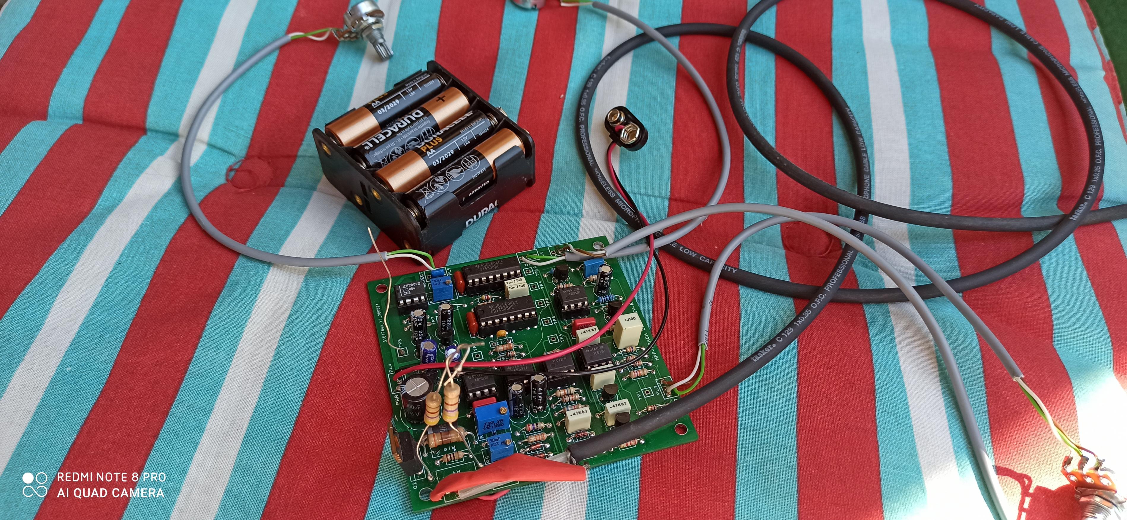

replacement MC14538BCP with CD14538B possible?
  • replacement MC14538BCP with CD14538B possible?
    U7-u8 MC14538 can i replace it with CD14538B?
    thank you!
    Devis from Italy
    thank you!
    Devis from Italy
    Hello Devis,
    Yes you can use the CD14538B. I use them on my Mini Pulse.

            I have finished my minipulse
            The result is truly amazing

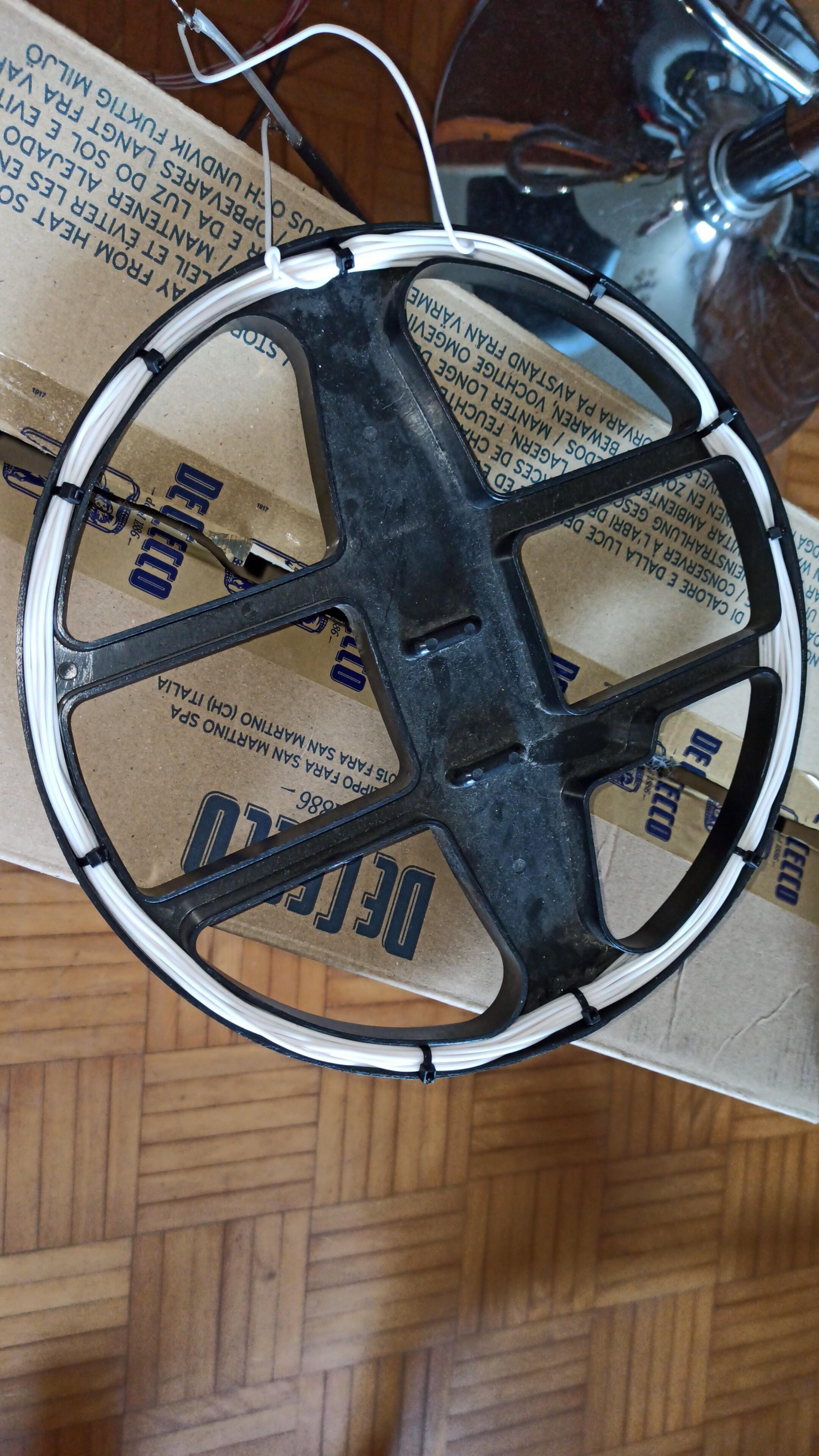

            I built a very fast coil
              Hello Devis,
              Nice job on your Mini Pulse. What are the specifications of your fast coil?
                Hello Devis,

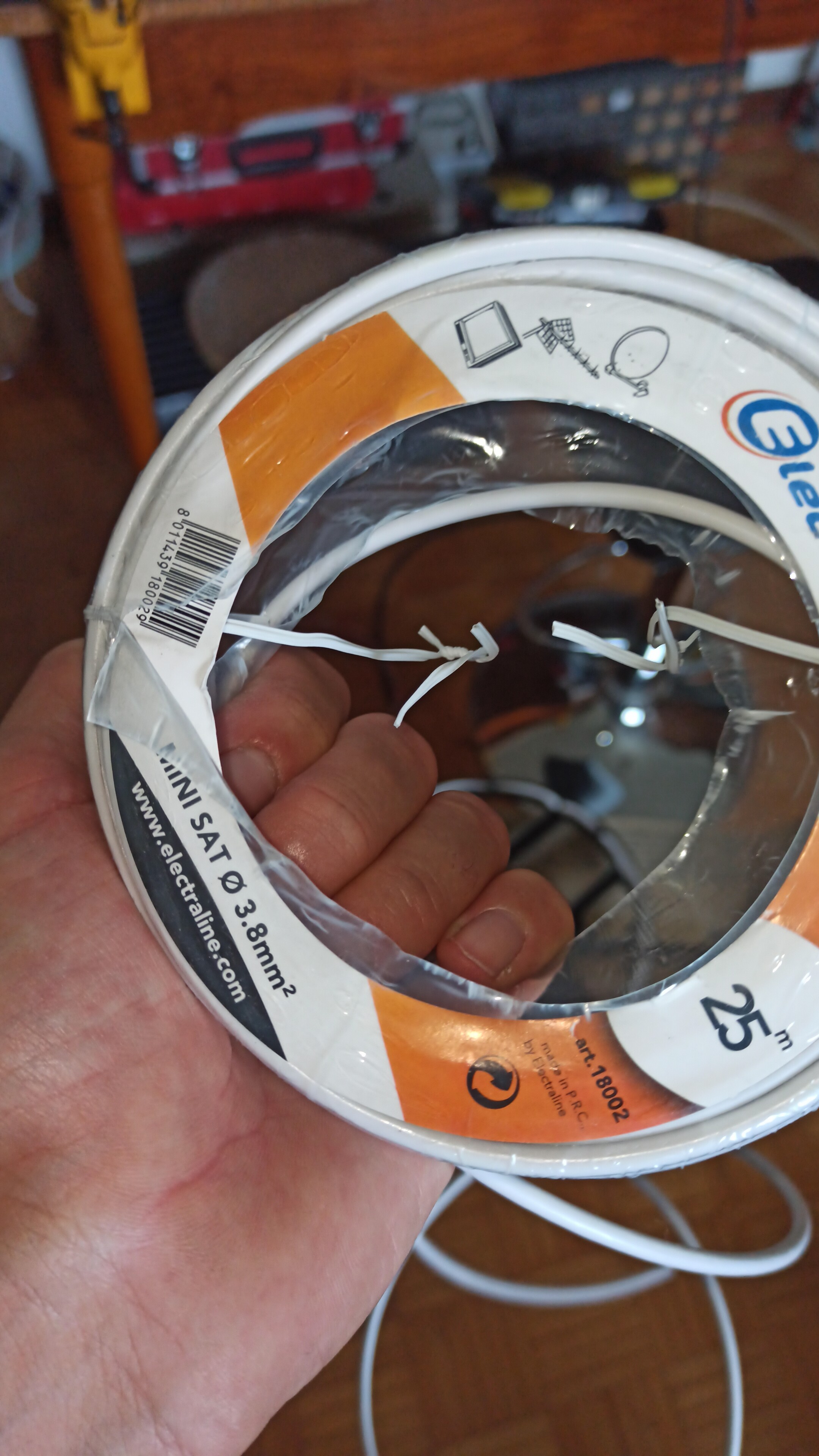

                I used a cable for tv / SAT wiring I removed the shield
                20 turns,238mH, 2.5 ohm, dumpin resistor 940ohm (470 ohm +470 ohm series)internal diameter coil 245mm

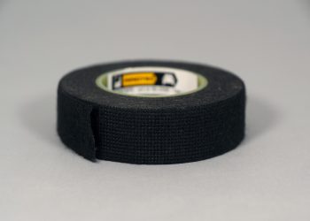

                I used duct tape for automotive applications

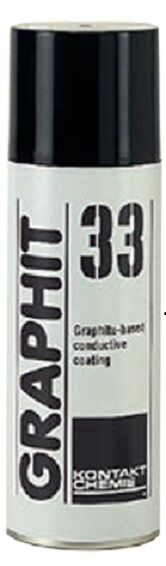

                and applied graphite shielding
                without shielding the signal decays in about 8 micro seconds,with shielding I have yet to check
