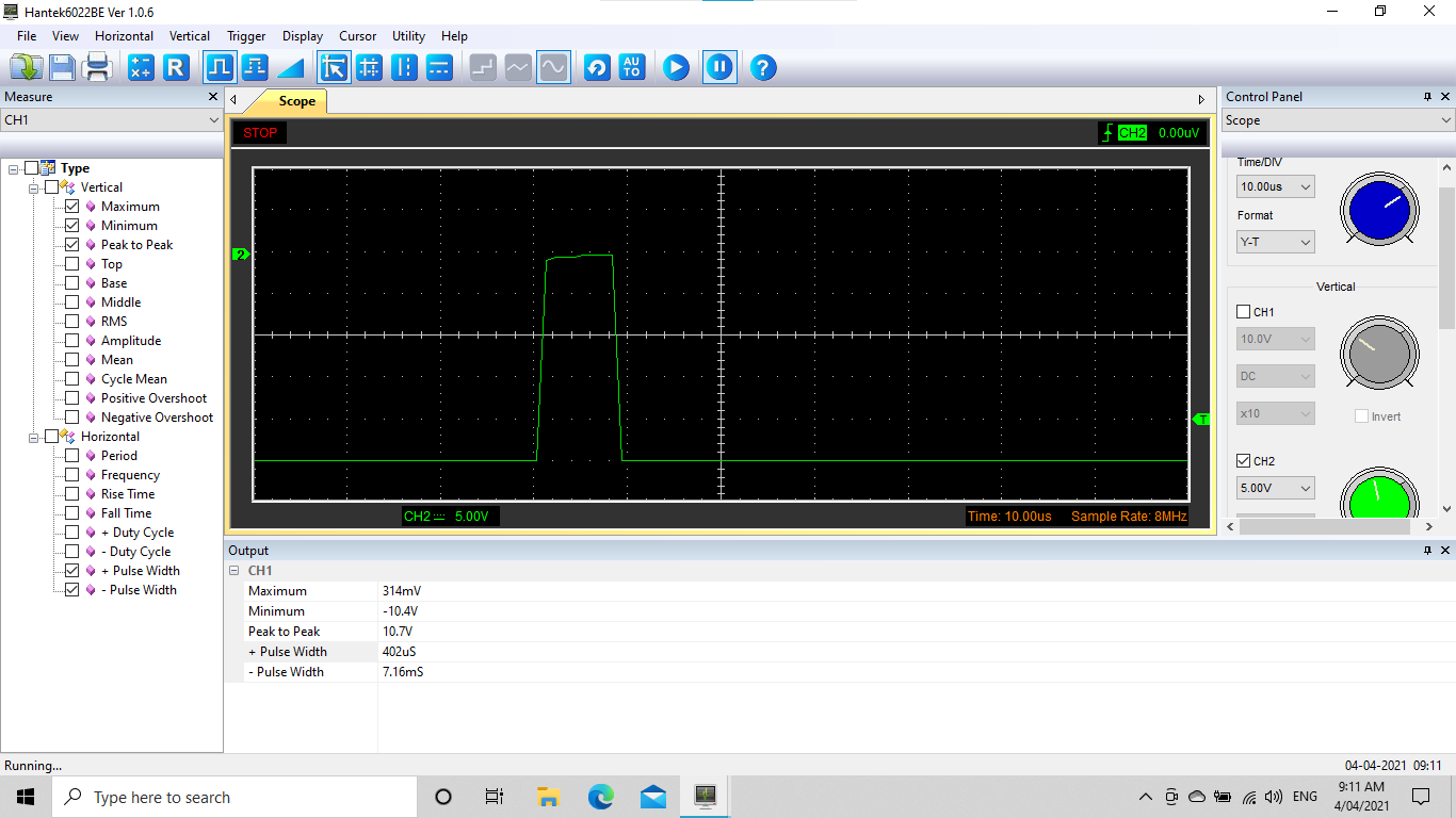

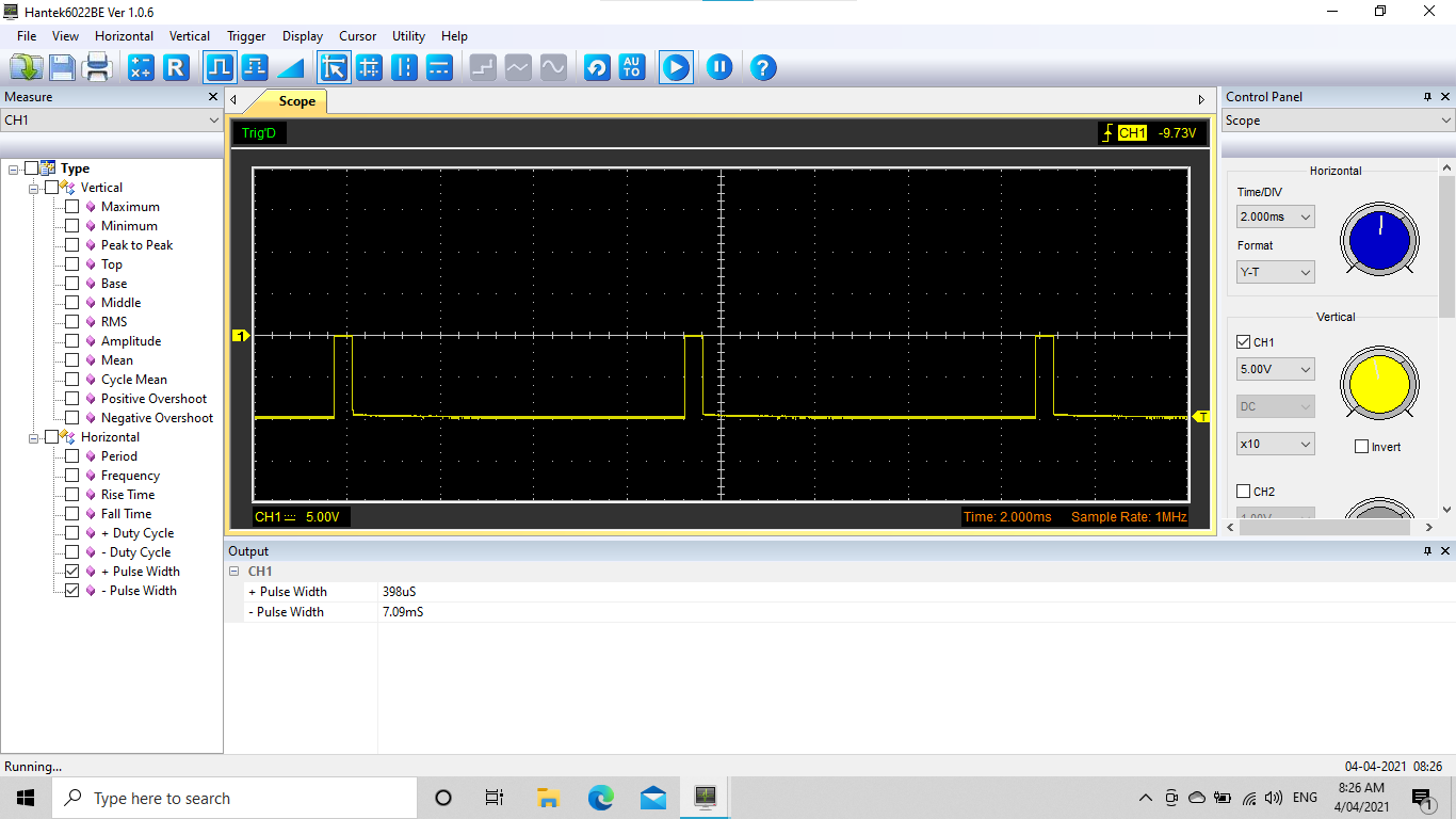

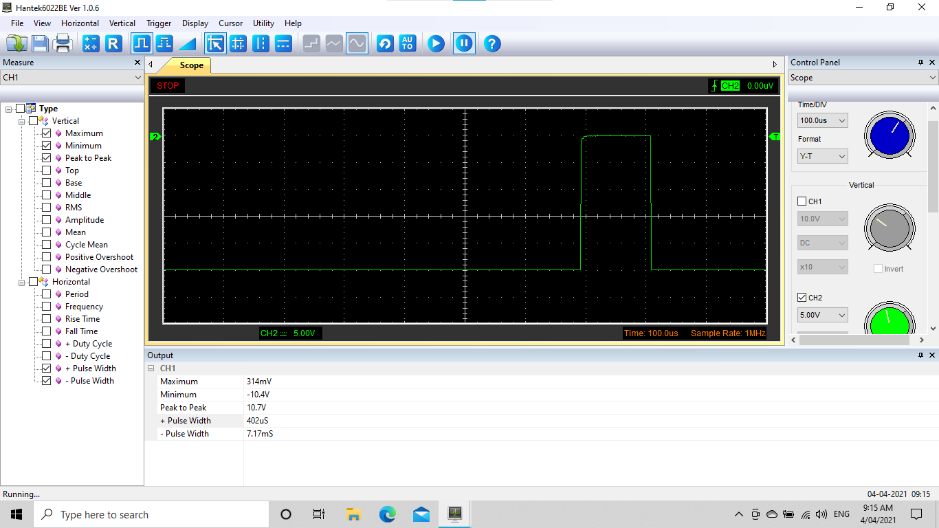

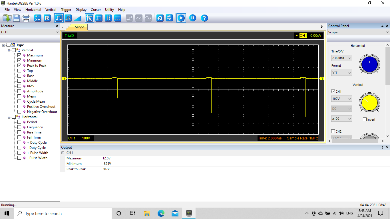

    i have finished steps 1,2,3,and 4 got +5V ,-5V pulse width of 400us pulse period of 8ms , i was getting voltage spikes but think i must have shorted something out just wondering what to look for what parts are likely to be faulty to get 350V or higher in step 4 . I have looked for any obvious shorts and checked my damping resistor jig ok there but might have accidentally shorted something or maybe just have a faulty part please advise anything that may help. as i have only a little electronics knowledge. Please help Graham.

        Fixed problem with flyback voltage had damping resistor connected wrong step5 shoe polish tin didn't seem to have a noticeable affect step 6 think i have a faulty 100k trimmer no effect sorry cant send pics at the moment don't have a camera hope to replace trimmer soon cross fingers thats whats wrong want to go beach detecting close to retirement all the best any thoughts Graham.
          Changed 100K trimmer seems to work ok now but having difficulty setting damping jig to get the right resistance from oscilloscope wave currently using Hantek 6022be maybe i need a better oscilloscope. will keep you updated now onto the next step as soon as i get the right resistance. Graham

            I've noticed that people tend to over-think the damping resistor issue, especially when using the damping resistor tool. If you're simply trying to get the thing working, make a jumble-wound mono coil with an inductance between 300uH and 400uH. You can usually critically damp the coil using either a 680R, 470R, or 330R resistor (depending on the detector). Once you have the detector working, you can then play around with different coils and adjust the damping resistor more accurately if necessary.

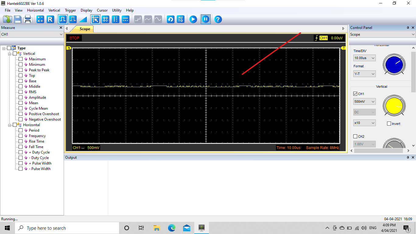

                Still need help

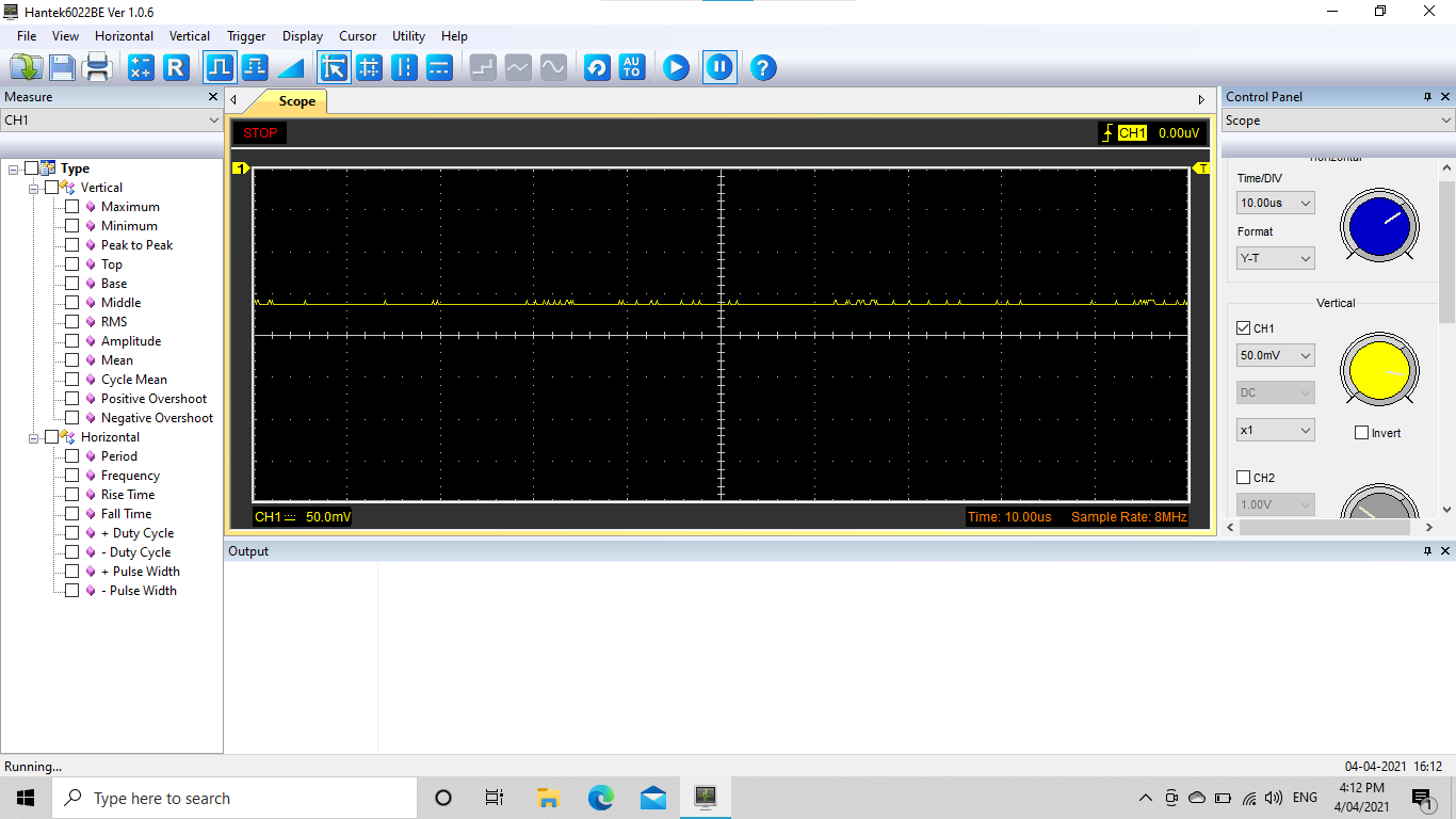

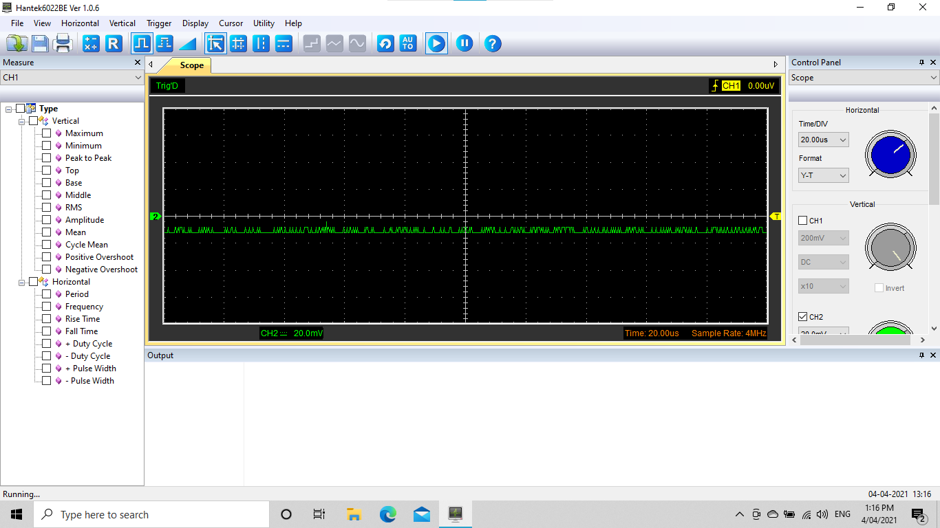

ID:	359482 Step 6 both TP9 And Tp10 dont seem right step 7 and 8 not working right either step 1 to 5 seem ok may have shorted something if anyone can help please do ile keep trying Graham note i have attached some pics

                  I had a short checked some signal diodes while in circuit 2 of them seemed to be faulty will replace them in MPP and hope no other parts were affected like capacitors ic's or resistors will let you know how i go Graham
                    Finally go Mpp Detector working up to stage 7 i am looking forward to finishing it for me it has been a steep learning curve using an oscilloscope etc Not Sure how to connect stereo headphone yet isn't it set up for mono also i am wanting to know how a 5K taper for volume control would connect up any help appreciated Graham
