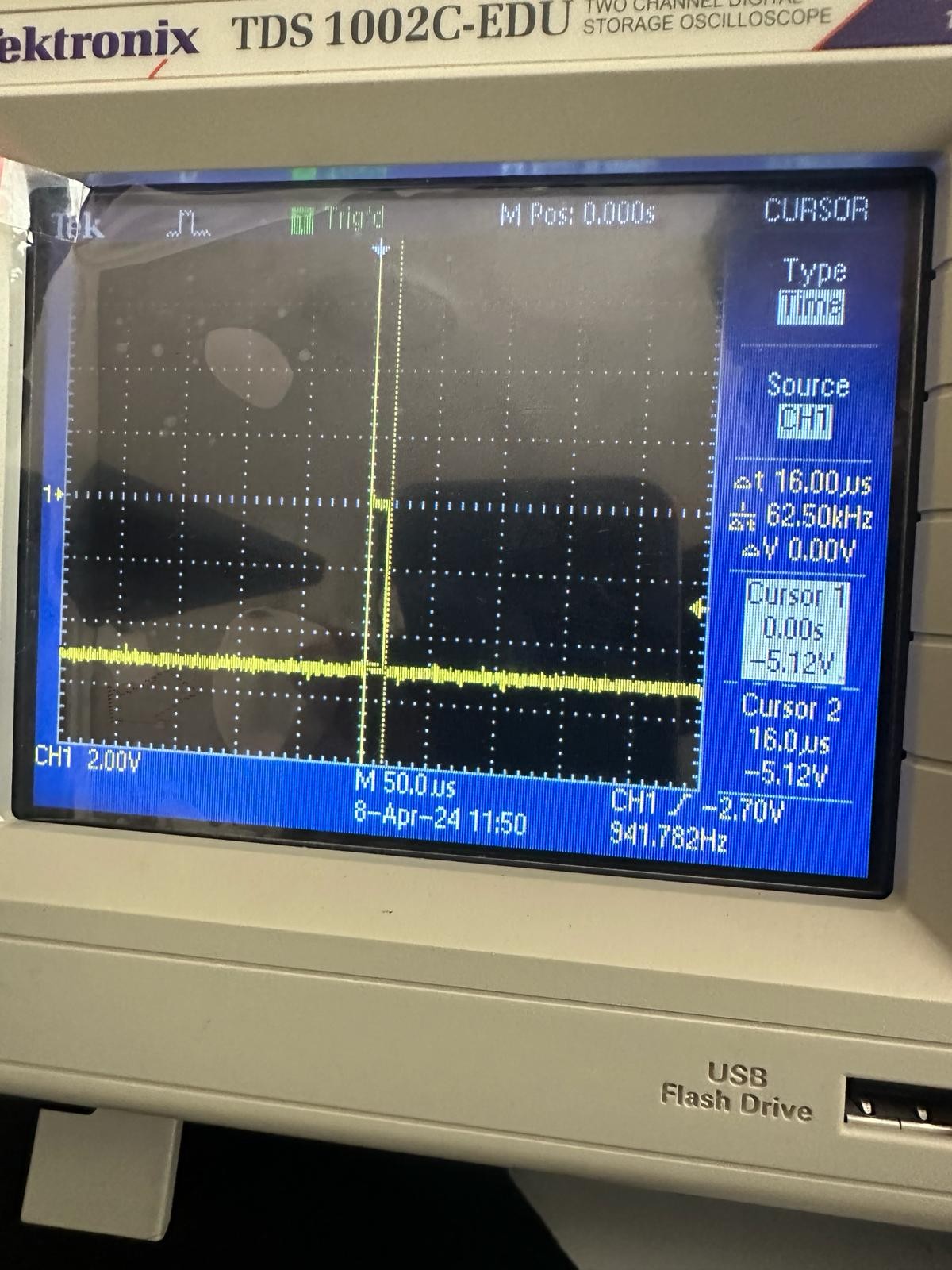

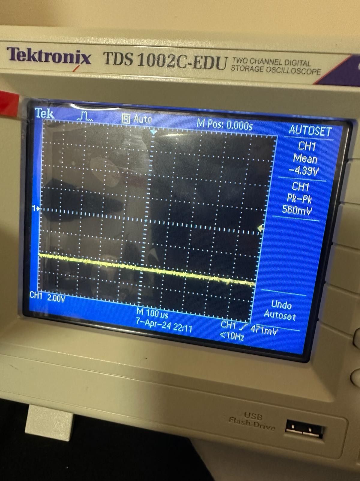

Everything is normal until step 7, but in step 7 the signal looks like this and does not react at all. TP4 how can I solve this problem?
MPP REV-E Step 7, Signal on TP4 does not respond

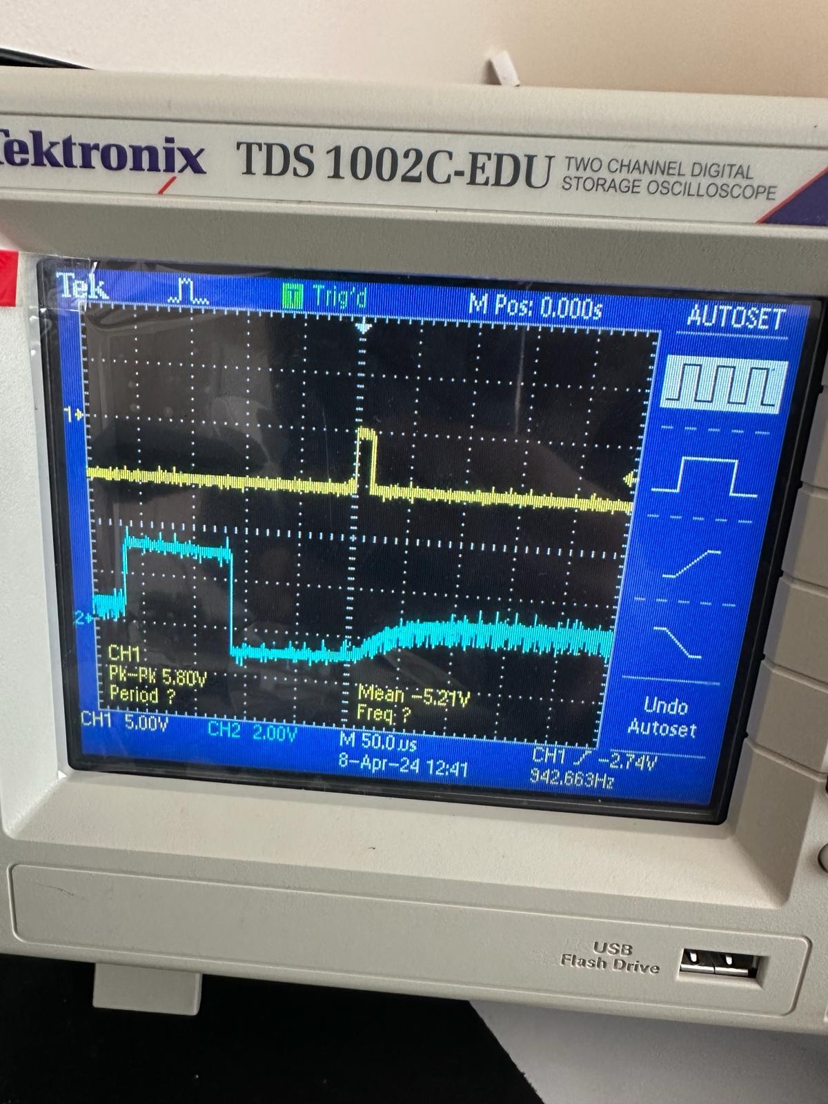

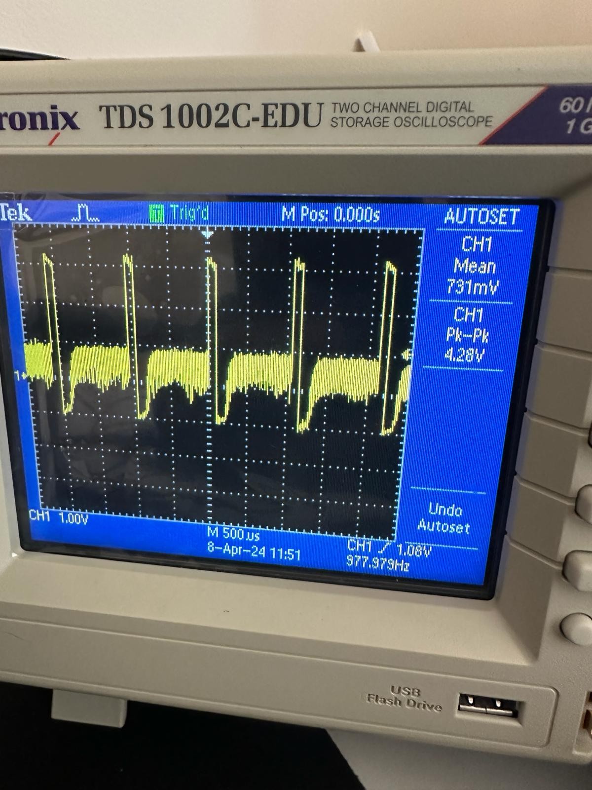

Assuming that the preamp output at TP3 is correct, and the power supplies to U3 are OK, then check the sampling pulses at Q1 and Q3.
If everything seems to be alright then you may a fitted a wrong and faulty component in the sampling integrator.

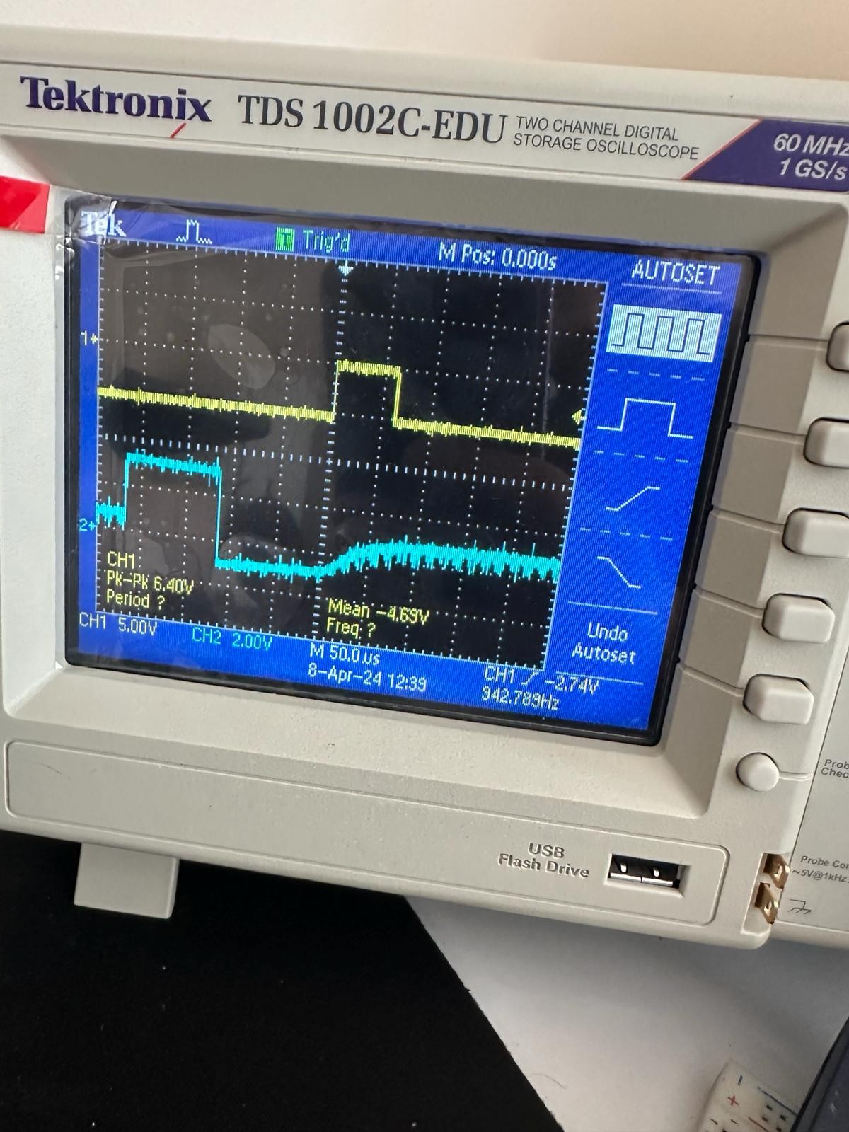

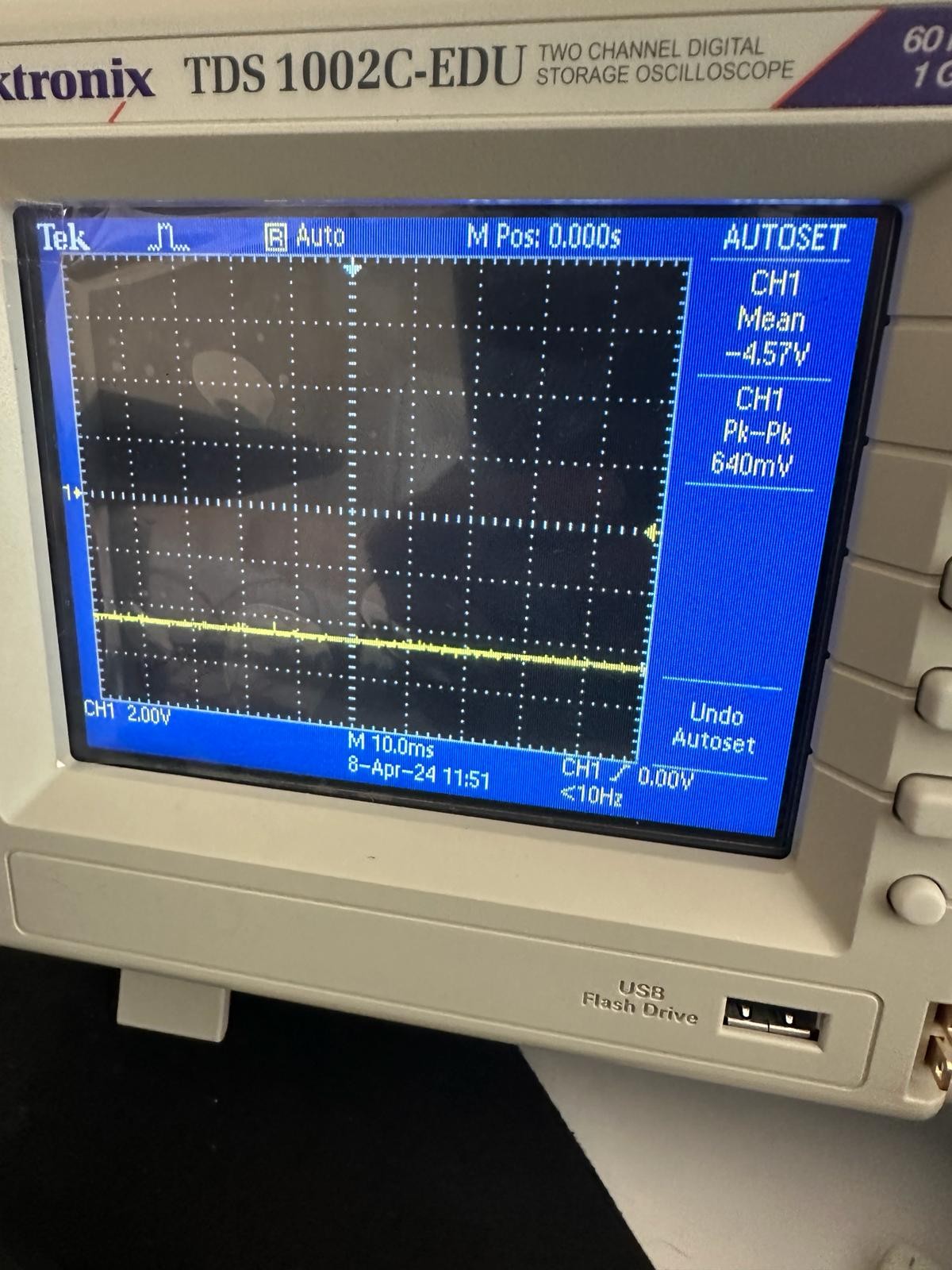

Signals for J113 JFETs and TL072

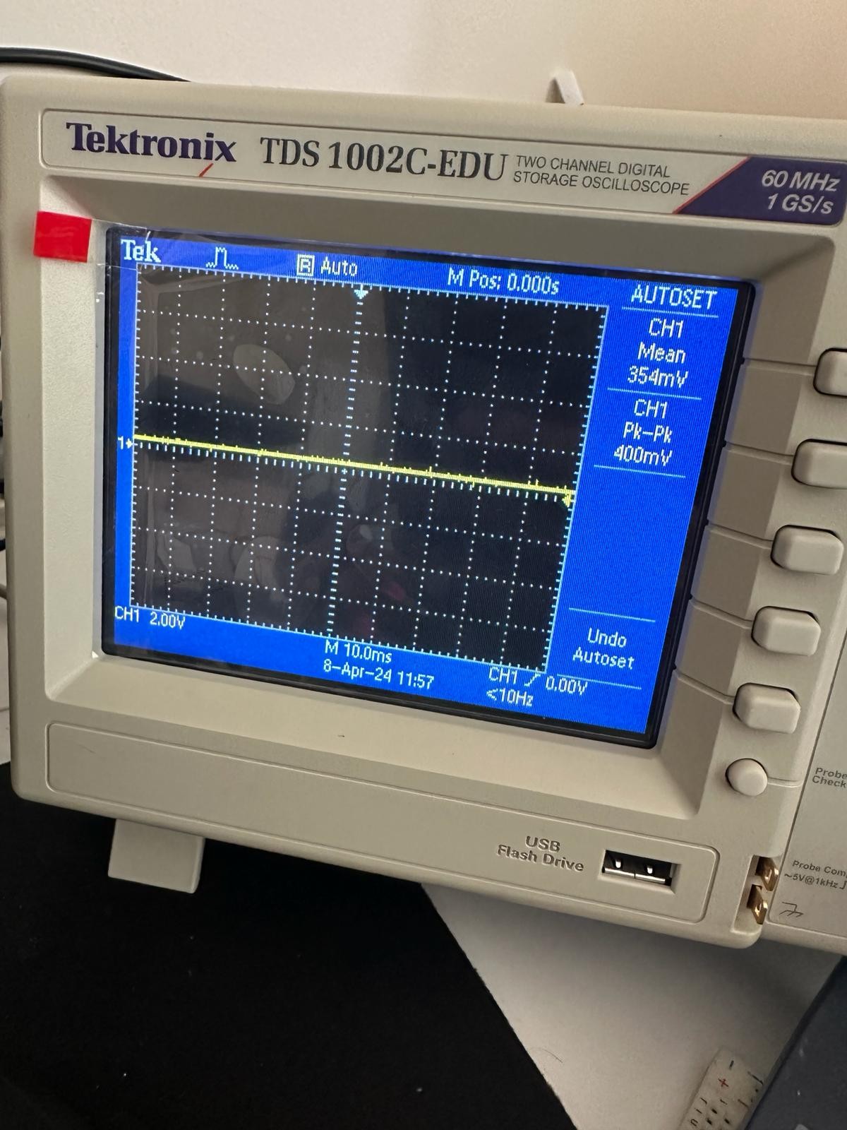

jfet drain and gate signals
It is very difficult to debug this remotely. There's obviously something wrong in the sampling integrator.
If your opamps are in sockets, then remove them and check the signal path again. You should be able to isolate the fault that way.
