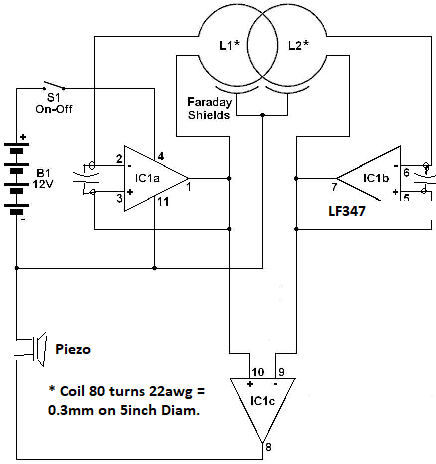

    I had made some Mods on this design - and made it very simple to build (minimal calibration).
    Actually, I dropped Caps between the OpAmp inputs p2/p3 and p5/p6, and removed cap VC1.
    I then connected the outputs to an Arduino, checking for Voltages and pulse Counts.
    Seemed very easy to use.

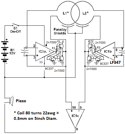

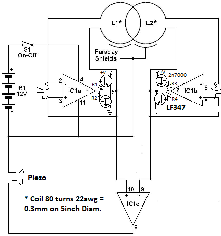

        My first question :
        * If I put a pair of 2n7000 (or other) FETs for High and Low on the Output of the Coil OpAmps,
        could this increase its Range ?
          My first question :
          * If I put a pair of 2n7000 (or other) FETs to drive High and Low on the Output of the Coil OpAmps,
          Sorry that would be :
