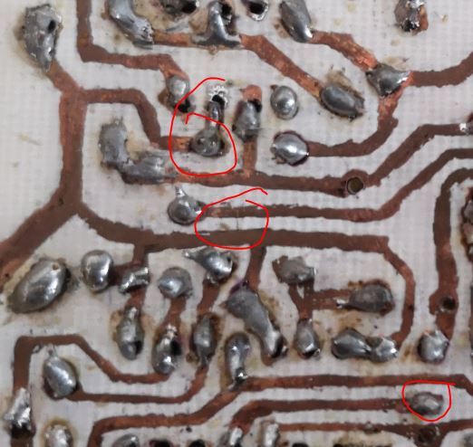

        Please post a picture of the bottom side of your PCB. It helps find mistakes.

            pcb rear view like this

              Hard to tell for sure but a lot of the soldering does not look good.
              Looks like the solder did not FLOW onto the copper circuit.
                Look carefully for solder bridges. Several places look extremely close. In the future, build your circuit in stages. Start with the power supplies, verify as you go.

                  emrdgnn,
                  Start by removing the socketed devices and check the power supply voltages.
                  Use some solder flux and go over all of those solder joints again, there are multiple dry joints and what looks like solder bridges. Clean the whole track side of the board with a flux cleaner.
                  cheers
                  Mdtoday
