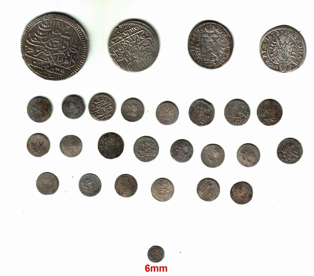

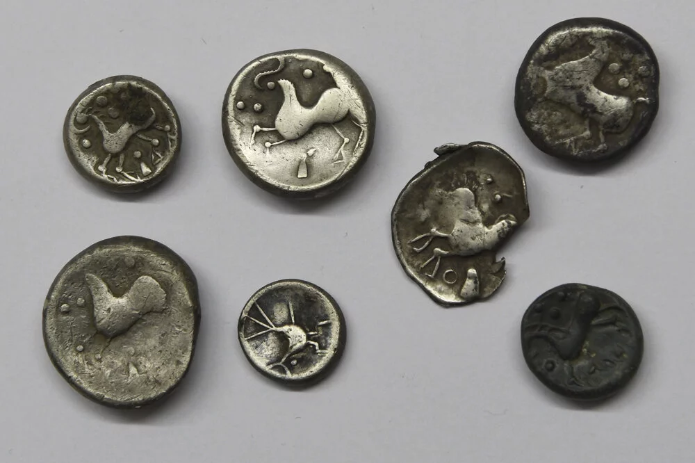

      Why I prefer the non-motion type detector?
      - Because I can continuously monitor the behavior of the signal in a very small space, without moving the coil.
      - Because by subtle changes in the height of the coil and by moving the coil very slightly to the left, right, forward, back, in a very small space in relation to the soil, I can judge the size, depth and shape of the target.
      - Because in recent years there is not much left from findings on the sites from targets such as whole coins and whole pieces of jewelry, parts of weapons, personal items, etc.
      What remains are very small coins, even up to 4mm in diameter, mostly silver or gold, mostly silver or gold pieces of jewelry, personal items... very difficult targets for motion type detectors.
      Often completely "invisible" to motion type detectors.
      - In order to have any success in the search, in recent years, detailed "scanning" of small areas is recommended. Sometimes I stay for half an hour on an area of ​​one square meter.
      - My search for coins (my favorite target), in recent years, has become more and more like a search for small gold nuggets.
      I believe that few colleagues will know that there are such small silver prehistoric silver and gold coins, only a few millimeters in diameter, often irregular in shape.
      - Non-motion also has advantages in searching for deep larger targets. Which motion detector "skips" very easily and "doesn't see" a bit.

        Very impressive, some of the bottom coins look almost Celtic...

            Those at left photo are from Ottoman empire, XIV to XVII century (not an expert, others told me), which I have discovered (280 pcs) 50 meters away from my home!!! I was shocked!
            Those at right photo are indeed Celtic coins. There areas were inhabitated by Celtic tribes in the ancient past. I keep finding more and more proofs of their existence here.

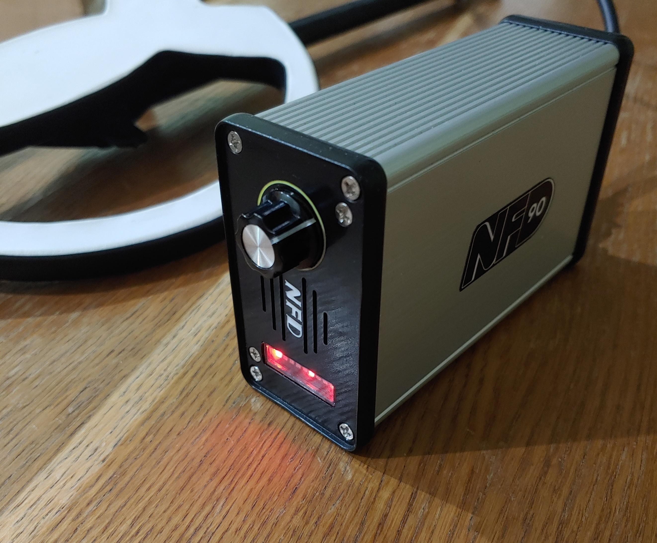

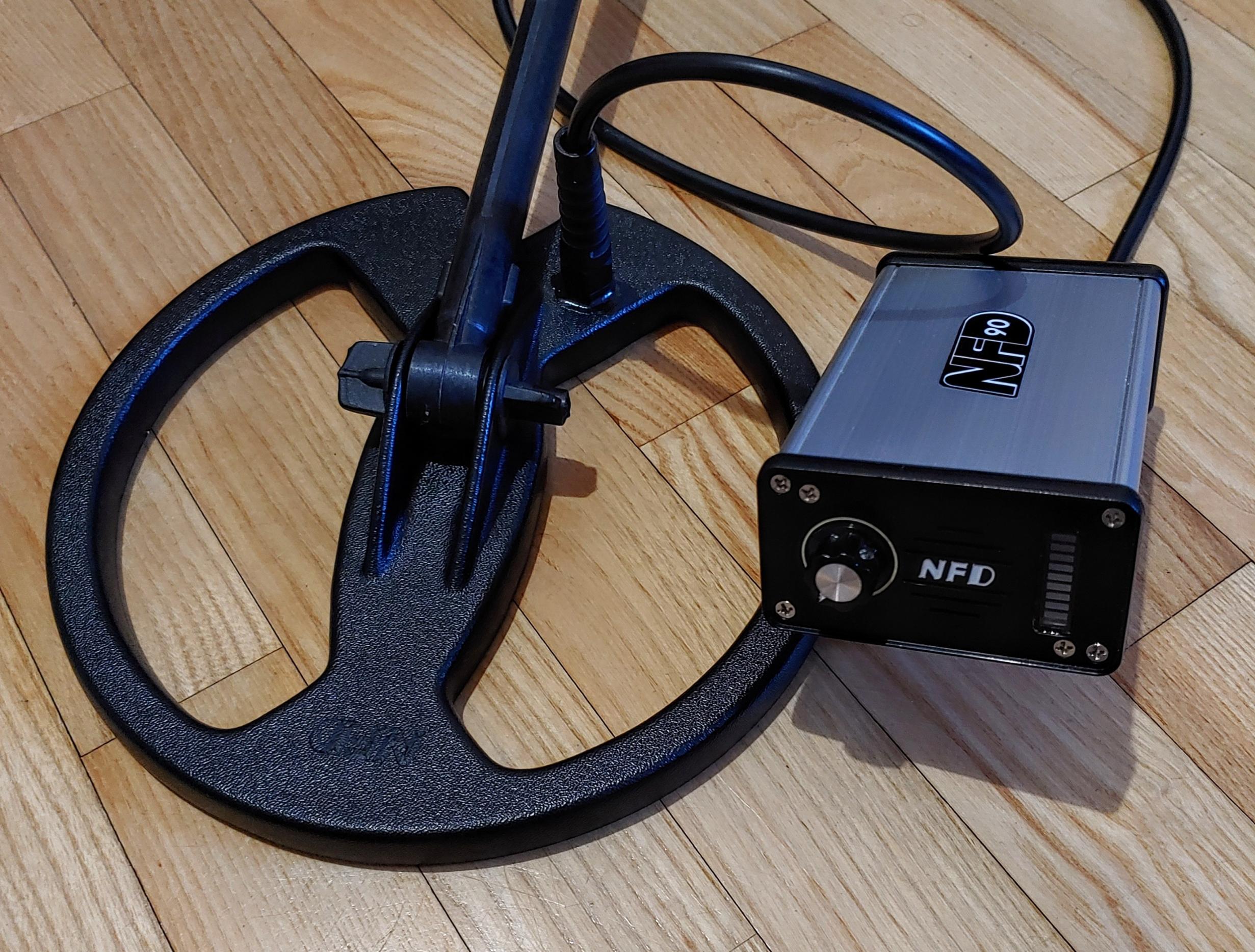

                There are benefits from non-motion design, but need to know where to use it with max effectiveness. In my case it gives best separation and Disc on iron infested sites. Other thing is to make stable and sensitive design not easy task... AI will not help to do that task. Carl is testing one of my units now

                      Finally someone who says the right things!
                      Now I can die happy!
                      Do you have a video of that detector?
                      To see and hear even a few seconds of behavior?

                          There are tests on my chanel, I think you'll like separation in the ground
                            I like it!
                              "Master"... "Bro".... give us schematic and pcb, I need it so badly!
                              (Joke of course, that's the usual what you can expect up from now on... if more people see that video)
