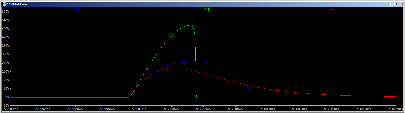

          Just to demonstrate the improvement of "mathematical damping" here is a pic below ...
          Classical damping in RED, ZP damping in BLUE and this method in GREEN.
          All coil currents the same each time.

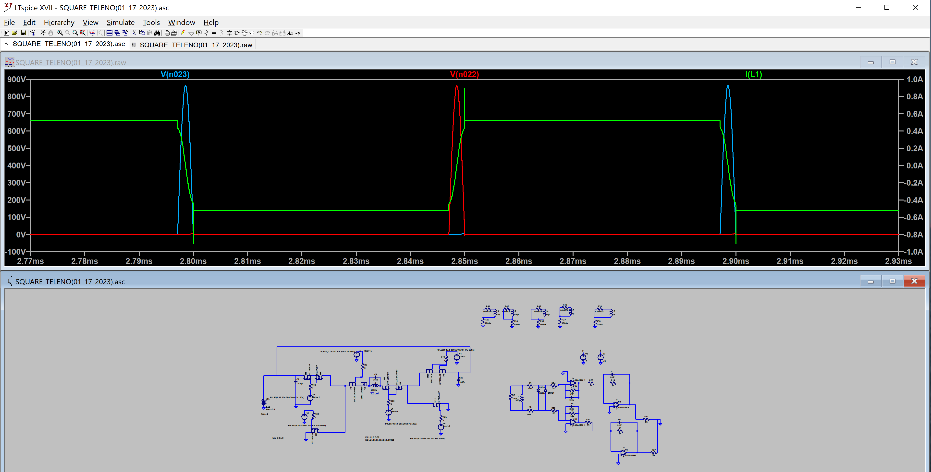

                        On the TX coil that I have on the bench now, the discharge of an inductance of about 2000uH, 60 turns, at about 1A takes 1.4us. About 60 Ampere-turns in 1.4us.
                        To represent the impedance of the inductance and the capacitance of the coil mathematically is beyond my capability, but the simulators are exactly doing that, because the simulation results perfectly match the bench results.

                            If we would just let it oscillate, it would be a perfect sine wave in the resonant frequency. However, there is also resistance in the circuit, so we need to replace the resistive losses. So we stop it and then restart it.
                            I will post the simulation.
                            Moodz asked for the mathematical formula. How would you mathematically represent the impedance of the capacitance of the coil? And the matching impedance of the inductance of the coil?
                            I guess that would be the answer to the challenge.

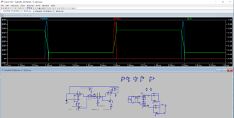

                              Here is a simulation of nearly the same circuit I have on the bench. You have to let it run to the end. Click image for larger version
ID:	419163 SQUARE_TELENO(01_17_2023).zip
                              I can also show you the real one functioning on the bench.
