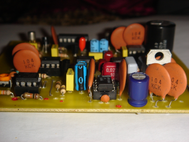

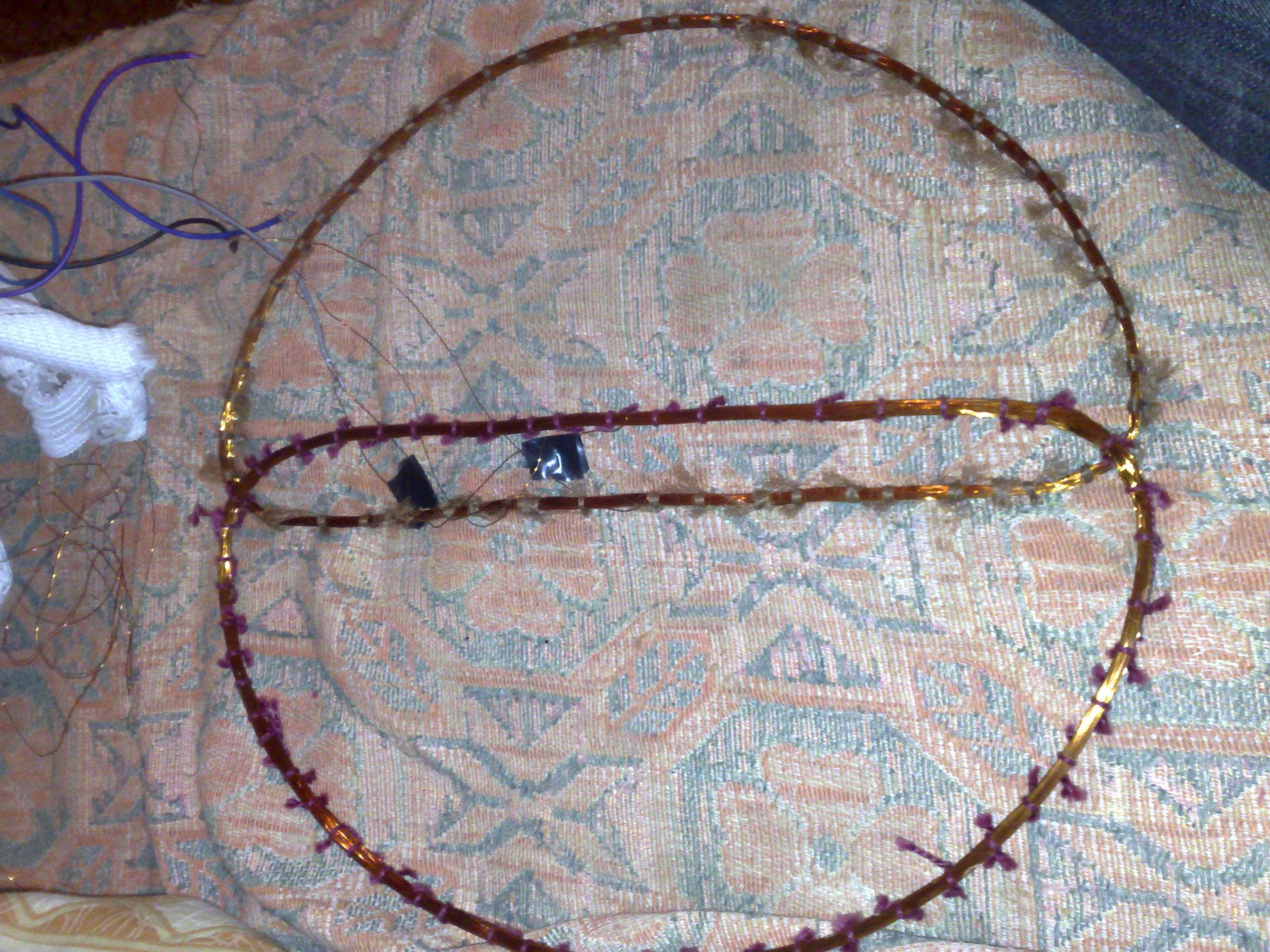

    i ve built the ivconics tgsl last version as discribed im not so so good in elctronics but im always open to learn cos i like i got some skills by my experiences

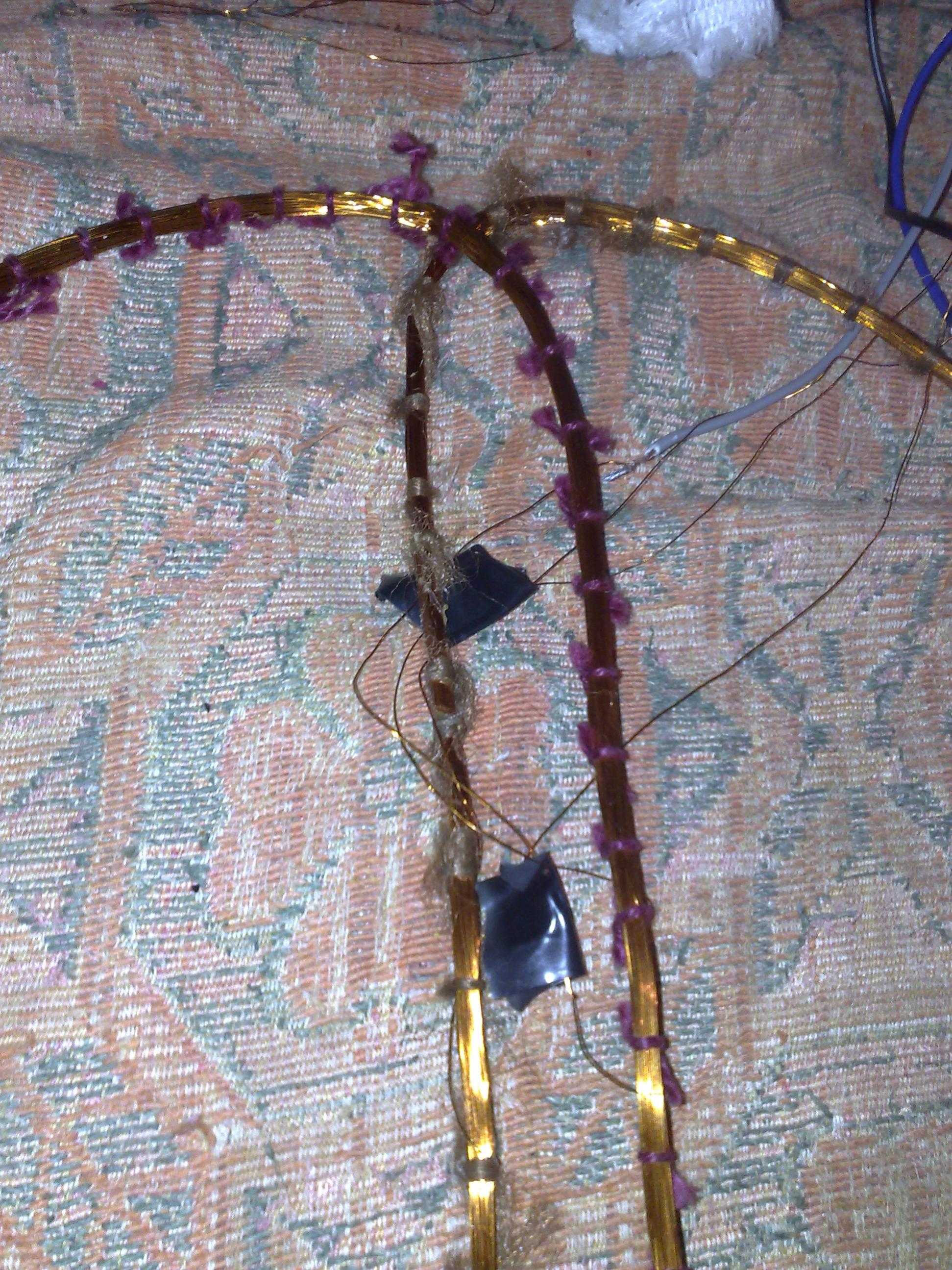

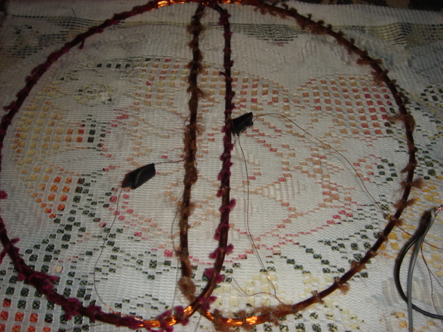

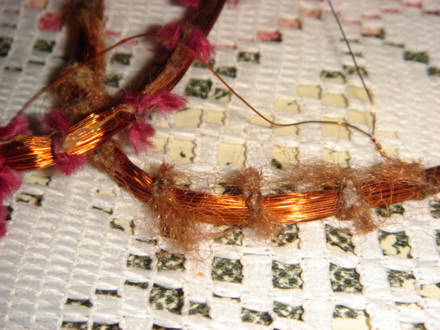

    so iv built also the coils 1st tx98 27cm resistance i think 25 or 25 ohm
    rx 107 turns -27 cm not shided
    and connect and start ............i here a very week piiiiii sound but feel the unit alive but the coil is dead nothing no detections just piiiiiiiiiii i didn't do any testpoint iwould
    just have an idea of where the problem can be ?
    mayb fets or caps or coil i dnt knw really ...so need some help and i will folow and learn lol
    have no lcr and no oscillo what a poor man lloooooooooooooooollll
    im waiting in cold for a help

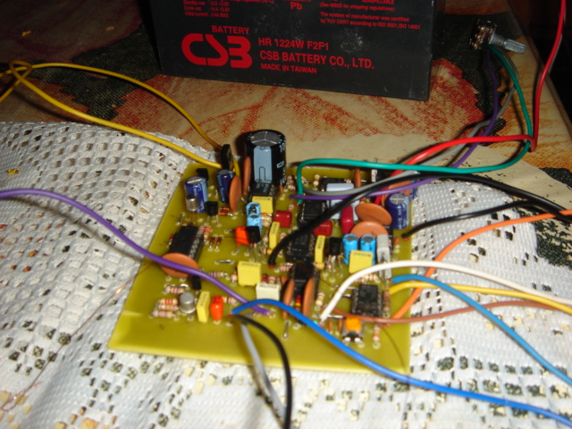

    Make some close up photos so that some experienced eye may find what may be wrong
    Make photos of your coil as well
      photos very soon

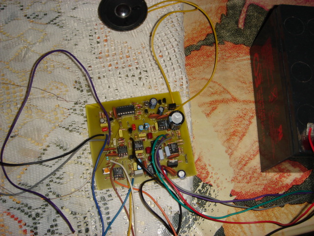

      tested some points at lm s and lf s found +9v but no negativ source at the pin's 4 of lf353 u101a voltage at the tx +9volt
      +9v at out lm 7808
      can do more chekpoints
      coils are about 25.xx ohms
      and 23 24 ohms

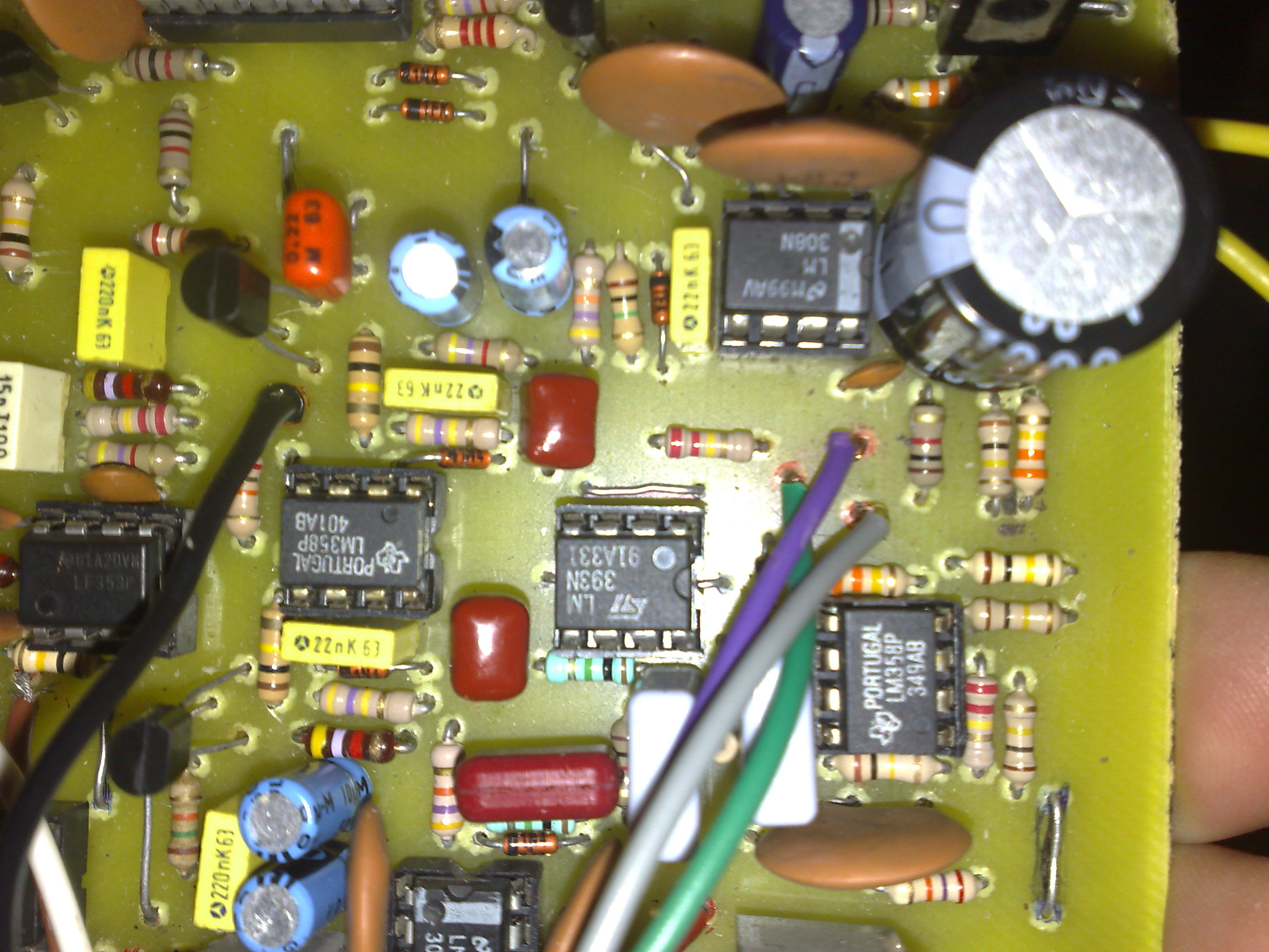

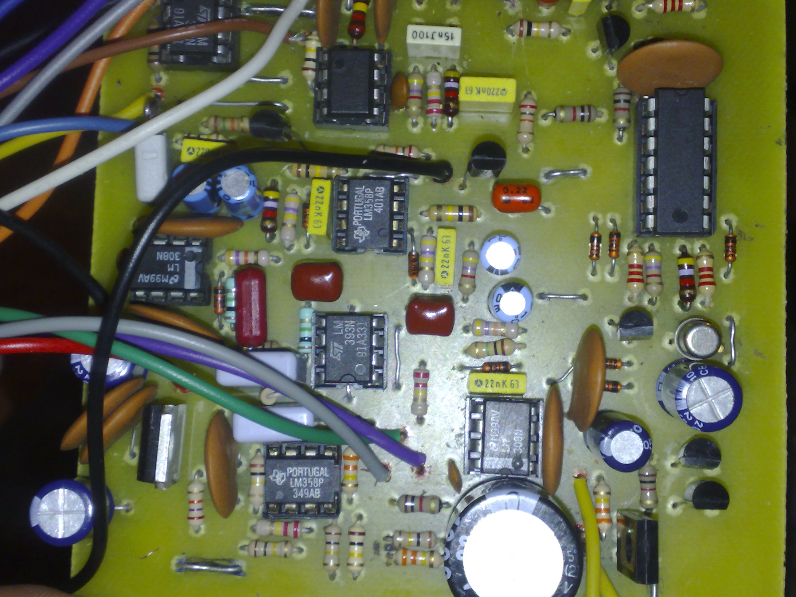

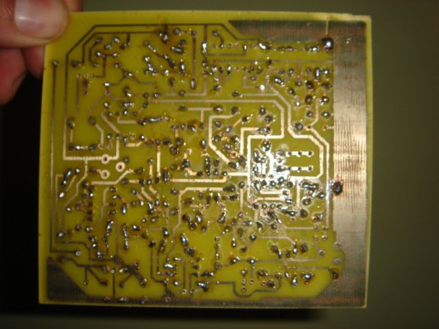

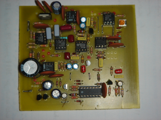

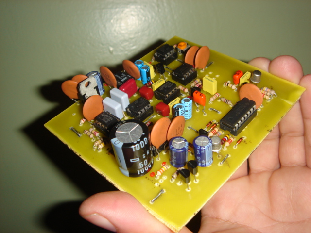

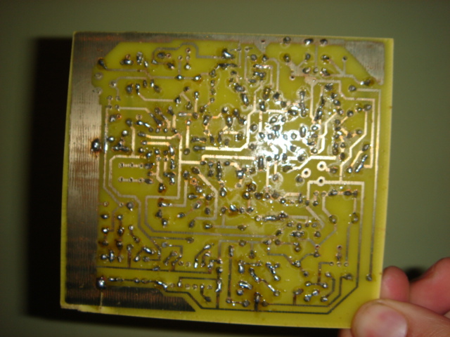

        here are some pics of my tgsl
          im supecting some ceramics caps cause i did grab them from used materials
          i just have to go 80klms to the suplier
          so got new ones as 100pf 00.15nf .22nf .022nf .47nf but they are of a big form
            so what do you think
            about the caps i wanted them slim ones but didnt found on the market
              before a have made a big mistake to turn the elctroy caps to them right pole +
              mmmmmmm
                tgsl
                hi there are 104 kck this not good you if you use .1uf ceramic in 100 volt or 63 volt good ......

                  yes i will try to change those kck104 caps
                  and i will poste result soon
                    The caps you have installed are a little large physically but are of the correct value. Here is some information that may help sort out cap values: http://www.csgnetwork.com/capcodeinfo.html

                      feels like have no negative curent -5
                        when i connect to 12v i hear a sound that the tgsl is on but no reaction may be due to my bad coil cause i really don't know how uh is just tested by multimeter
                          At this point pretty much everything is suspect until you can prove that it is not your problem. Start with the oscillator. Connect your coil and check to see if it is actually oscillating. You can look at it with your scope and measure it with your meter. Unless you have a tx osc signal, nothing else is going to work.
                          Once you have established that the oscillator is working, move on to the power supply. Check each IC at their supply pins for the proper + and - voltages. These also need to be correct or at least close for the detector to work. You can also remove all the IC's except for the CD4024 and check for voltages.
                          I have a longer list but that should be enough to point you in the right direction.
                          It it rare that one can build up a board with this much stuff on it and have it work the first time you turn on the power. This is part of the process.
