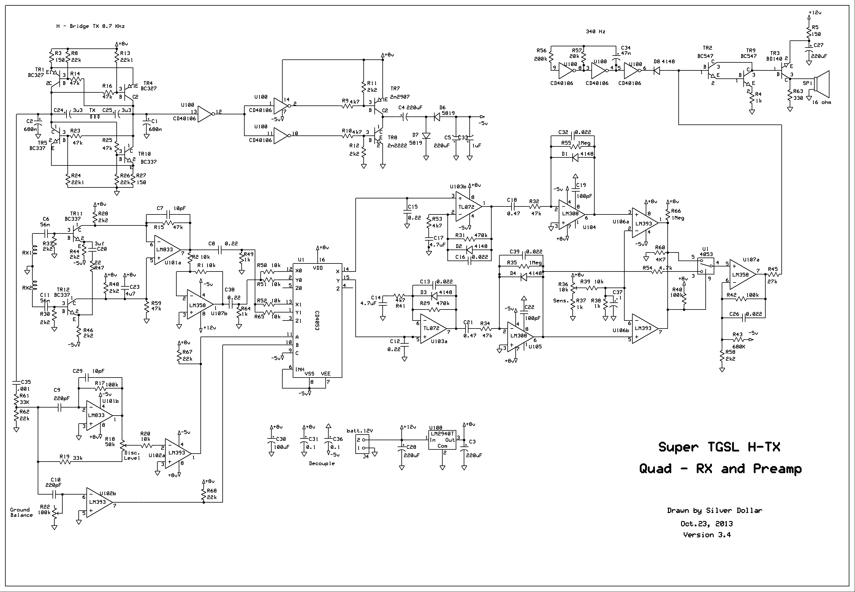

ok, I just finished editing this on my floor so tgsl cms, so I added the CD4053 and the two 4.7k resistors for the moment it does not work, I have a permanent beep. es that quelq'un could put the pin numbers of the CD4053 in the diagram, I can be tricked into wiring am. thank you
Super TGSL With H Bridge TX Diff RX Quad Sampling
Here's a schematic with pin numbers on the second piece of the 4053. That's a fake part so you cannot do
a layout with it as drawn. I was just using it to draw the schematic.

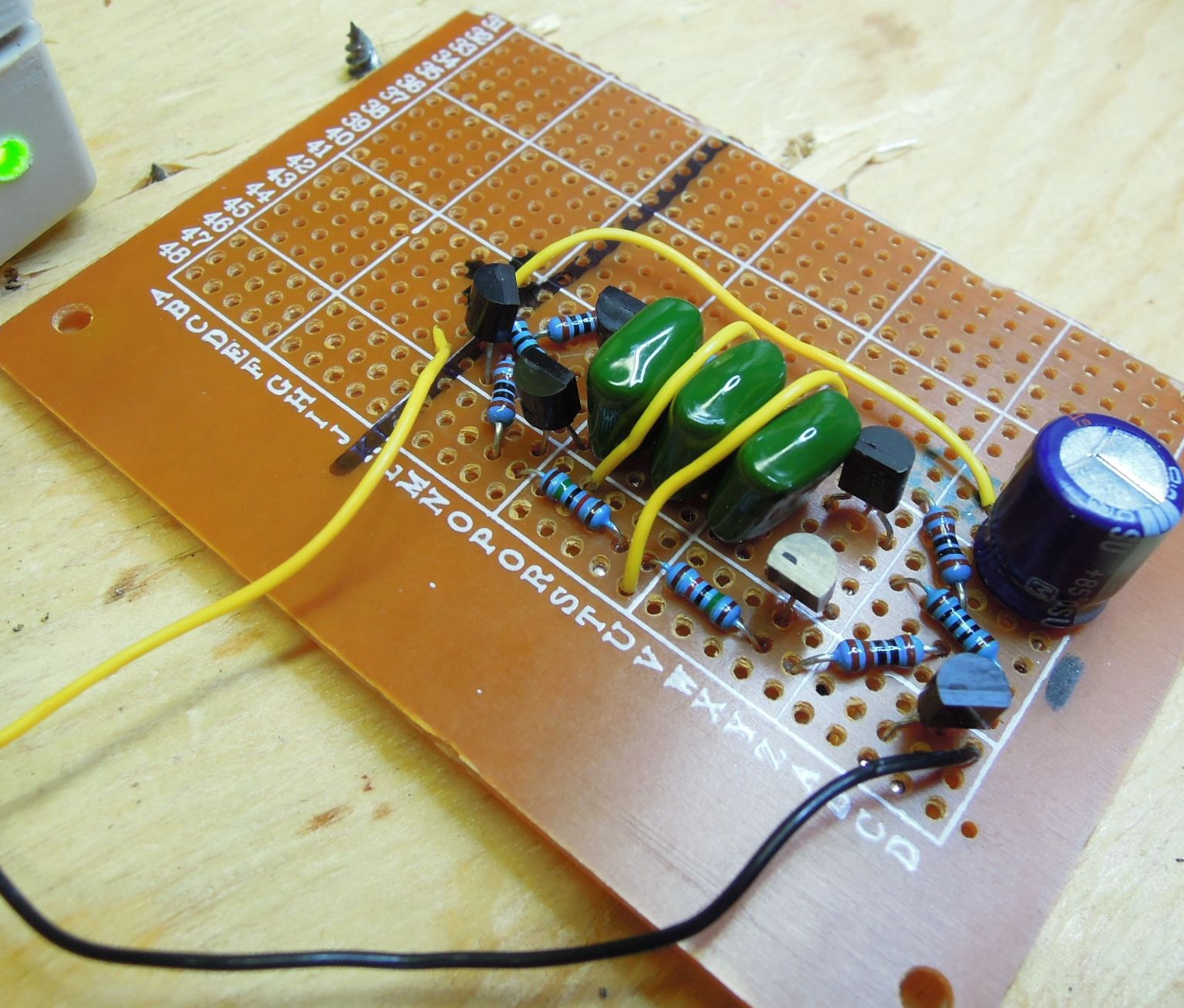

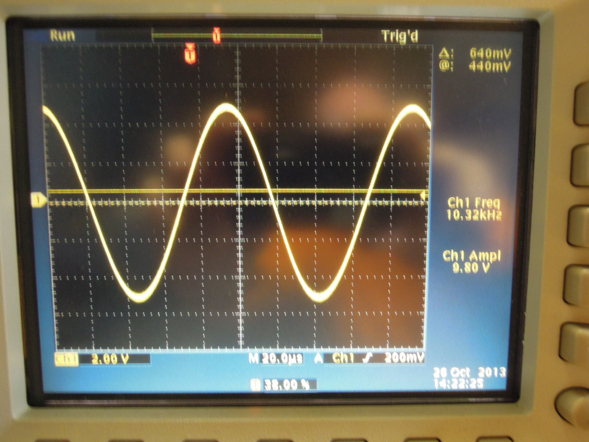

Well I got the new H bridge oscillator running today. It draws 6 ma (195mv across 33 ohm resistor) but
the voltage is just over 9v and the frequency is 10 khz. I got 8.6 khz off the Minelab oscillator (and 16v).
Davor is there any way to tune the frequency and voltage? I noticed the spice file had a variable for the 150K's...
I found that changing the caps from 470n to 680n changed my frequency to 8.6 khz but the peak voltage
on the coil decreased. Funny the sim didn't show that happening. I got the original H Bridge circuit working too
and it does the same thing. I'm just looking for the most bang for my buck. I wonder if I can get 12 khz out of
it as I have read that is the best all around frequency for MD's...

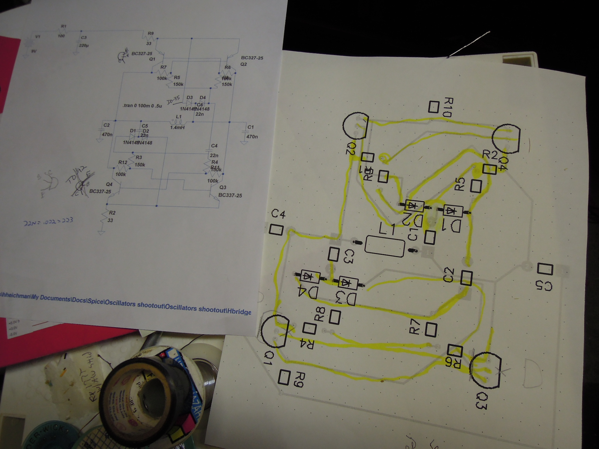

So here are the schematics of the 2 H bridges I am testing. I'm using the 1.0 mH spec from the Minelab coil (not
sure when where why it changed to 1.4 mH)
I have no current meter so am measuring the voltage drop across on 33 ohm resistor. The original 150's in the old
schematic reduced my output to 1V so they were originally shorted but now are 33 ohms.
Measurements;
Old H Bridge
8.6 Khz
7.3v
185 mv across 33 ohms (5.6 ma)
New development - - I added a 220u cap before the 33 ohm on positive side as I figured it might be running out of current.
Now I measure 15 mv across the 33 ohm -- That's 0.5 ma....
H Bridge AB/C
8.6 Khz
8.6v
223 mv across 33 ohm (6.7 ma)
(scope probe to one side of coil gnd to other side)
I'm not sure it is switching from AB to C...Attached Files
That 1.4mH is simply inductance of my test coil that I often use for such designs - nothing else. Please note that some of my designs have a coil resistance listed inside the coil properties, and are not seen from outside. For coils in 1mH range this resistance is ~2.4ohm with a coil wound using 0.55mm diameter annealed wire. This is important because it determines the coil Q factor. At 8kHz Q is about 15, and it rises with frequency, hence you get larger amplitude at 10kHz.
As for AB->C just see the waveform across the 33ohm resistor, and you'll know. In case you observe overshoots (negative currents) then increase those 33ohm to some higher value.
Choice of frequency is up to you, and your choice of coils. You may go for 12kHz, only be sure to adjust Rx accordingly. Many people prefer commercial coils - I don't - so if you are after some degree of popularity of your design, just keep the original specs in mind, and don't change frequency for more than + or - 50% (to make sure coil balance is OK)
Otherwise, I like your Tx waveform - looks perfect!

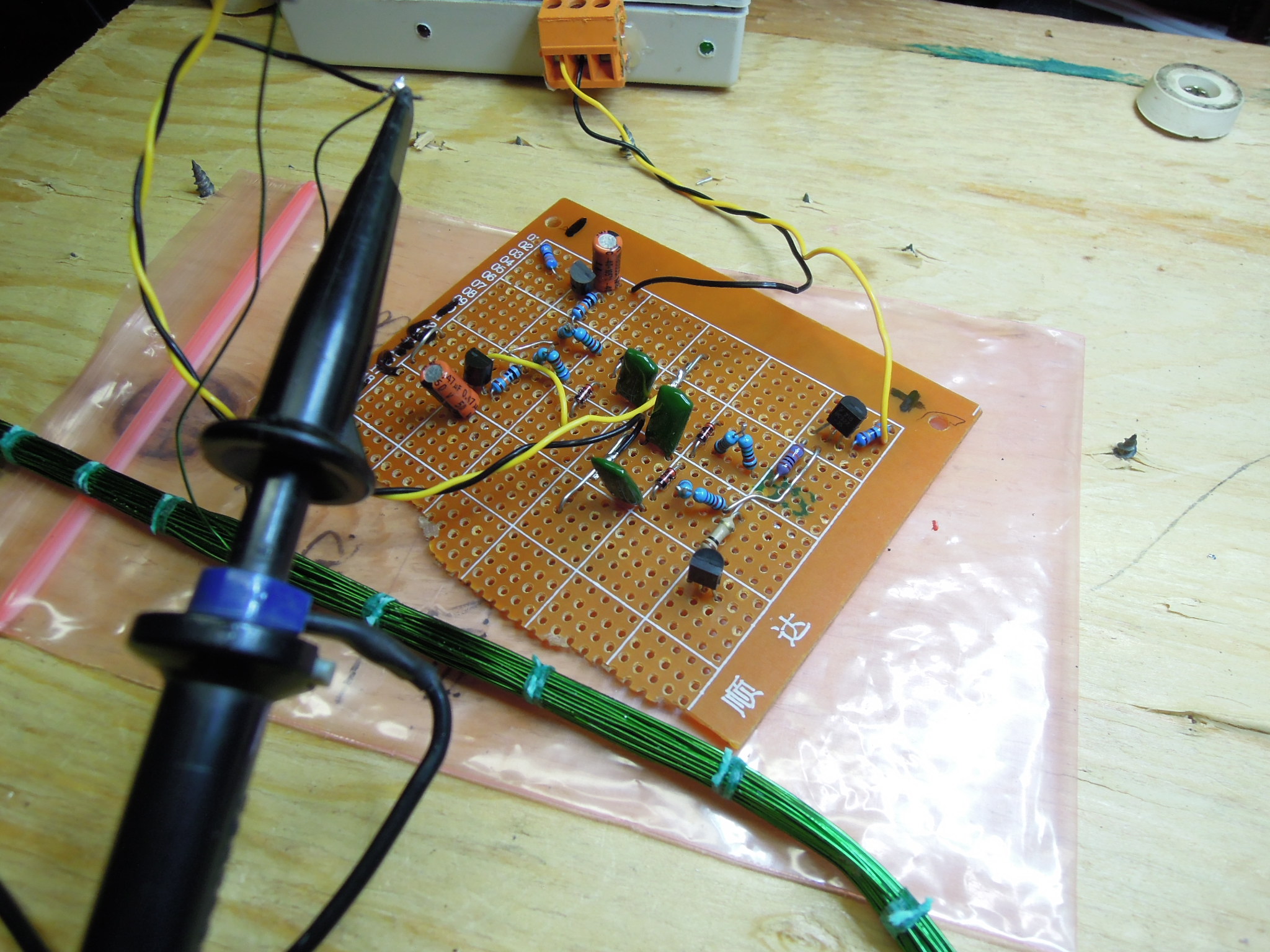

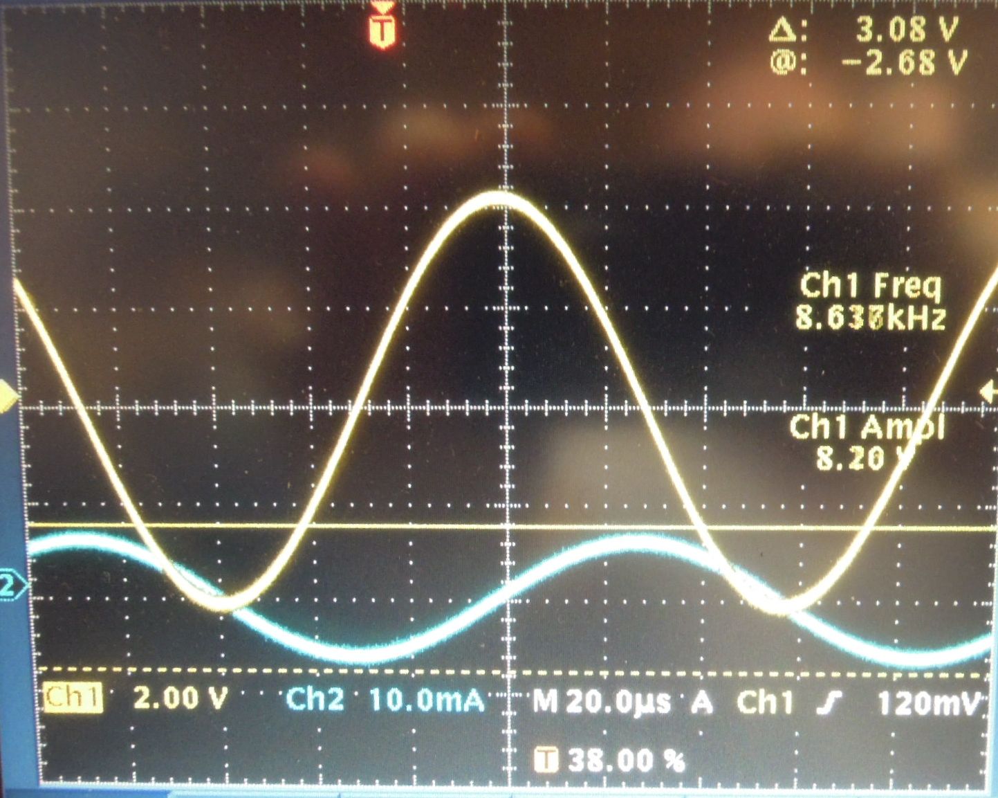

I seem to get different numbers each time I test the H bridge's but they put a lot of current into the
coil and have a nice clean waveform. So I'll use one of them for the finished MD.
Here's the pics of the PCB and O scope display. Channel 2 is a current probe on one wire going to coil but it doesn't
seem to be reading correctly (should be 2ma per mv so 20mv = 40ma? ) . I'll check the current at work tomorrow.
The sine is by probing to one side of the coil and grounding to the other....
Hmm I just noticed I forgot R55 and C2 (for tuning gain), I'll have to add them tomorrow.
