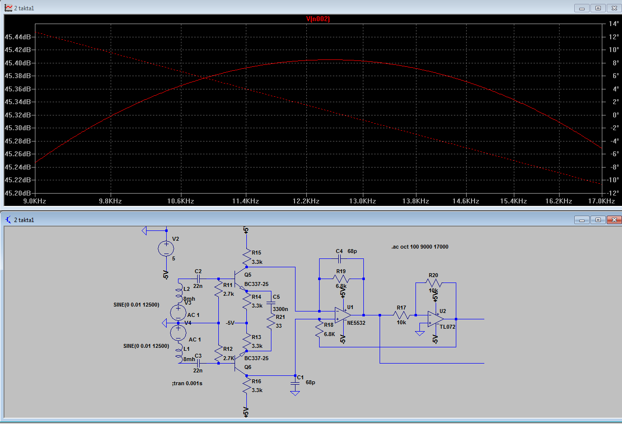

  • C7=470p R15=6k8
    f=1/(2*3.14*C7*R15)=
    =0,16/( 0,00047*0,068 ) =5000 ????
    • As I remember the R15 value was 3k3 before I increased it to 6k8, and obviously I failed to scale C7 and C9. I concluded that the noise improvement was not worth the extra current it required.
      So yes, C7/C9 should be reduced.

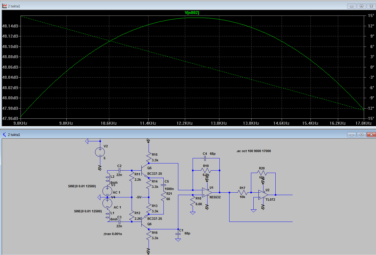

      • Tx=12,5Khz C7=C9=47p C6=C11=47n
        It is impossible to apply such face values of condensers at which a fracture of phase-shift-frequency is near working frequency detector. In strengtheners it is necessary, what the phase of the accepted signal suffered a minimum of changes.
        • Boys, in your chart very much many errors, I see them, but them so many, whatever I even want you about them to tell. If to do a detector on your chart, nothing there super will not be, it will be very badly to work. Count the face values of condensers even

            • Dear Davor, I well see that inductance of Rx does not have parallel resonance, and it very well. But the capacity of condensers of C7 and C9 is small, it is necessary to increase in 2 times, otherwise there will be a change of phase on working frequency of detector. Operating strengtheners are also intortus placed, OP7 must be changed placed with Tl72. Then I yet will write that needs to be corrected.
              • As I said, C7 and C9 are supposed to be reduced, and it will be done in some revision for sure.
                The phase is already taken care of in a way that this configuration will accommodate a wide range of front end phase shifts, so this is not an issue.
                A choice of the front end op amp is almost arbitrary at this point, as long as it provides a good THD, because the most of the voltage gain, and the noise performance, is handled by transistors. Every op amp with input voltage noise less than ~30nV/sqrt(Hz) wil do fine, provided it does not ruin the signal by intermodulation distortion. Most of the opamps share the same pinout, so replacing the opamp is easy.

                          I counted the face values of condensers, it must provide a zero phase of the accepted signal on working frequency of detector
                          • More or less, yes. My whole idea of this configuration is providing the front end that can accept frequencies within an octave of frequencies with no difficult re-tuning. Some phase deviation in both directions is acceptable, as the phase shifting network compensates this deviation prior to extracting phases for discrimination etc.
                            So the idea is to set a coil/frequency and first tune the ferrite reference. Once it is tuned by a piece of ferrite, the rest of controls are set at virtually the same positions as for the previous coil/frequency.
