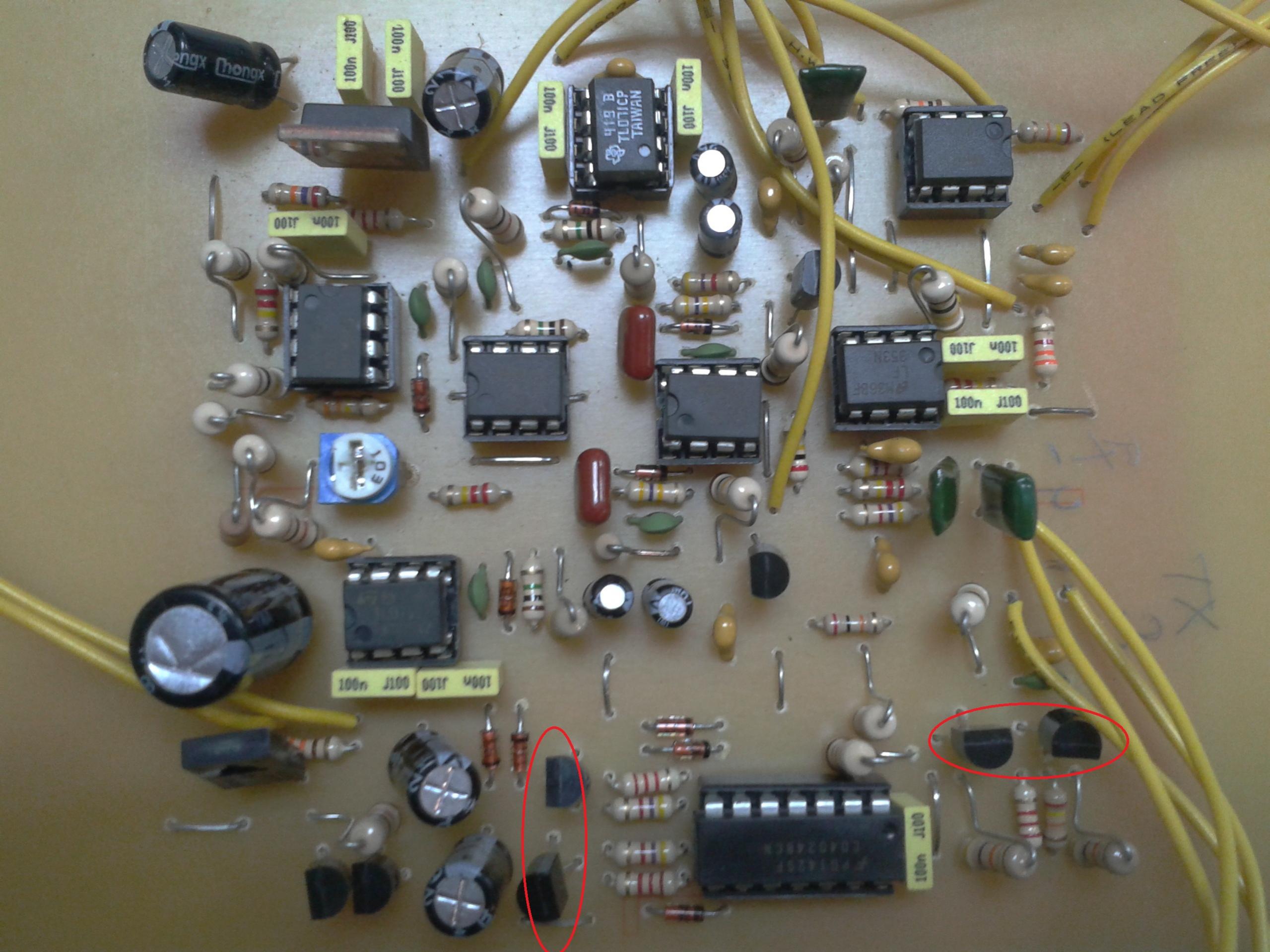

ID:	338037 i found out 2n2222 and 2907 was in reverse . I am not sure if anything else is in reverse. bf 247 is it ok?

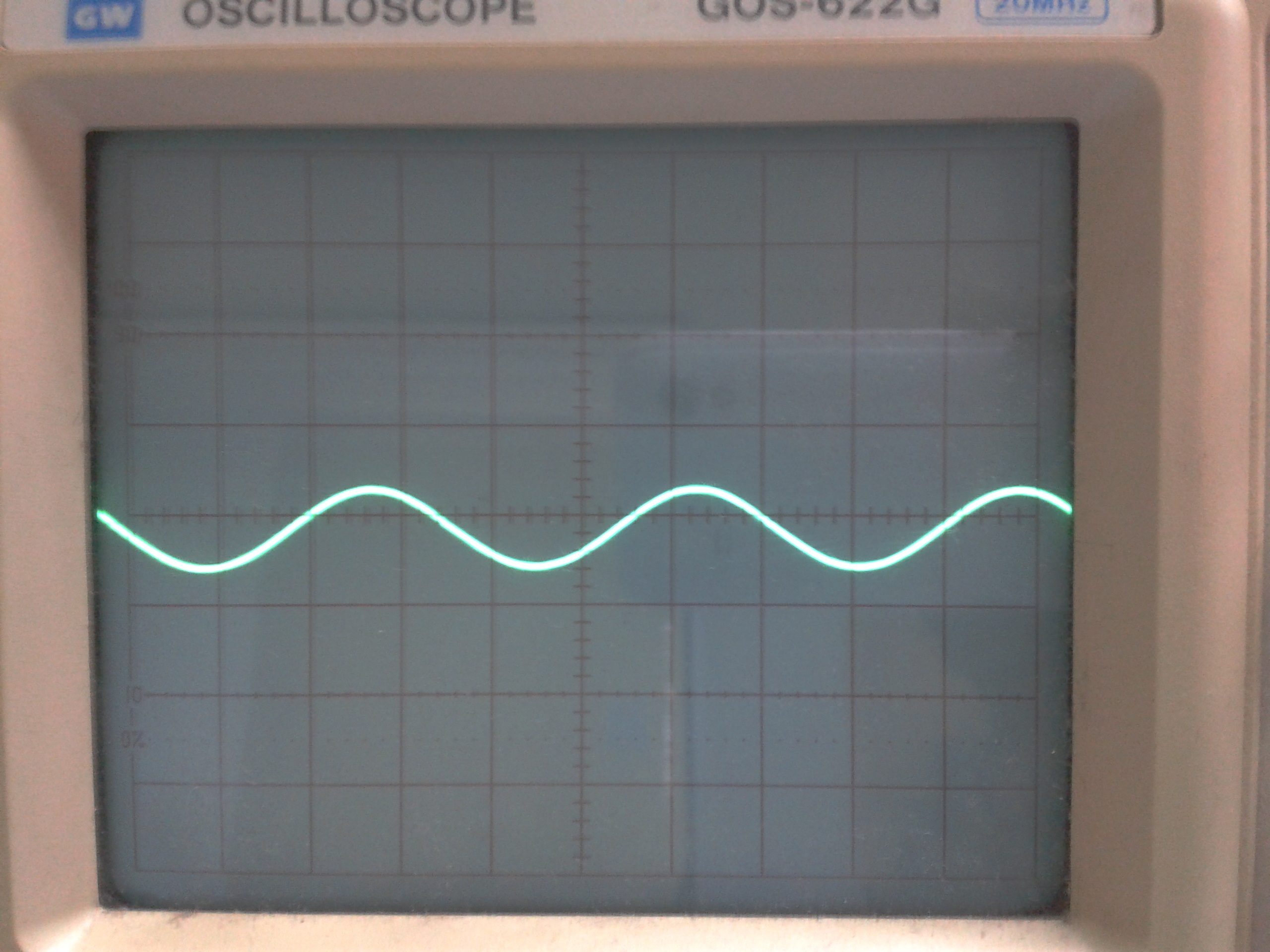

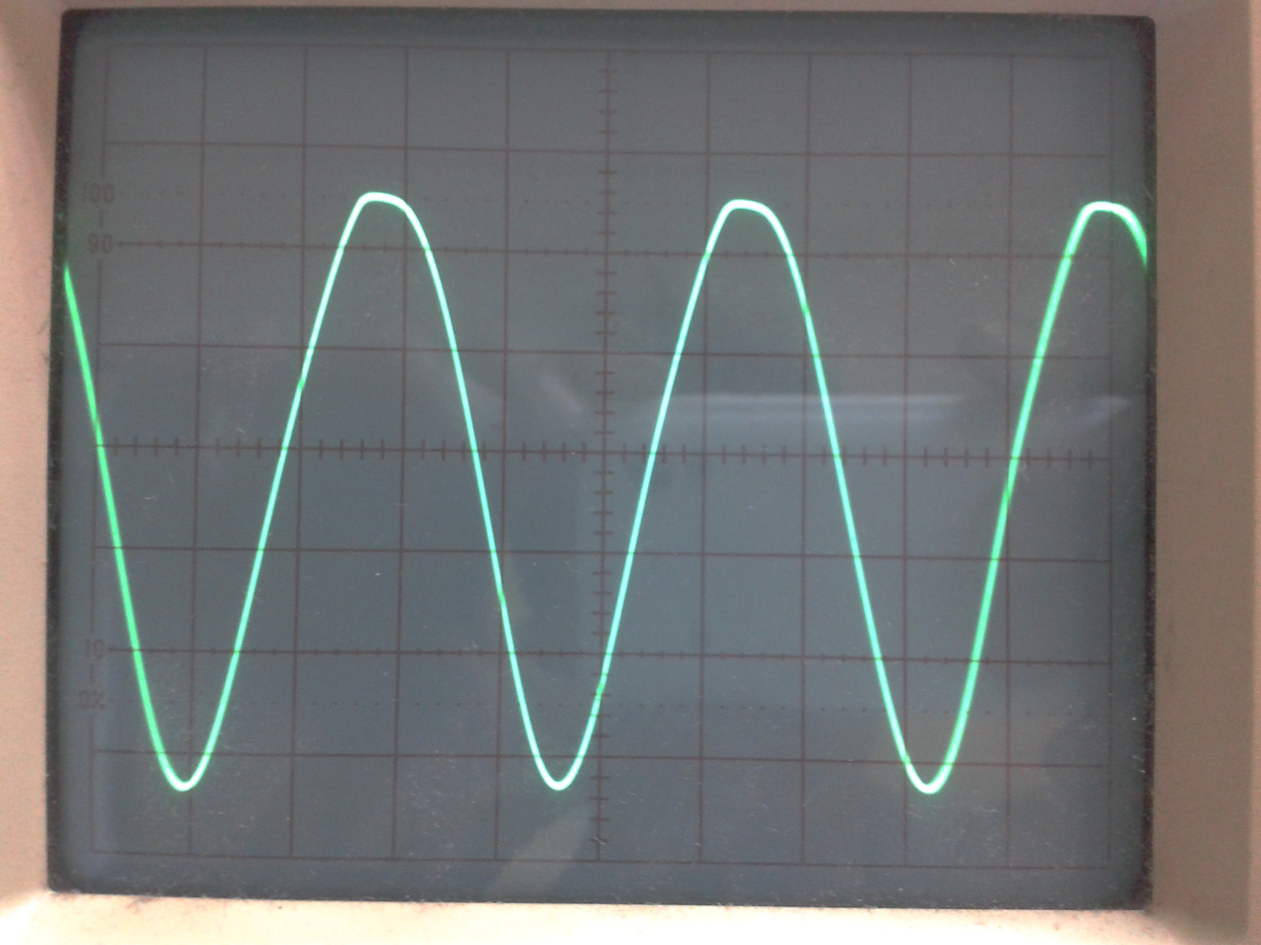

        tx and rx output v/div set at 2v t/v 20usClick image for larger version
ID:	338038Click image for larger version
          does anyone have any idea why i got so poor detection?

              [ATTACH]26767[/ATTACH] i found out 2n2222 and 2907 was in reverse . I am not sure if anything else is in reverse. bf 247 is it ok?
              Sukri01
              would you mind telling me why the 2n2222 and 2907 were reversed, just trying to find out why that happened ?

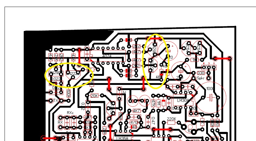

                components placement and ic pin out are not same. i have to reverse the position then i got sound, and oscilation.Click image for larger version
Name:	ic reverse.jpg

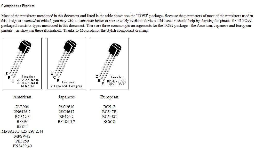

                  Hi Sukri01, thanks for reply
                  thats a problem with TO-92 pinout,
                  I am tempted to write a simple tutorial about the problem
                  • There is no standard pinout for the TO-92. The American BJT's use the E-B-C pinout while their Japanese counterparts use the E-C-B pinout and some RF devices use the B-E-C pinout.
                  This quote is so true
                  More often than not, however, the disadvantages concerning accidental destruction are greatly outweighed by the small size and low cost of producing TO92 cases.
                    Yes those pinouts can get you. I found this drawing in one of the other threads around here;
