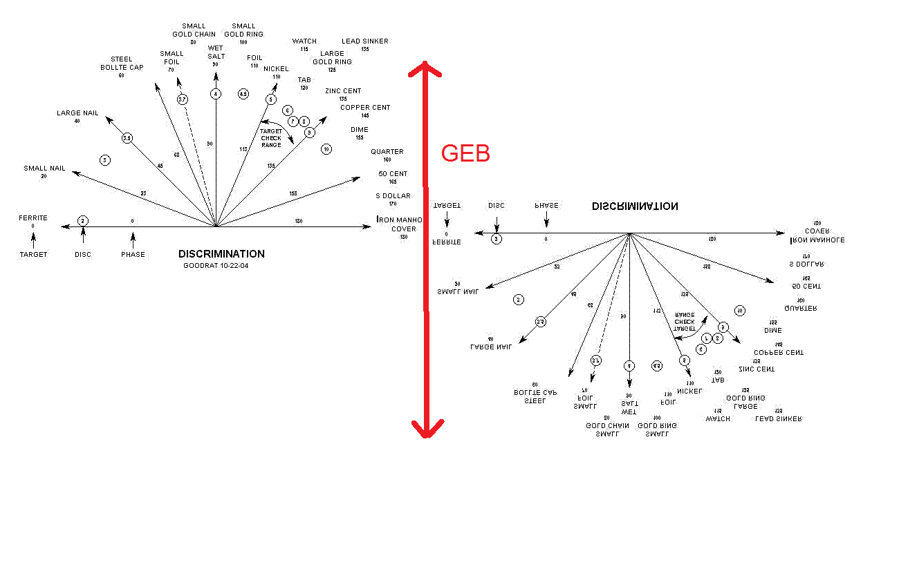

        So the GEB starts at 90 and goes to 270? OK but where is the Disc? It has to overlay the GEB to produce a sound...
        Maybe the problem is the discriminate chart shows ferite at 0 and salt at 90 and most coins from 90 to 180, I imagine the
        targets are also 180 from those locations, so ferrite is at 0 and 180 and salt is at 90 and 270 so the disc can run around the other
        side?
          Like this?

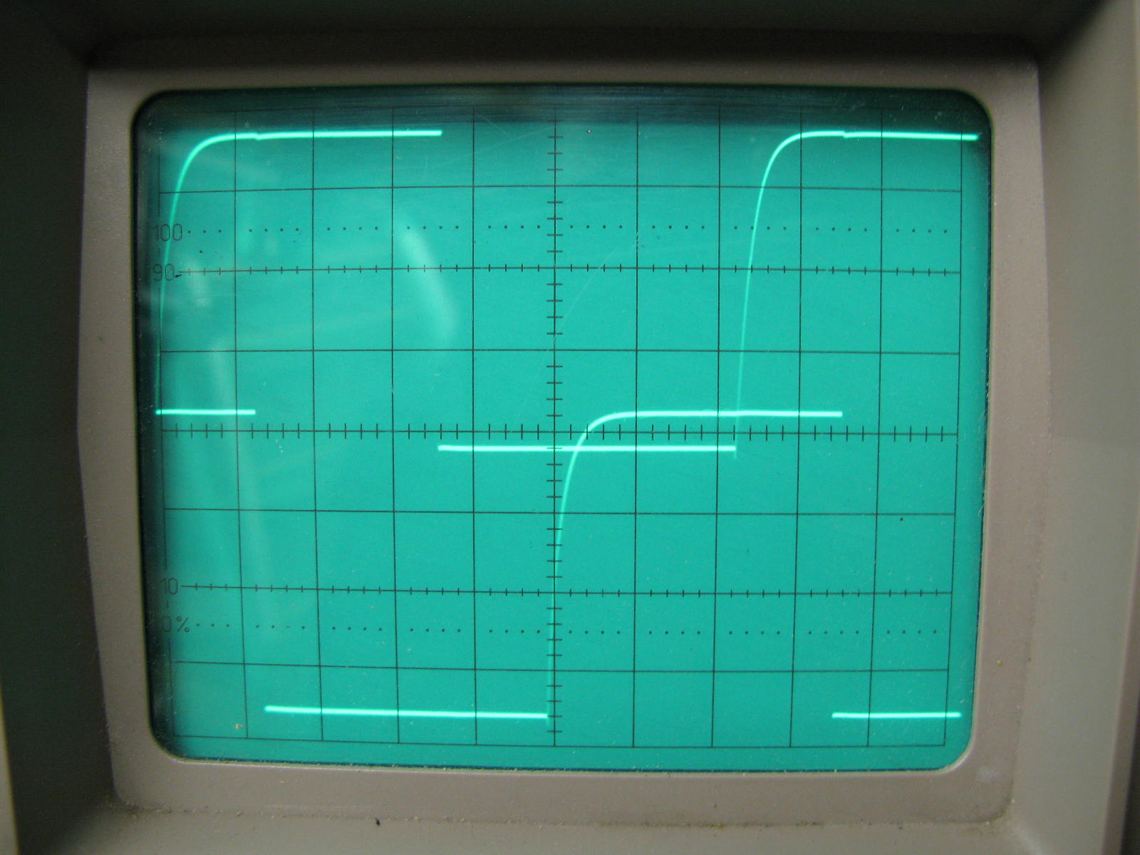

            Well I wasn't sure my signals were correct but these pics come from my board. I was mistakenly thinking
            the GEB and Disc had to be in the same position for the MD to output a tone but actually the signal is converted
            to a DC level then the cap holds the sample for a bit so I guess these are correct?

                ... I imagine the targets are also 180 from those locations, so ferrite is at 0 and 180 and salt is at 90 and 270 so the disc can run around the other side?
                That's precisely what happens with target signals going to counter-phase, and that's the reason I'm after 4-quadrant discrimination solution. For 2-quadrant you need AND function, while in 4-quadrant you need XNOR function, or some other clever approach.

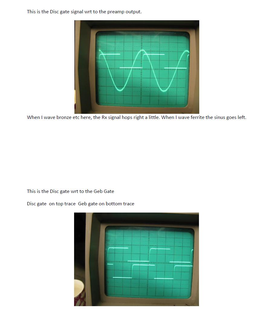

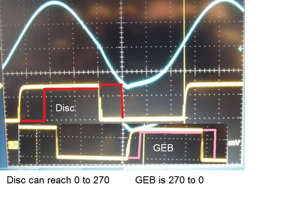

                  So I'm guessing we are trying to get a sample of the waveform that is equal parts above zero and below to balance to 0v? As I understand it.. This way you eradicate a single signal phase - that of the ground ( the soil it has to be uniform consistency to work properly )
                  So the GEB starts at 90 and goes to 270? That the general rule... OK but where is the Disc? It has to overlay the GEB to produce a sound... The Discc gate is later - It needs to sample phase ****ed signals that are correspondingly late.. You need the two Rx channels to be able to Rx target energy at the same time to trip the common reference on the comparator stage so there is some overlap or they wouldn't work. You would need a short duration sample and hold on the Geb CH if they were split up too much.. So the early result was still available for the Disc CH to tally with. Click image for larger version
ID:	338178 This is taken from my IDX - shows the time split between the 2 channels. This picture is from a 250 I have.. Click image for larger version
ID:	338179 again shows the split - this maybe a hint different as although similar architecture it does not have the comparator AND function it has A/Ds AND sw backend S
                    Works the same. In a 360° circle, GEB channel will have two zeros on the opposite sides, splitting the circle in two halves. Targets appearing in one half will have a positive response, while the other half negative. Same goes with Disc. The area where both GEB and Disc are positive is passed through (AND), while in case of 4-quadrant discrimination also the area where both are negative passes through (XNOR). Analogue or digital - works the same.
