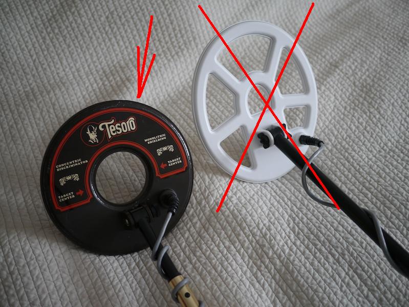

The Silver uMax coil should work on the Eldorado. You can easily check this by looking at the coil plug, which will either be 4-pin or 5-pin. They have different inductance values for the TX and RX coils. I think the coils you mentioned are both 4-pin types.Originally posted by aothunterpl View PostHi all
I have a question, probably trivial
Is coil concentric coil (8") with the Tesoro Silver Umax will fit to Tesoro Eldorado ?
The frekfrency operating is thesame 10kHz
Thanks for the answer
Regards.
However, you may need to adjust the ground balance for optimum performance.
