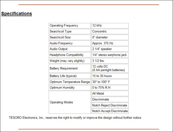

    Happy Easter and everything you want. I have a question I've read on the forum that works at 15kHz TGS but I found the manufacturer's website specs and it says 12kHz, paote someone explain to me, thanks in advance all the best...
    Not sure what freq the real MD's Tesoro is selling operate at as their ads are sometimes wrong.

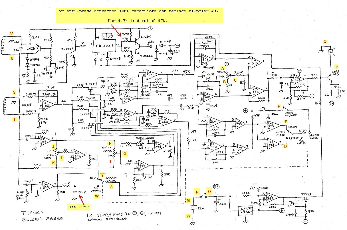

    The .22 and .022 caps in the TX oscillator resonate with the 5.9 mh TX coil to give 14.651 khz.
    Other Tesoro's use .33 and .033 to give 11.963 khz...
