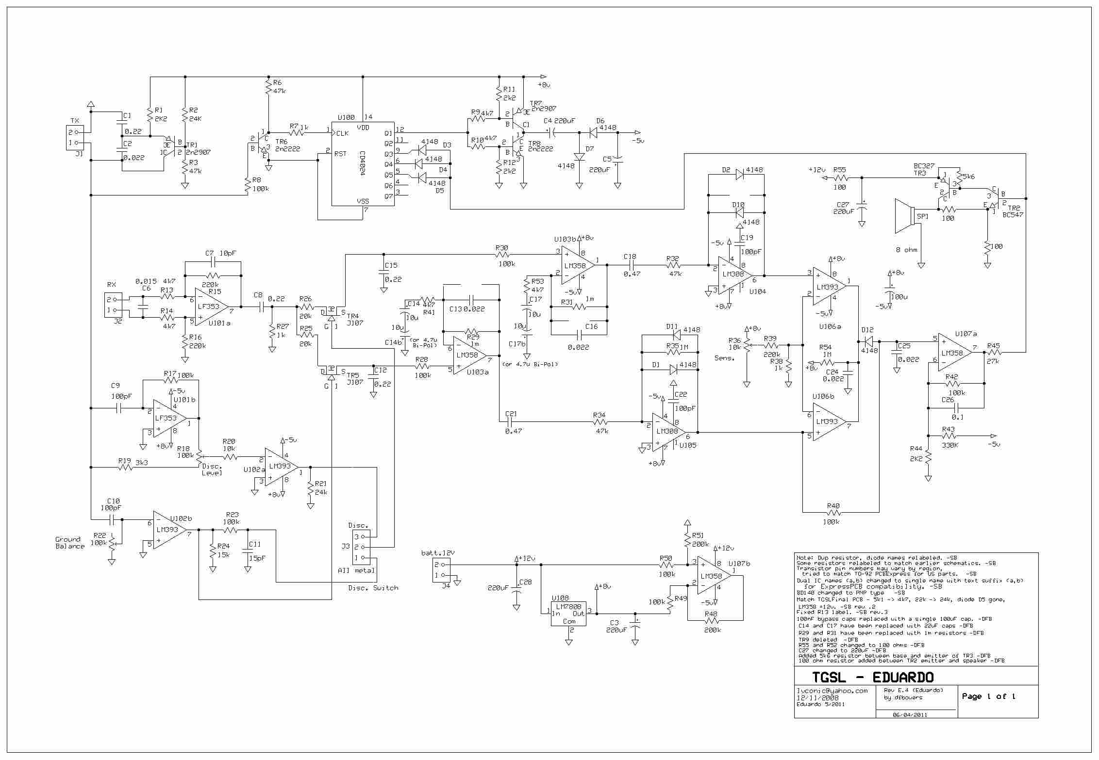

    For those that missed it here is a mod to TGSL EDU to allow a bit more gain and cleaner output.
    Remove D8, D9, C20, C23, R33 and put diodes at C20 and C23 reversed from D10 and D11
    and change R29 and R31 to 1 meg.
    Thank Davor as he created this mod on the IGSL.

            This mod significantly improves impulse response of the filtering, and provides compression to better cope with strong signals. Target response becomes faster and snappier as the filters never get into saturation, while the difference between the shallow and the deep target becomes softer and more natural for your ears. It works wonders for many targets in a row as you can hear every each one of them.
            It does not provide any EMI advantage apart from making such offending pulses last shorter.
            As for EMI, TGSL has a poor design of a front end. It can be improved, but not by much. So far I did not do anything about it because I did not need any better.
            I played a bit with the input configuration to reduce noise, and I can recommend a simple upgrade: replace the LF353 with NJM2068. It has 1/4 of Lf353 noise voltage and 1/10 of THD at economy class price. With NJM2068 the remaining dominant noise sources are R13 and R14, and you can stop there. To go lower with noise you can replace those with down to 1k, but in that case the phases get affected and it becomes a little more complicated - nothing to worry about if you can reach GB solution with R22. It gives some extra 5cm or so. It works for my IGSL, but I had to compensate for GB.

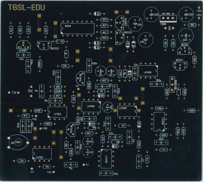

                            Is this Mod Good for the TGSL-EDU black board? If so, can you use the photo below and circle what needs to go and be changed please ? Thank you
                              It increases the gain and makes the last filter stage faster, try it. Basically they are the same circuit.
