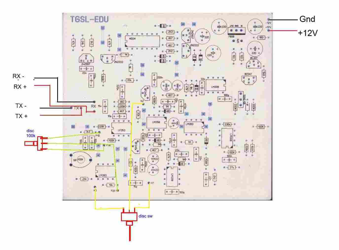

    Hello anybody can help me how to connect potentiometer's to TGSL-EDU bOARD,
    and switch for Ground balance, sensitive, and volume and where connect switch please can you mark for me on the board picture ?

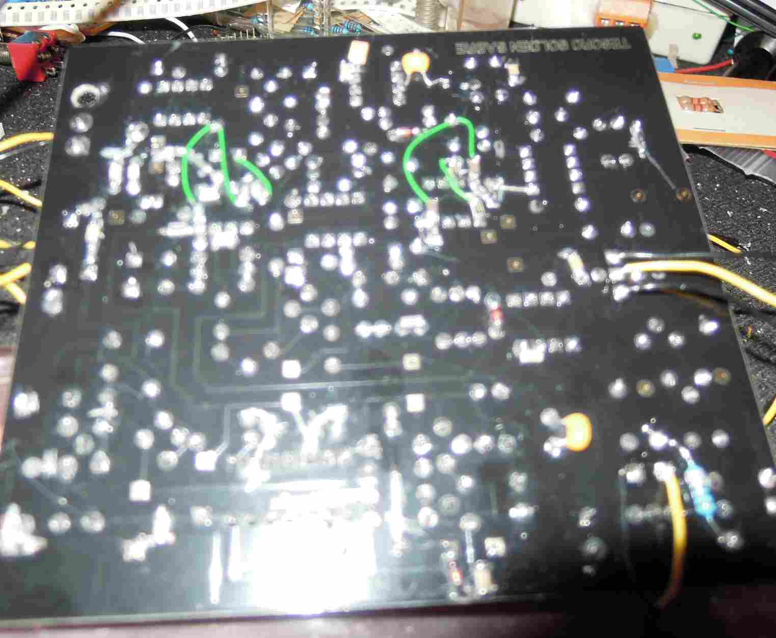

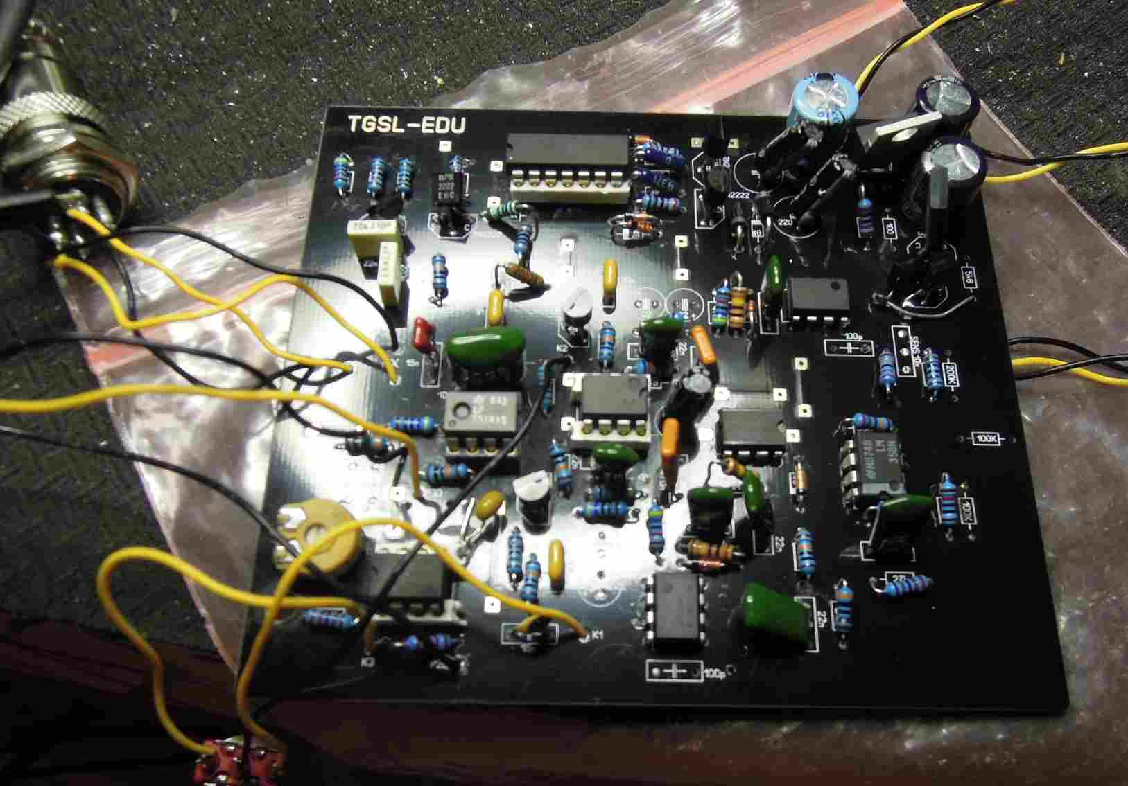

    anybody have picture of the Silverdog board soldered ? front and back side pls ?
      Here's the pot wiring;
        The board pictures are tougher but here's a try;
          thanks mate

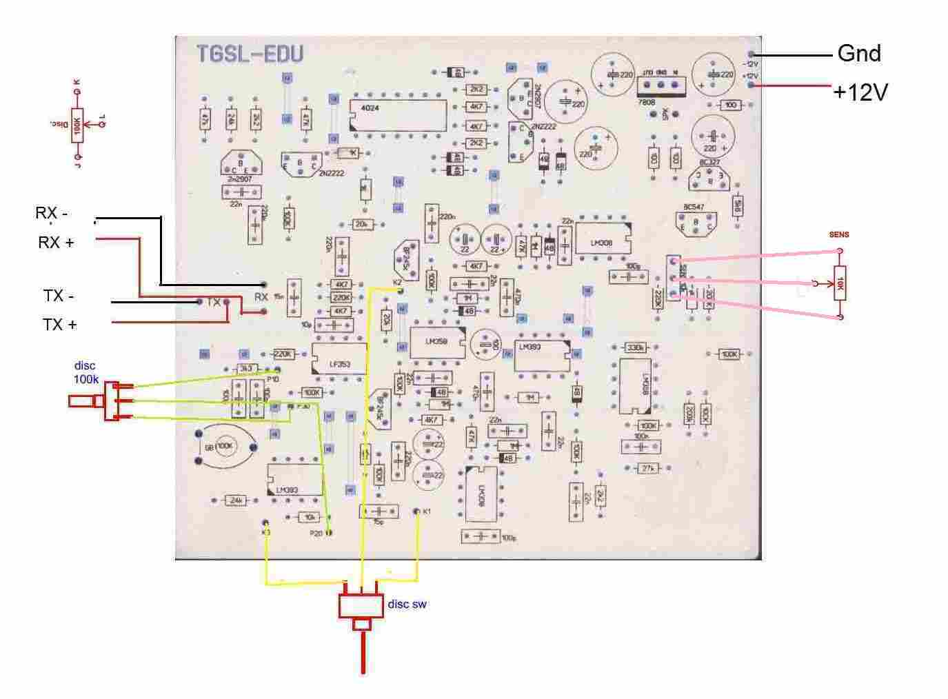

            Oops I forgot the Sens pot. I'm surprised no one had ever drawn this for the Silverdog board...
              Where does the j,k,l,disc in the upper left part of the diagram go?
                I only have two Pots and one switch. And i can see ceramic capacitors at the back side of silverdollars picture.
                And wires. Do i need them? Is it better to add two more external pots for GB and Sens?
