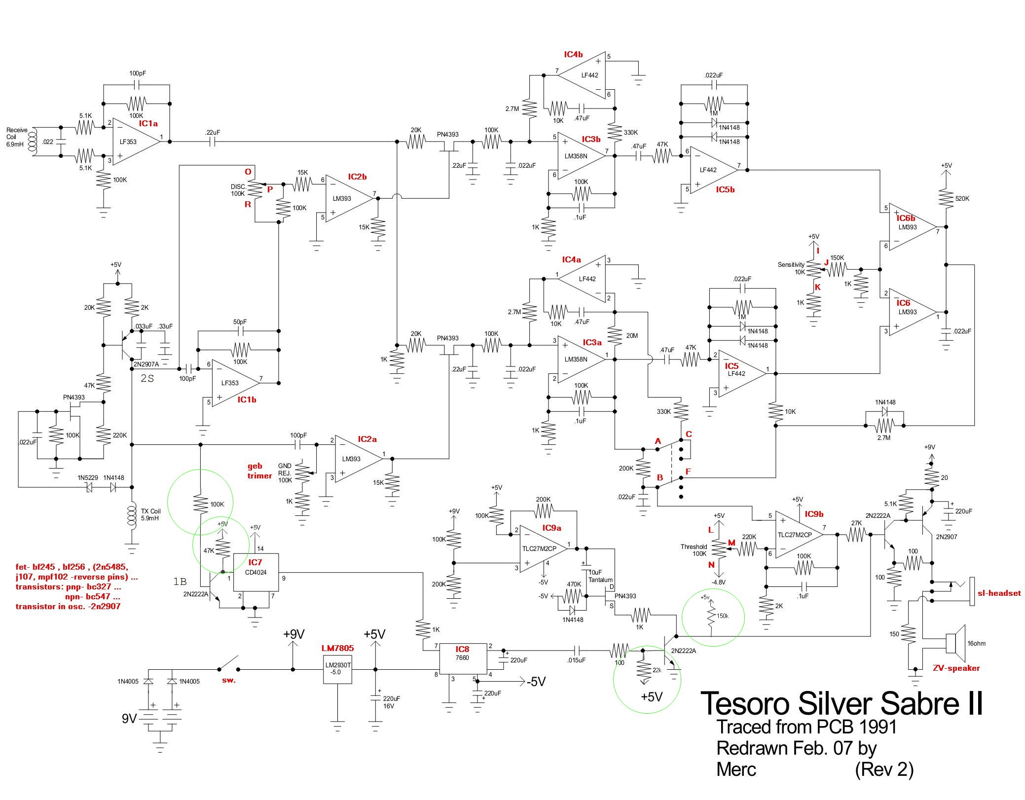

    My humble contribution to this great forum.Regards to all !

              I guess there are no errors in pcb...
                The plate was twice checked and no errors. I have not yet made the plate but I expect to have a decent performance in the range of other Tesoro detectors.
                  This scheme is incorrect, do not recommend anyone to work according to her.I found some errors
                  while I compared from the picture.
                    What errors are in the schematic? I drew it sometime ago but I still have my Silver Sabre II to compare with. What is incorrect?
                    Merc
                      So far I have taught these mistakes that are framed:

                      I'm glad you want to help me with this project,thank you in advance!
                        I have compared to my Silver Sabre 2 and you are correct. I made mistakes. I apologize. If there is anything else in question just let me know and I will check on my detector.
