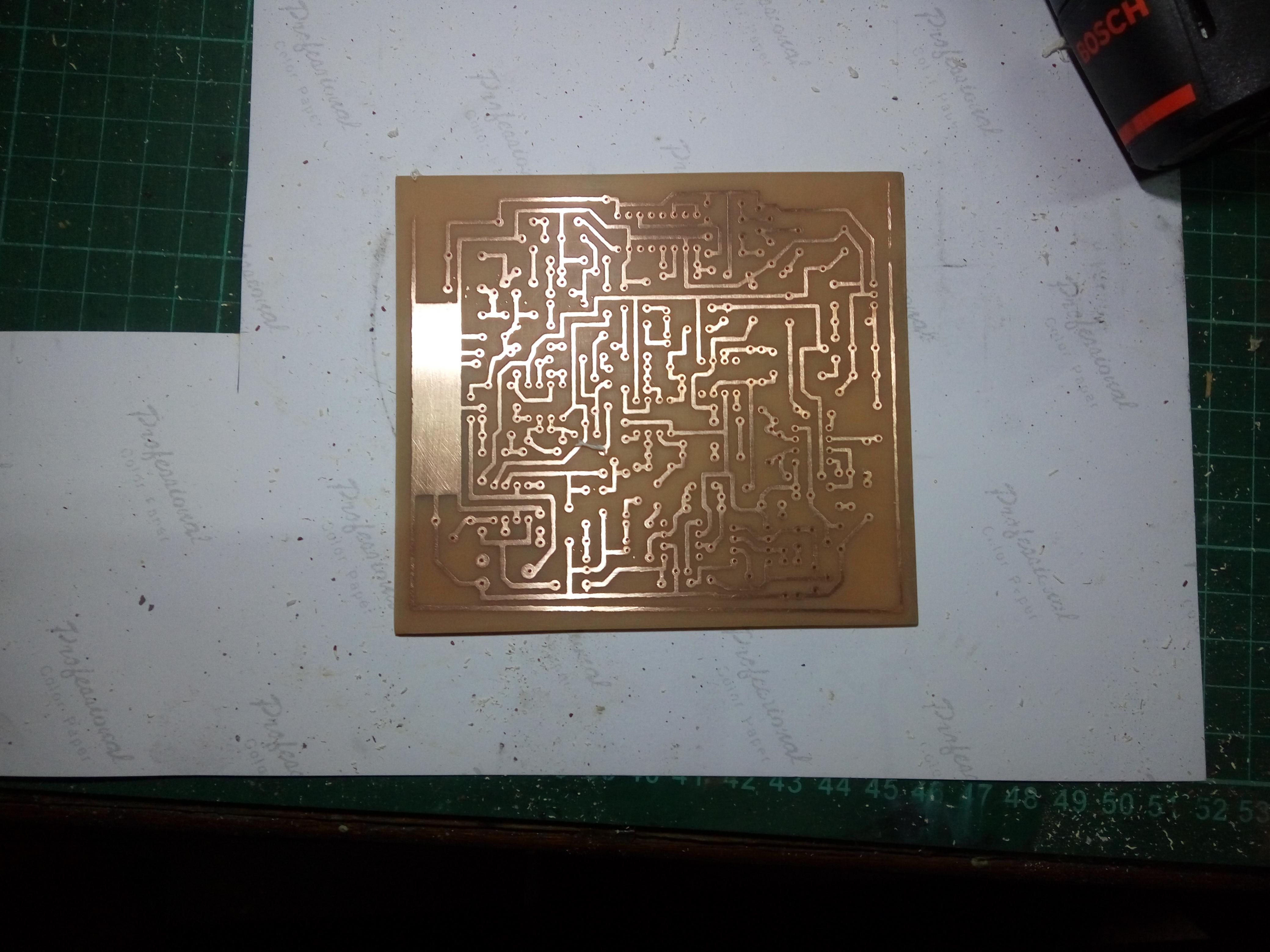

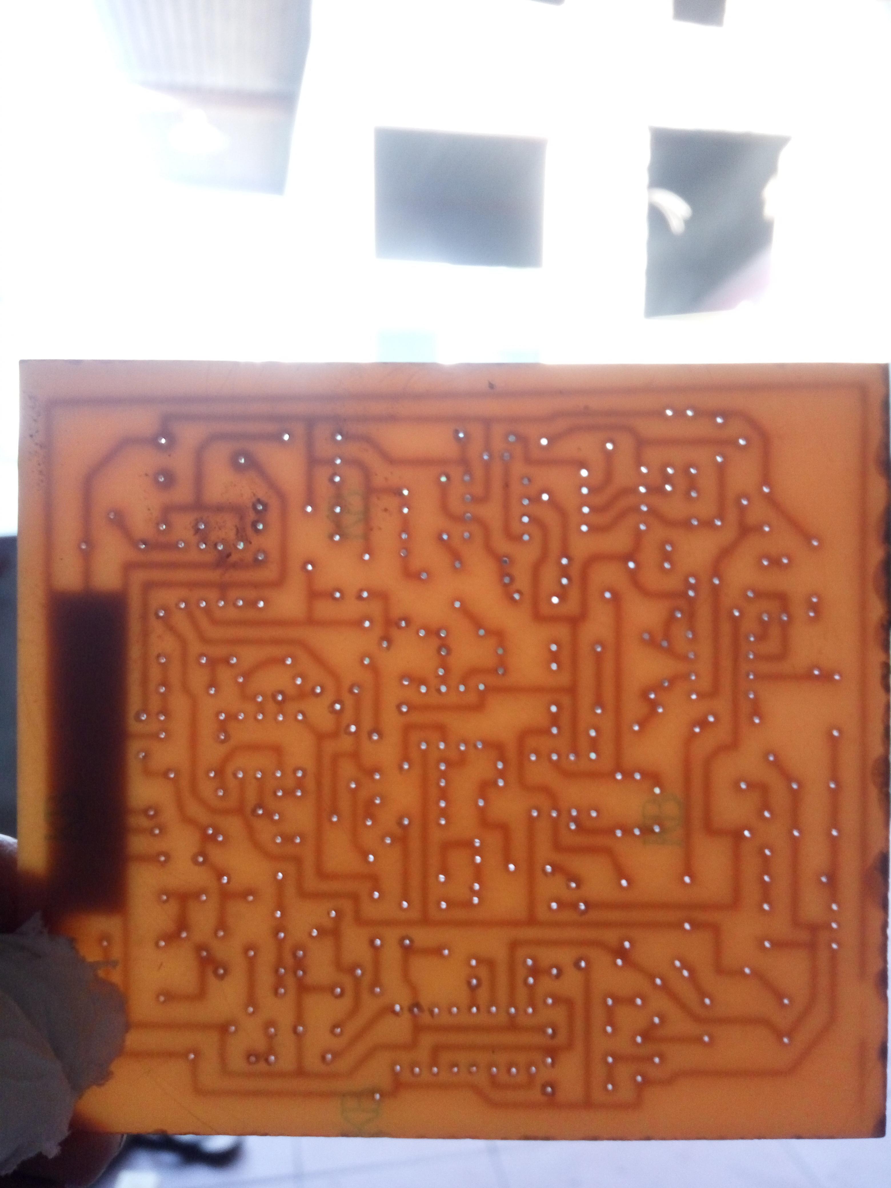

            PCB finish

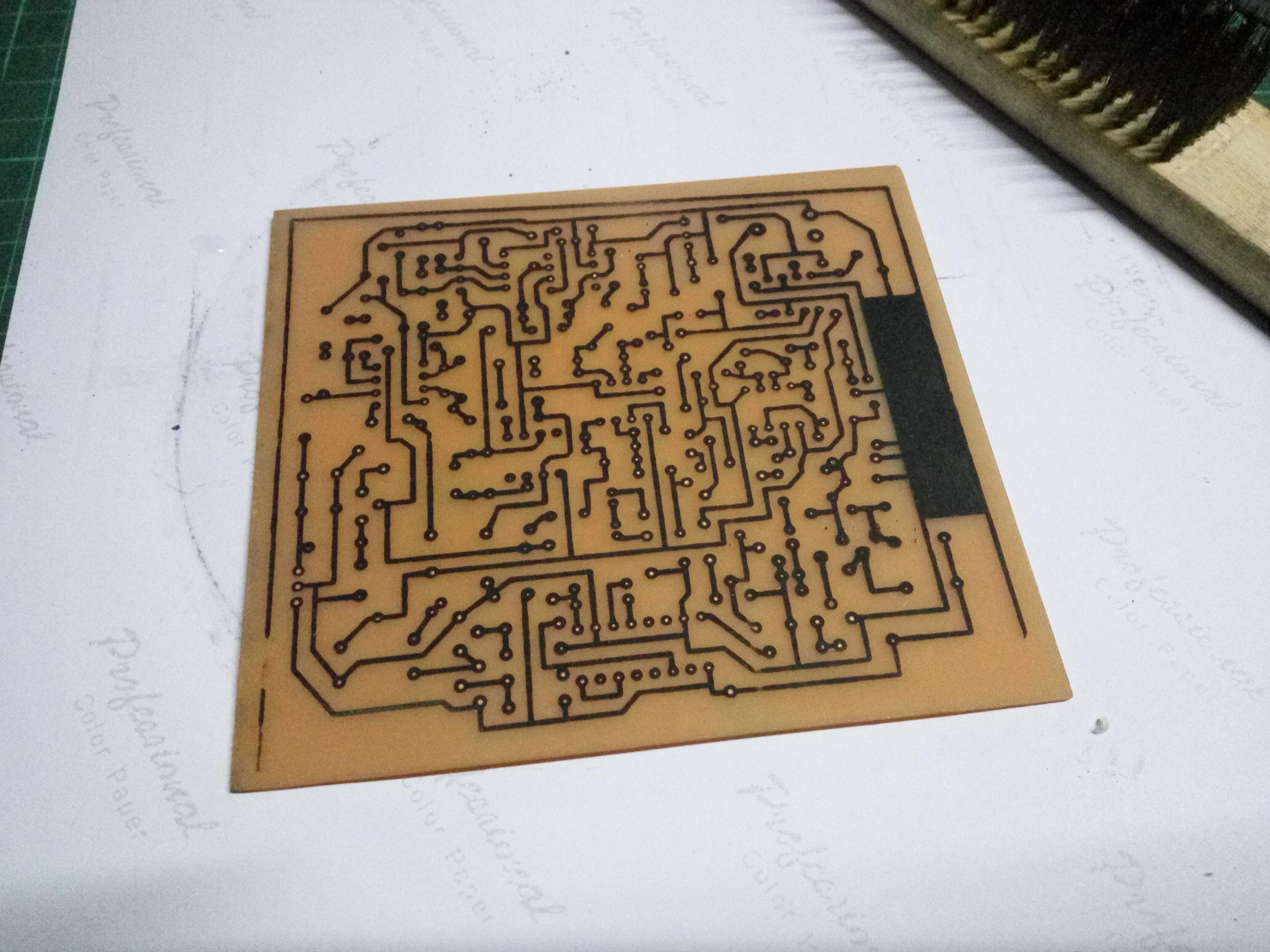

              MY MISTAKE.....AGAIN!
              Wrong pcb print, ivconic file is already ready to print
              3 hours wasted

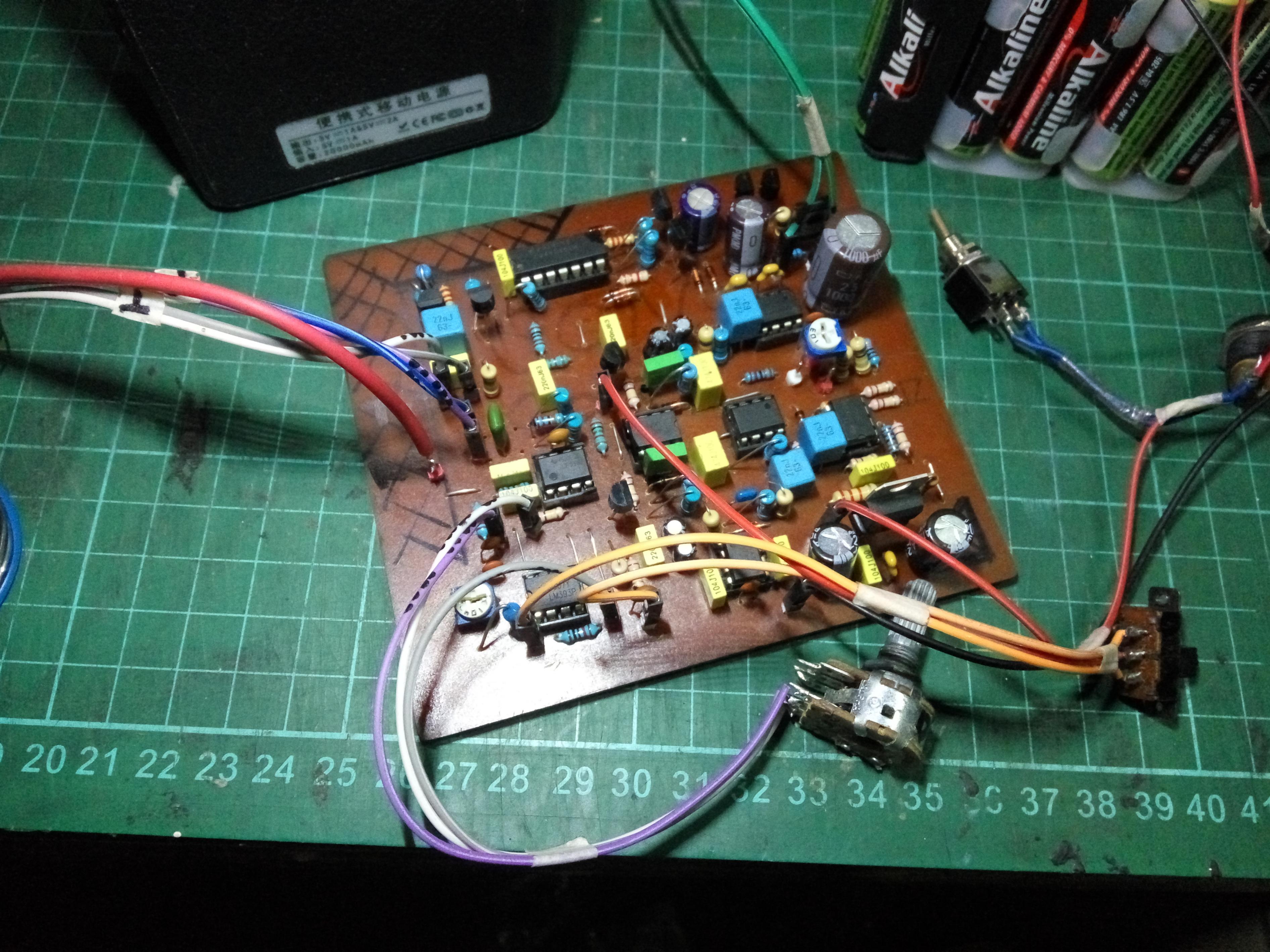

                  Ok... lets test
                  V.3
                    Not working...... reverse all 2N transiator and work, but weak continous beep. Already put coil.
                    Ehh....i change 2N2907 with 2N3904...
                      Someone please take a look, dont have more clue for now
                      https://youtu.be/_mAOCKOO8Cw
                        Pin 4 UA741 (LM308 ) +0.76, why i can get minus
                        Like first time ivconic build trouble...
                          Make clear photos and post, and make photo of BD140, i cant see orientation from video.
                          In version 3.0 u must have no sound without connected coil.
                            For 2N2907 u cannot use 2N3904.
                            2N2222 = 2N3904
                            2N2907 = 2N3906
                              I already use 2N2907 like the scheme, still long beep like there is no coil attach, try another 3 coil, same reaction.
