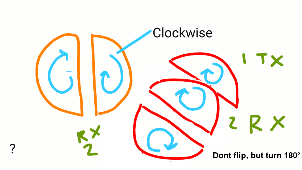

        • What about coil spec's? Diameter, inductance, resistance, wire? On my 3.0 version i'm using standard parameteres: 6 and 6.5 mh, wire is 0.27. Resistance about 22 - 23 ohm's. Size is 27 cm.
          • I have for my TGSL/Bandido coil
            TX 6,0 mH, 20 Ohm, 99 turns 0,3mm
            RX 6,5 mH, 21 Ohm, 104 turns 0,3 mm
            DD27
            but not sure about wire diameter
            • That's it. Almost the same.

                • @ ripsdevala.
                  • Originally posted by chevesne View Post
                    @ ripsdevala.
                    [ATTACH]36911[/ATTACH]
                    Nothing change, still at 15cm

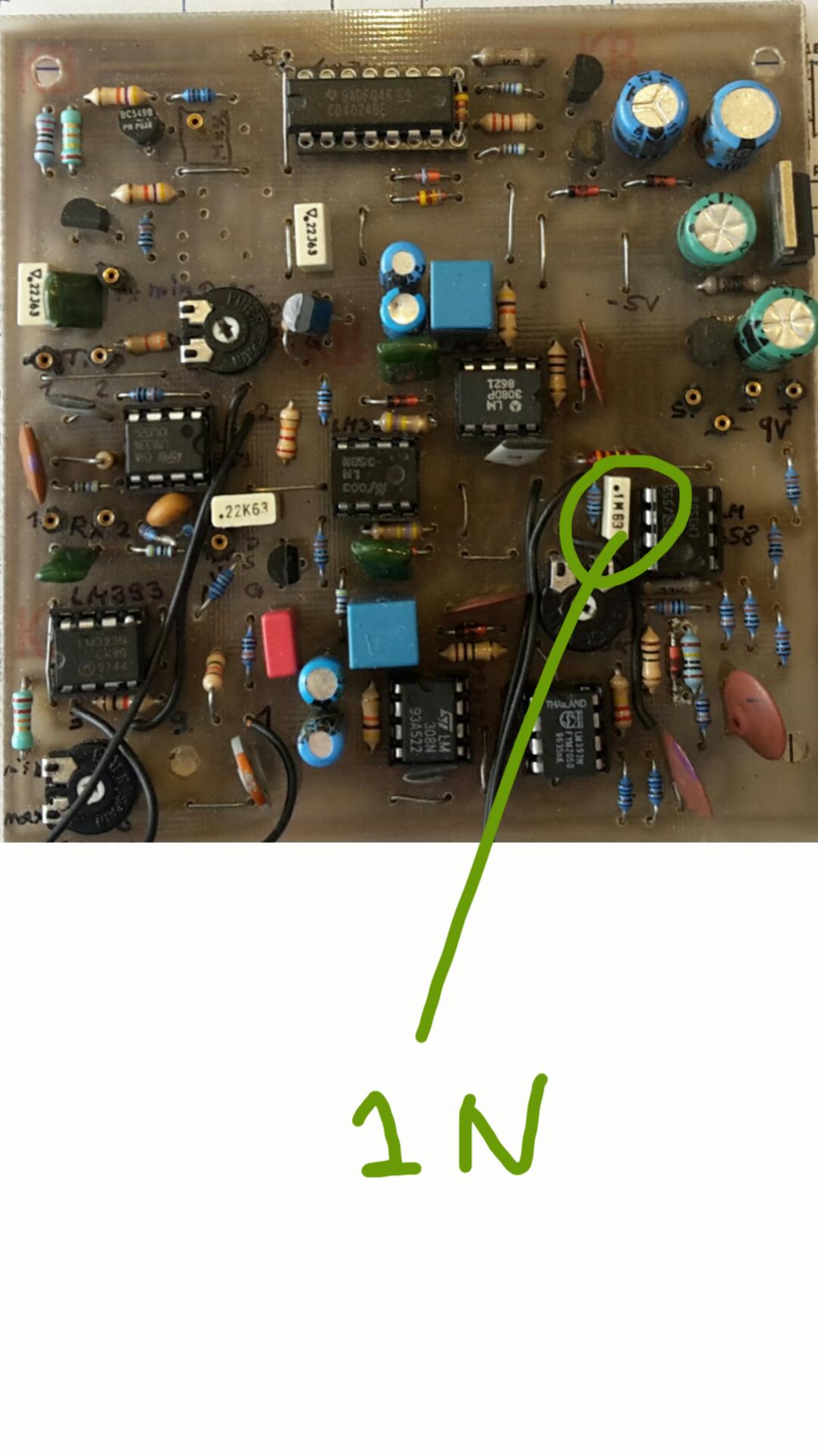

                    • Blobber, is this a mod? 1N caps
                      • No, it is 100 nF.

                              • As I already said, I change the connection until I get the best result. So I am not sure.
                                I think you have changed it already, right? When you get your oscilloscope, you will watch for the right wave form pin 7 of LF353 and TX/RX relationship in phase.
